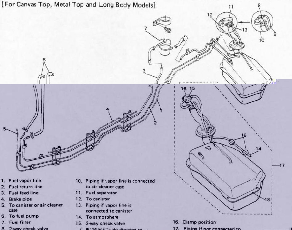

in your diagram why is the return going through the filter, or has it got tangled behind the arrow?

- fuel circuit SJ.JPG (110.39 KiB) Viewed 6545 times

I would turn your fuel filter by the tank around the other way, it won't make any odds to running but you can see how much crap is building up on the filter and therefore when it needs replacing. Normally they have an arrow pointing this way

ah right mines the wrong way round then but its not stopping fuel getting up to the front.

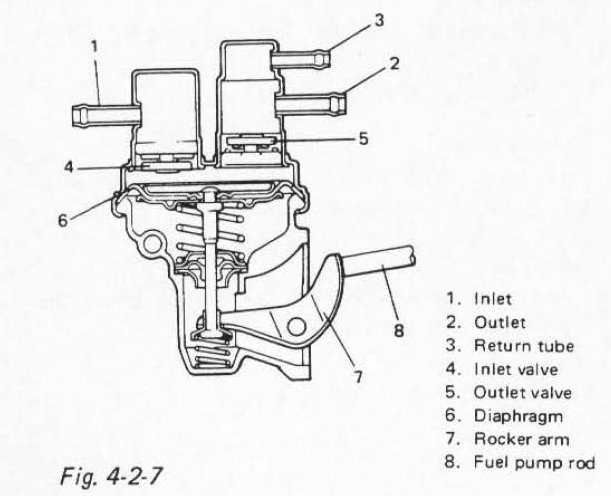

What i had done when i put the filter was put A into the incomming part of the filter, and B out of the filter.
C whatever its for was the key to getting it going it wasnt connected to the filter, but when i put the pump back on (without bolting it up) the anus just started.
And my blanking plate arrived:
seems very good quality, but i havent put it on yet.
So i need advice on the plumbing, in theory i could put the pump on over the blanking plate and put the pipes on as normal, but i just dont like the idea of that, it was the thing giving me trouble so i just for the sake of it want rid of it im afraid it might leak, but also would like a bit of free space. What is going on between B and C is there petrol going to both in a certain way? how could i replicate this without the pump there.

Sounds like you've been pumping fuel round in a circle. A = inlet. B = Fuel return to tank. C = Carb.
Filter inlet wants to be on A
Filter outlet wants to be on C
Hose for B can be capped/blocked off.
The pump should have its own internal valve to keep the fuel pressure at a constant level and so doesn't need a fuel return pipe.
- fuel pump.JPG (41.24 KiB) Viewed 6505 times
Re: Changed the fuel pump but theres something wrong
ah i see, good stuff so its A onto C and block B off.
Problem is B uses a really small pipe im going to have to get a length of fuel pipe

Smalljeep wrote:ah i see, good stuff so its A onto C and block B off.
B - small pipe
Let me have another go...........
Remove old mechanical pump altogether.
Connect the pipe that went on to A ------ To the filter inlet side.
Connect the pipe that went on to C ------ To the filter outlet side (small pipe).
Block off the pipe that went on to B ------ Fuel return.
