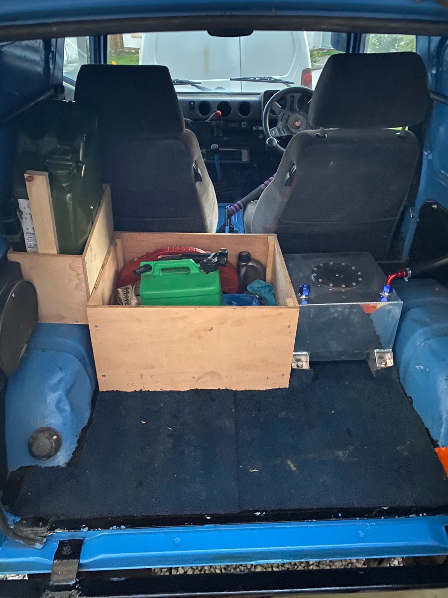

Right I’m a back where do I start the Suzuki sj has mot finally I know but I gave up on her a while back when I couldn’t get it into gear so I’ve finally fixed the problem which was a fly wheel bolt snapped a jammed in between the clutch plate and flywheel meaning yes new clutch even tho the old one only done only 20 miles :hahaha: so I’ve done a few changes since my last post removed the rear light that was in the bumper to leds as the old ones was made from land :tosser: (rover) also had to ditch the old fuel tank as the fuel filter kept blocking up with rust ect and had a small leak so ive gone for a aluminium tank only holds 20liters but that’s plenty for what I use it for anyway also will be finishing off the rollcage then I need to make the back 2-3 inches higher as currently is sitting a bit low at the back was thinking spoa conversion on the back ? :er:

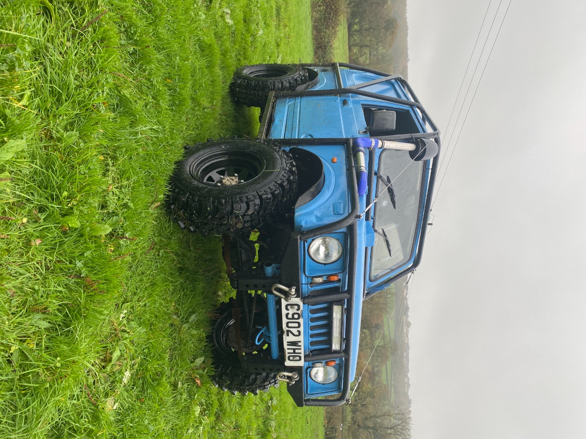

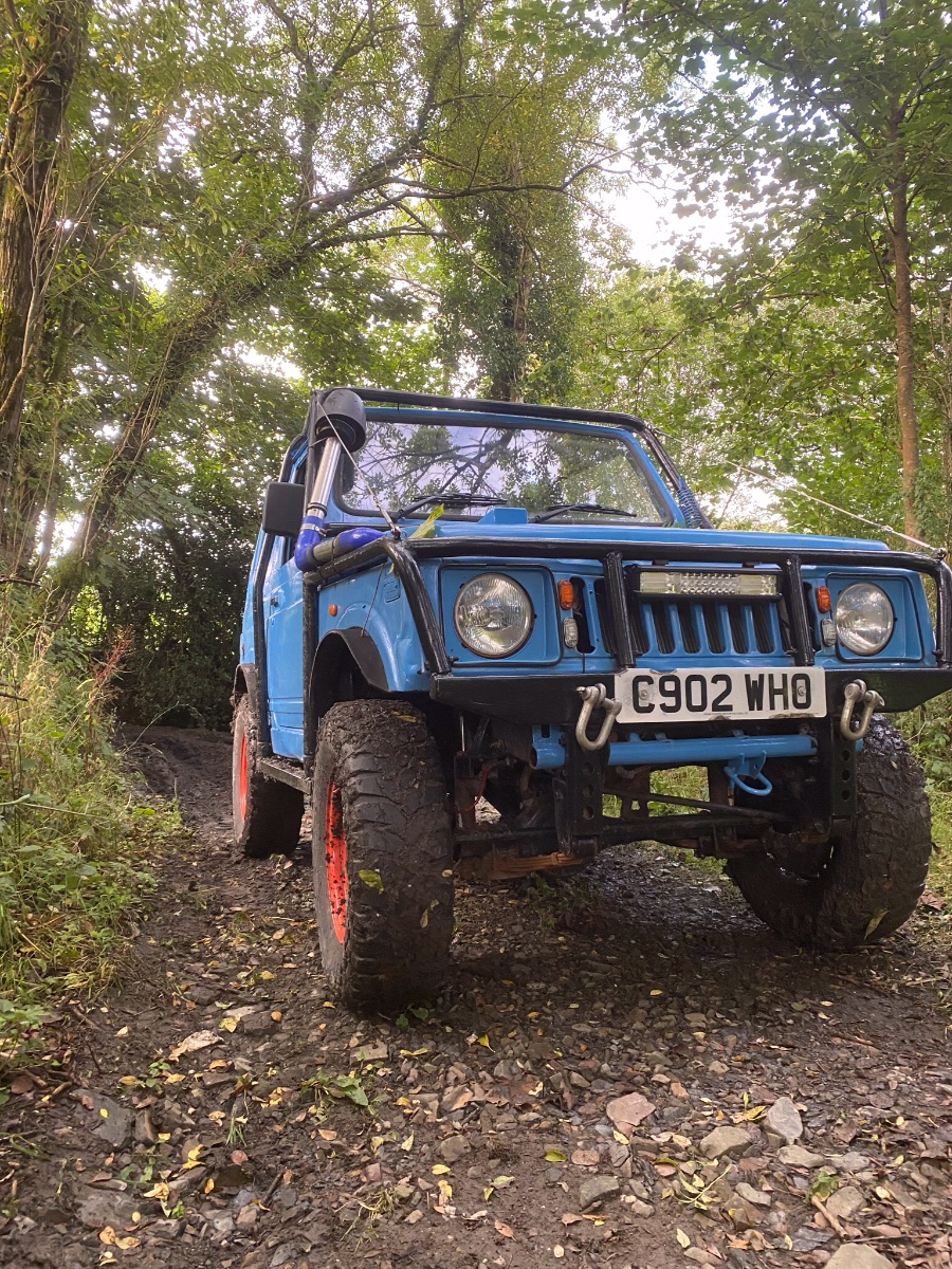

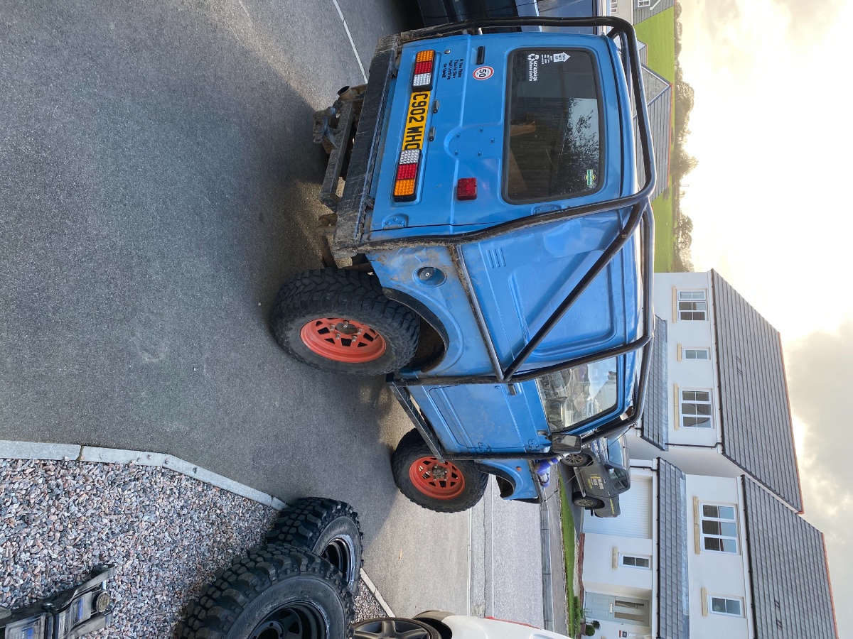

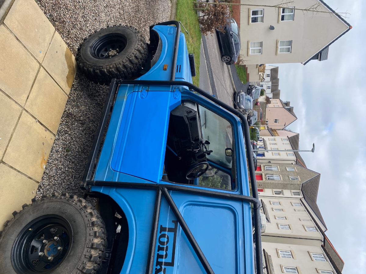

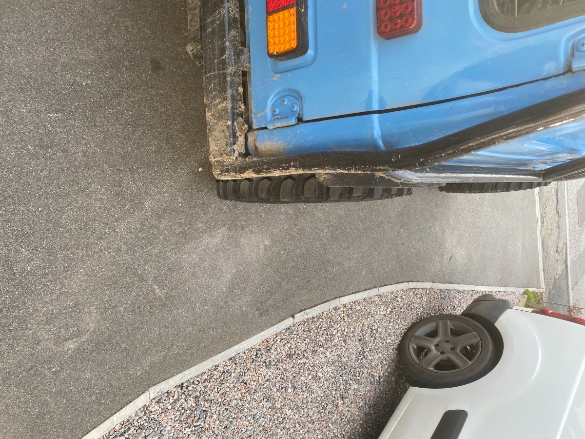

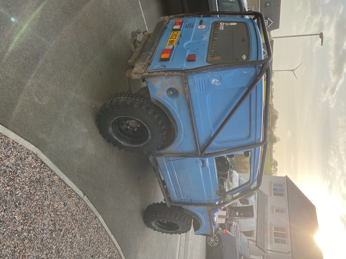

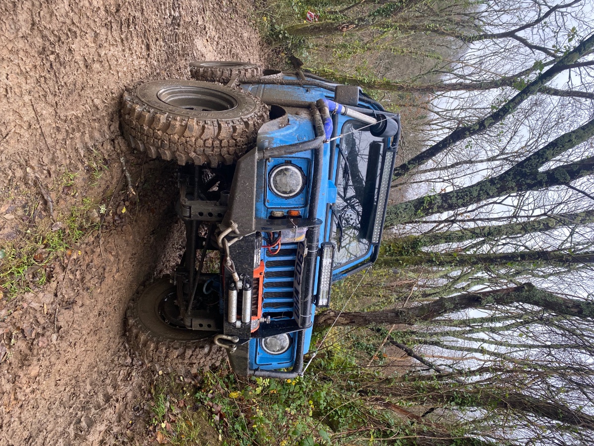

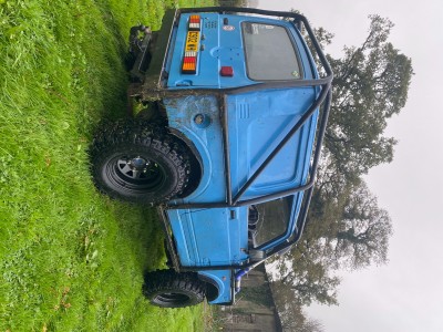

A bit has changed since I was last on I have gone ahead and got my self some brand new wheels abs tyres 235/75/15 also finished my roll cage :weld:
Yes Scottie I have bump stops fitted the wheels still Catch in places off road so I will have to get the hammer out at some point
Also looking at a set of 3” rear leaf springs and a decent set of shocks if anyone knows the best place to get them ? I’m running calimini springs atm and pro comp shocks which are leaking thanks

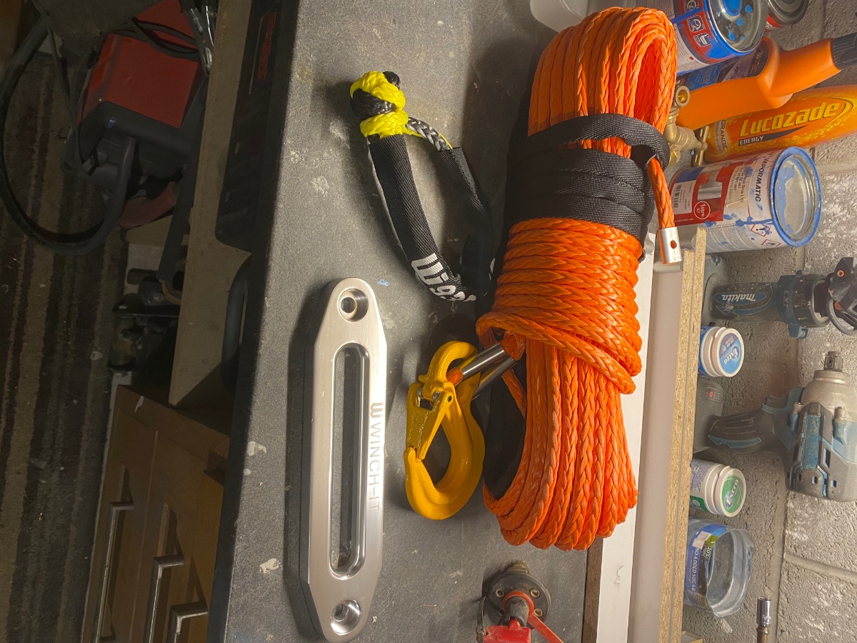

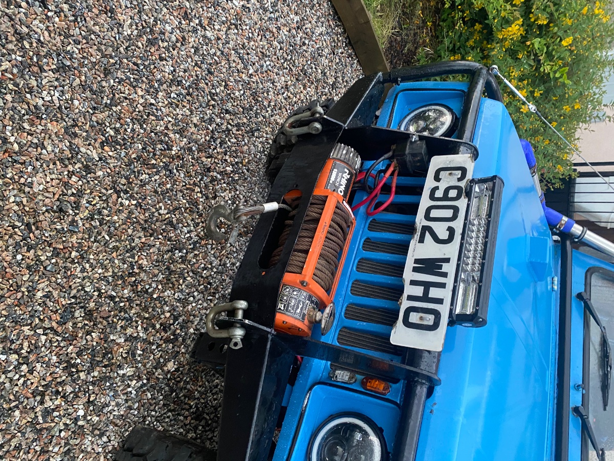

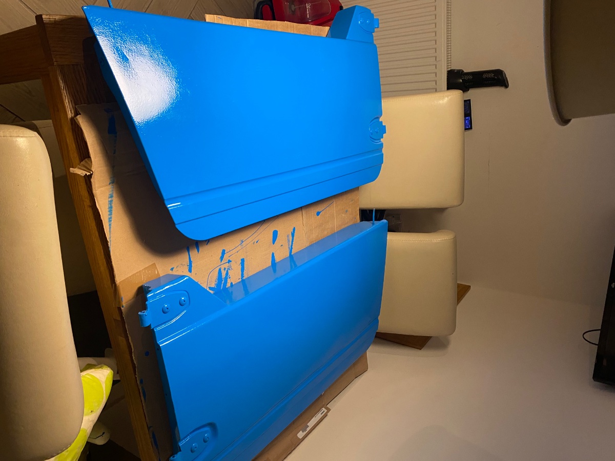

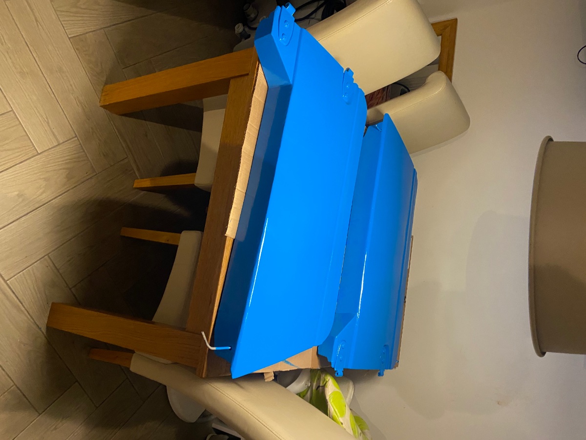

Got new winch rope and also managed to make a set of half doors for the Sj with all the spares I have shame there slightly different colour
