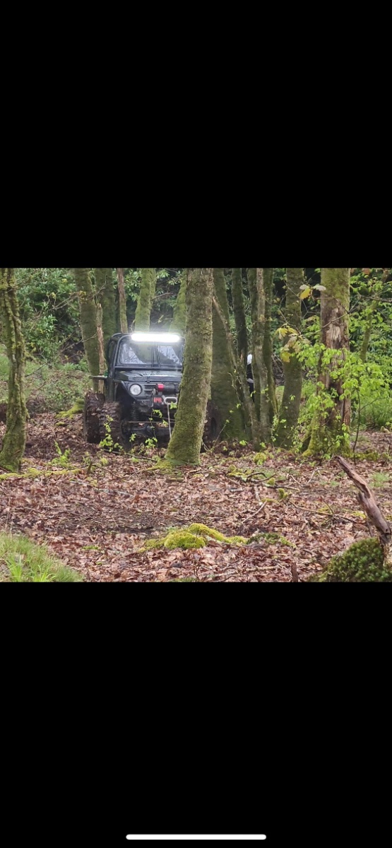

Post by mike harris » Thu Feb 17, 2022 8:47 am
Another Devon event last weekend, we came joint first which is cool !
Had some contact with a tree hahahaha

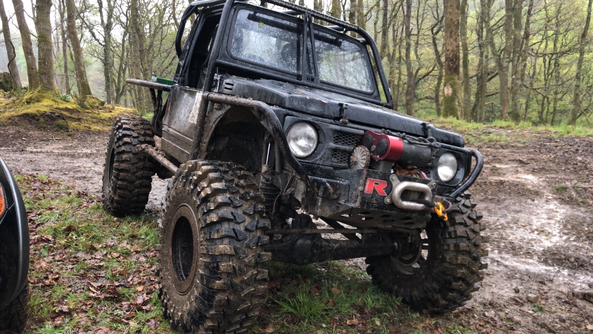

Post by mike harris » Mon May 02, 2022 8:39 am
Came first again today down in Devon at a winch challenge at Torrington weak farm
Great event did 39 out of 40 punches.
Truck was spot on
Hope everyone’s keeping well
Next event is the stampede up in north Devon on the coast.

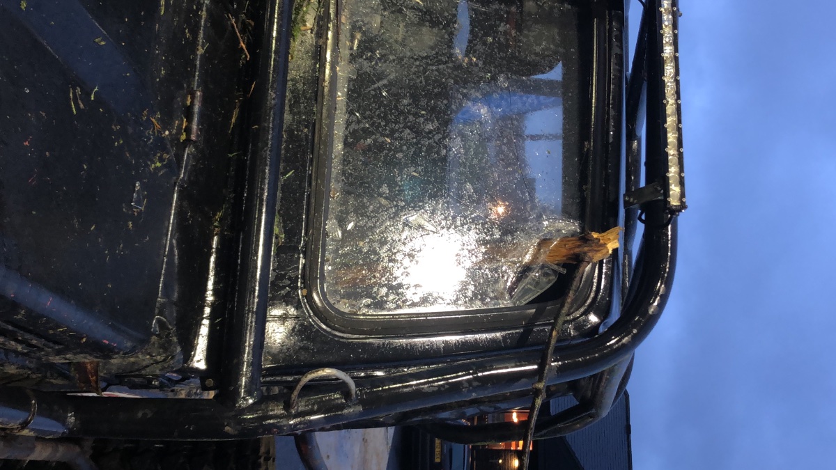

Post by mike harris » Wed May 11, 2022 10:20 pm
Rope snapped hahaha
Il add some more pics as prep for next event starts

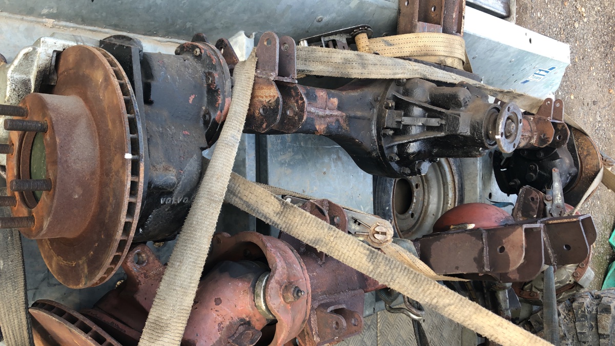

Post by Jordi » Tue Sep 13, 2022 2:29 pm
What are the portal axles out of?
Posts: 1829
Post by mike harris » Sat Oct 01, 2022 2:13 pm
Volvo c303 bud, but the 6x6 version with a 4 pin diff.
Should be getting on it next few weeks. Just been collecting up the parts for wheels and steering ect.
Posts: 1829
Post by mike harris » Sat Oct 01, 2022 2:28 pm
My mates truck that’s on portals is around 6 ft 8 inches wide, my car is 6ft 2 inches wide at the moment, so three inches of width gained means il be able to lower the car and keep tyres away from front arms.
Steering I’m not doing hydraulic or anything just using the standard setup, these came of a military vehicle so there very well thought out and strong.
Ratio is 7.56 to one, so going to have to fit a standard transfer box back and see what the gearing it like. Possibly might have to fit a 4 to one to correct the hearing, but we shall see.
