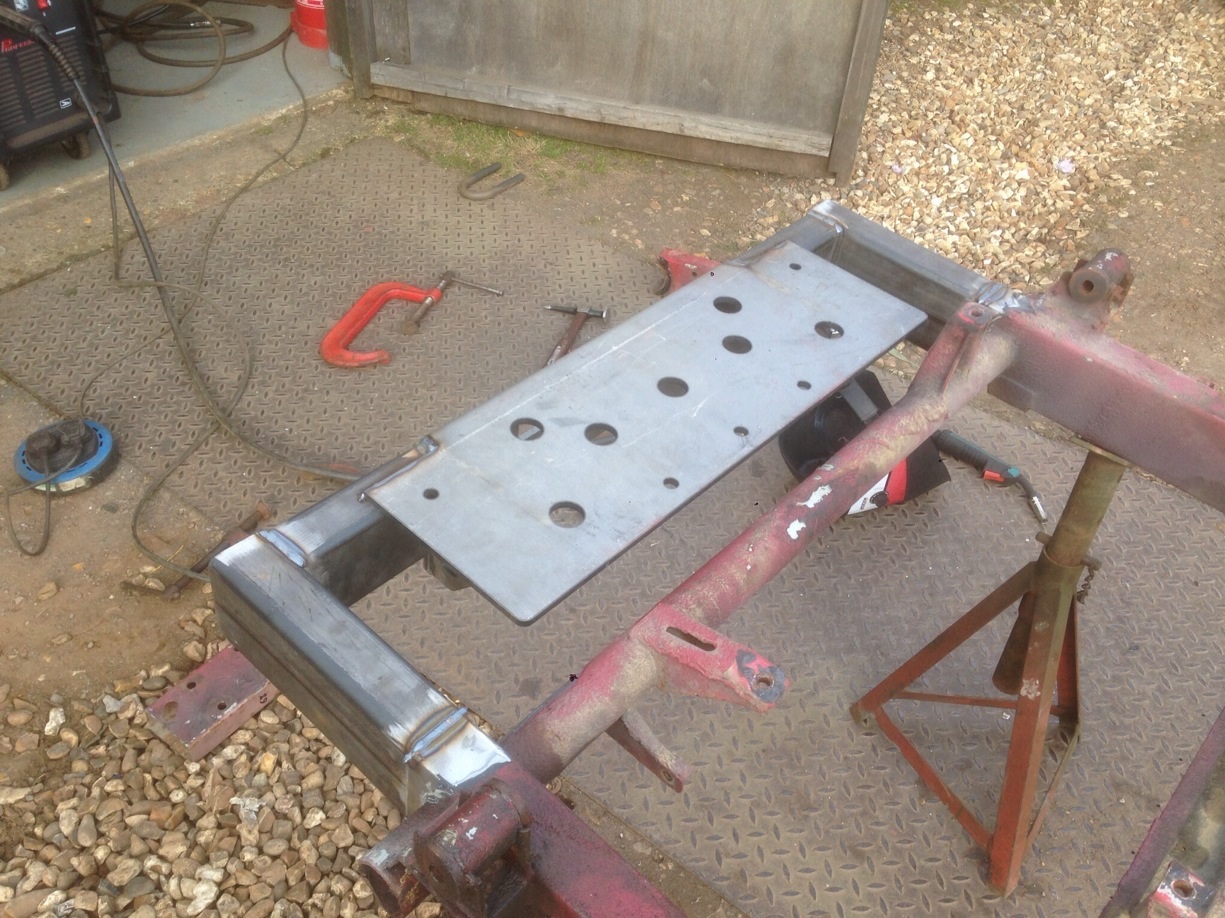

Today

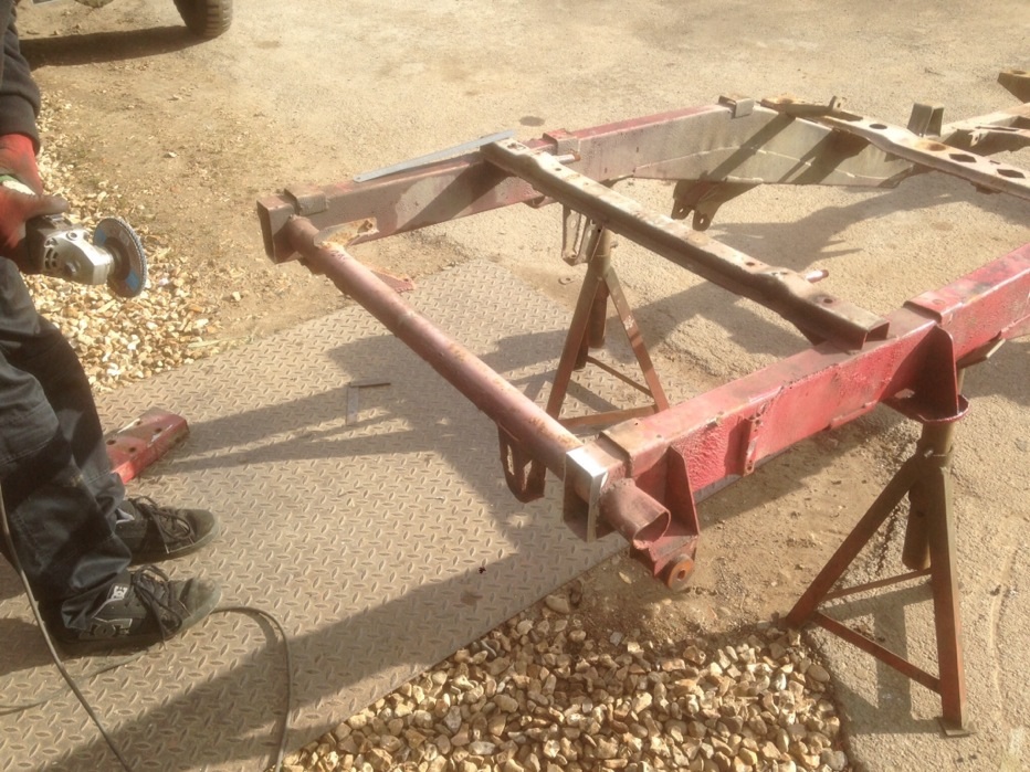

- Chopped the old legs off as they has holes in and the end had been cut out for a bumper
- image.jpg (262.5 KiB) Viewed 7992 times

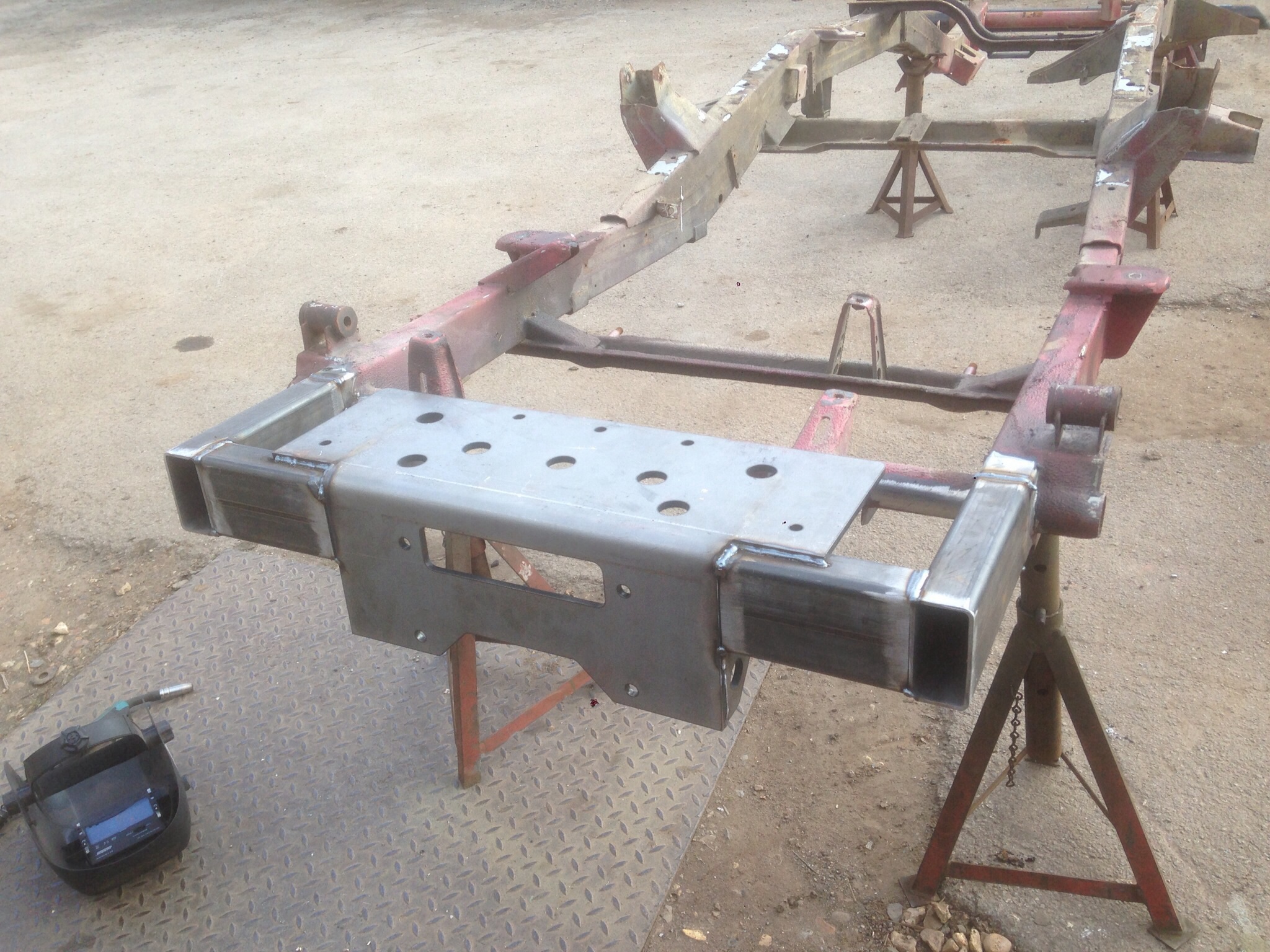

- Re made the legs from 4mm box section, into the gwyn lewis winch tray
- image.jpg (927.09 KiB) Viewed 7992 times
- Tray is made from 8mm plate
- image.jpg (395.35 KiB) Viewed 7992 times

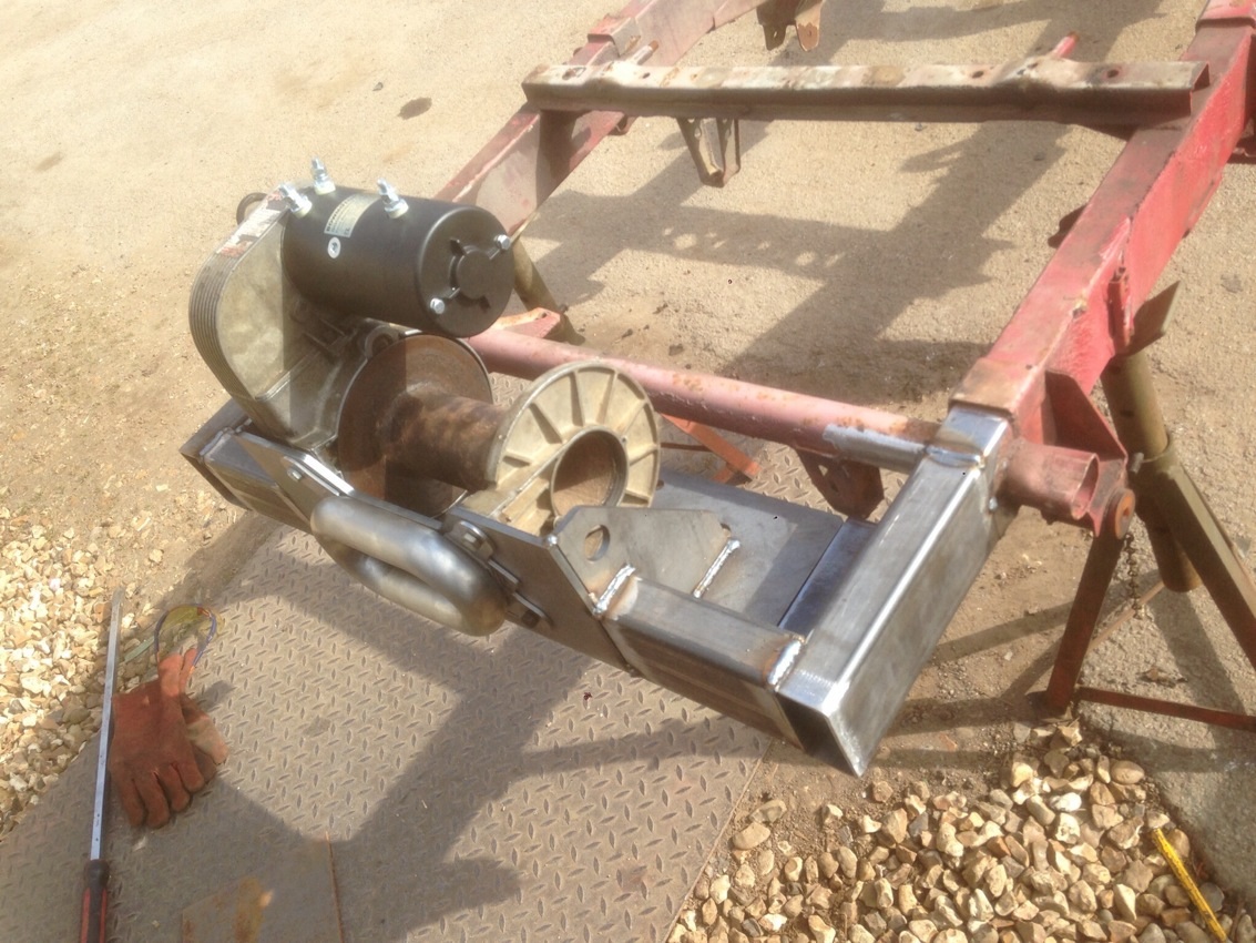

- Winch mounted with delta tek wide mouth Hawse
- image.jpg (214.44 KiB) Viewed 7992 times
- Tacked into place
- image.jpg (330.1 KiB) Viewed 7992 times

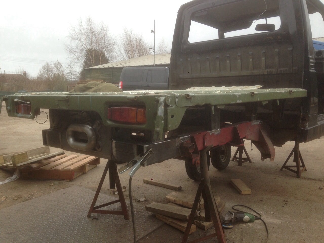

Then we did this !
Lots done today, needs all welding up but it's all tacked into place. We cut all the old body mounts of the rear to tidy up the chassis legs as well, looks much better. Beds pretty much where a kja bed should be, next challenge is to put the bulkhead back into the bed, this is tricky as that's where the rust is, and all the hinge mounts ect.
Still got to make up the rest of triangle plates to strengthen the rear winch tray, but that's easy, me and Ben smashed through this part today so we know where we are at with the bed. Can't drill holes and mounts it as the bed may change length to fit the bulkhead back in. Hard to explain but it will make sense
So please with the way the back looks

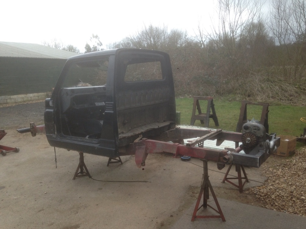

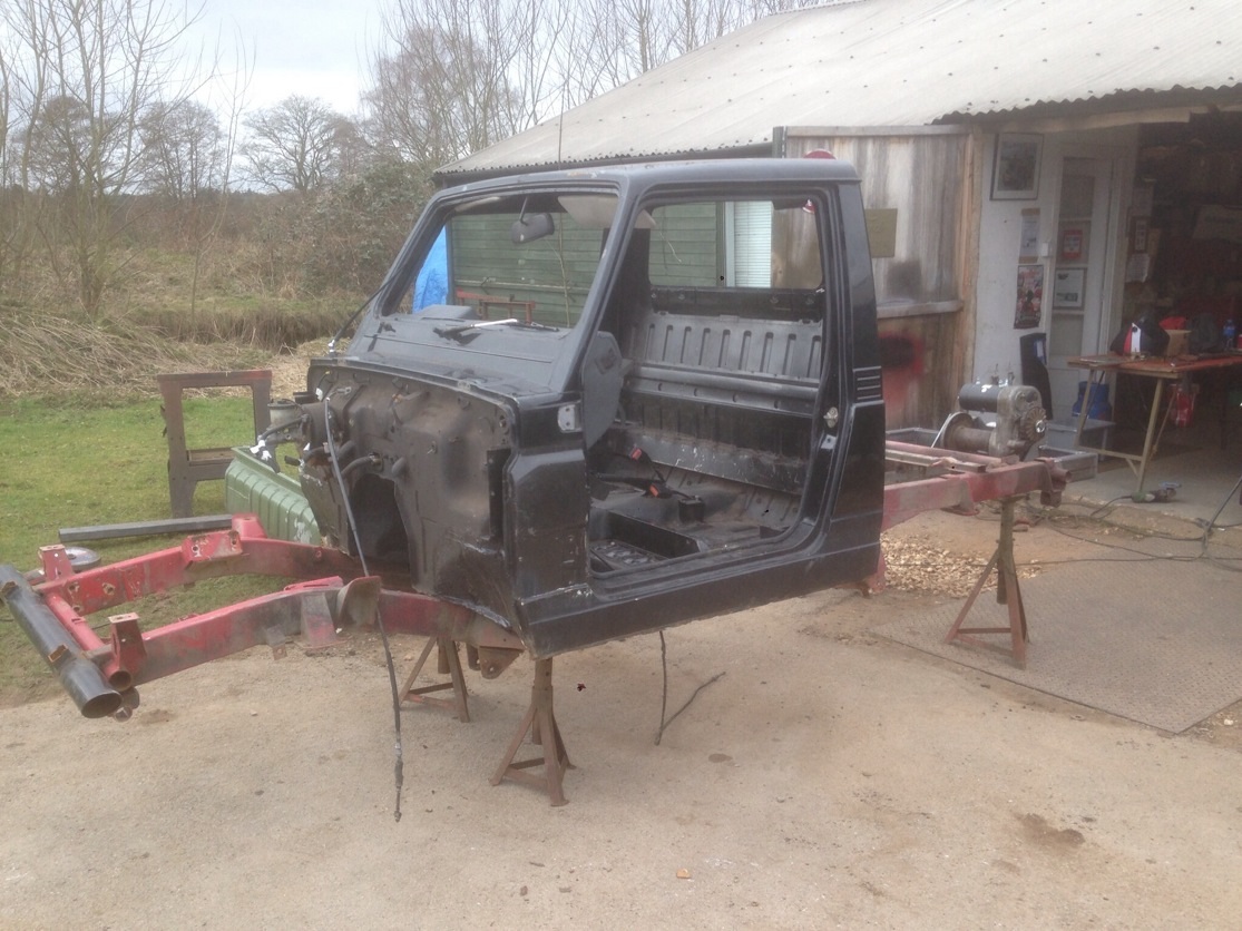

- Cab on !
- image.jpg (284.93 KiB) Viewed 7990 times

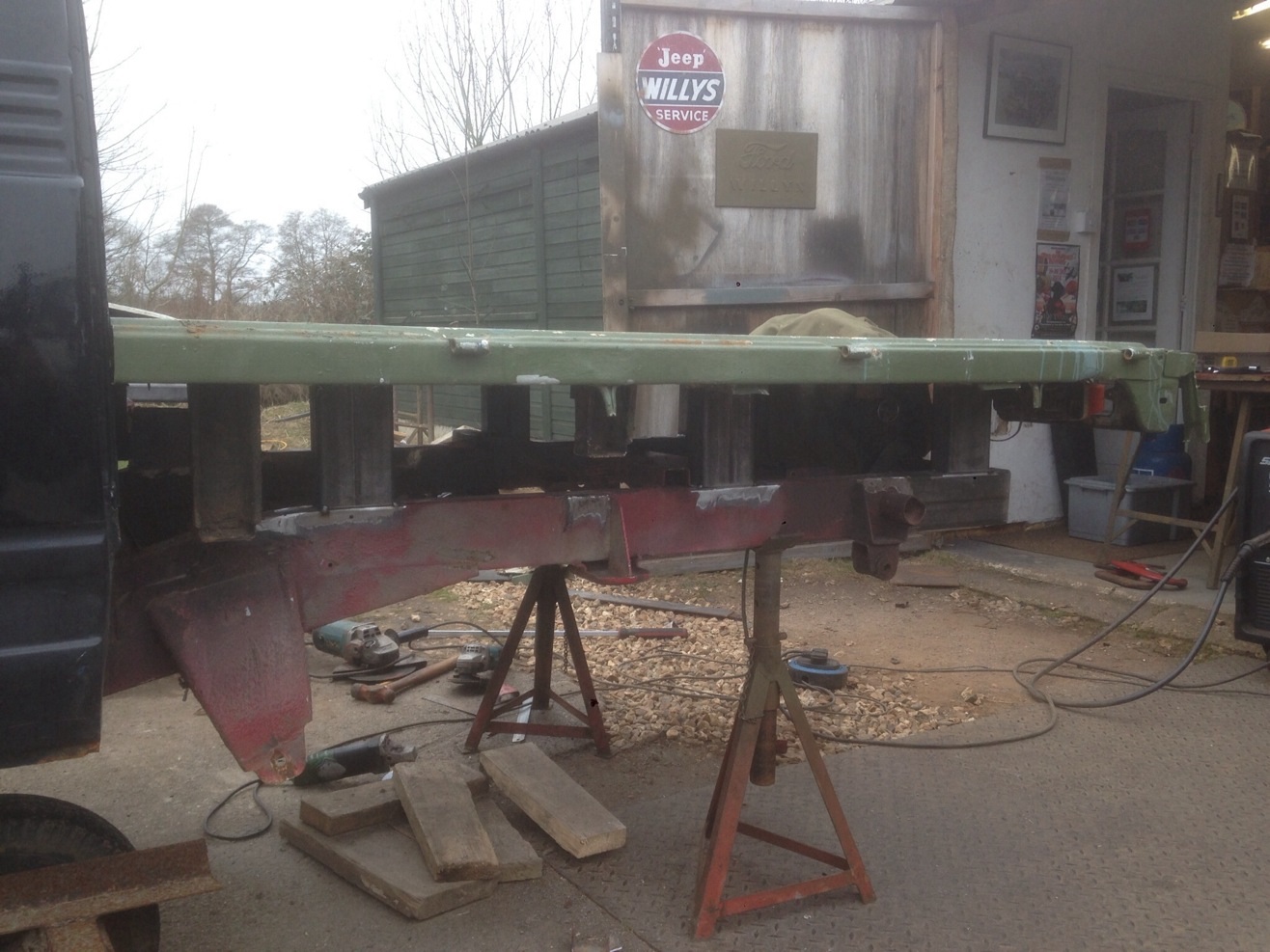

- Quite long !
- image.jpg (179.31 KiB) Viewed 7990 times

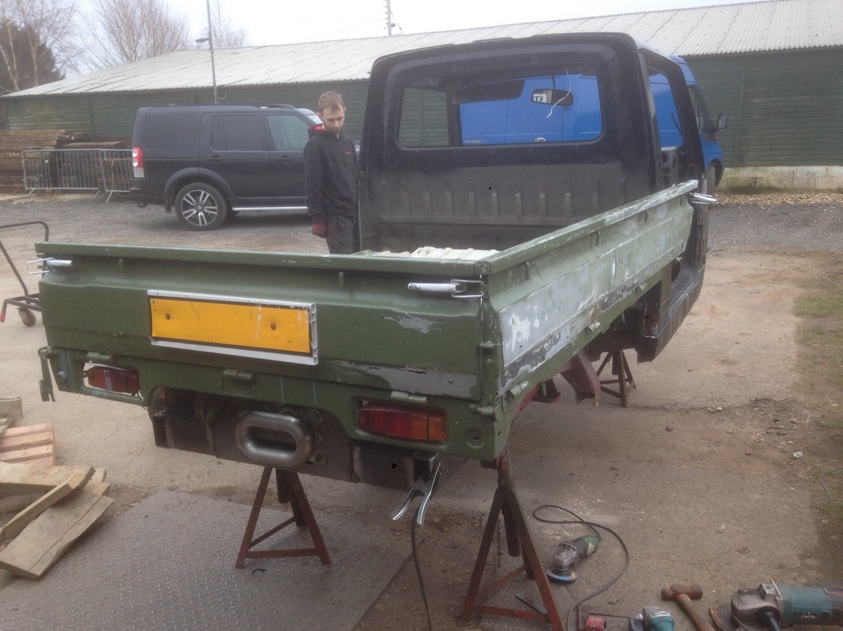

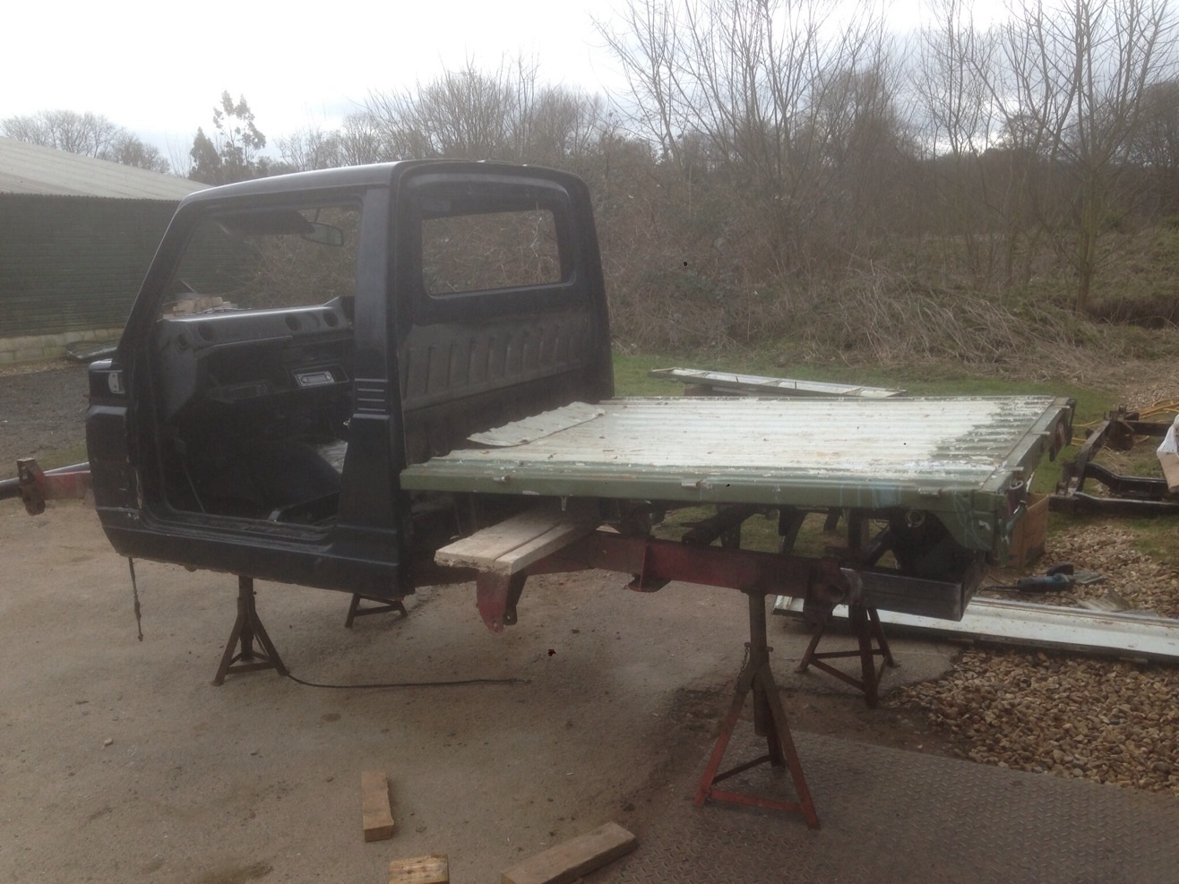

- Chopped the bed ! 2ft off the rascal bed, rested in on, way on the winch and wood way too hight !
- image.jpg (346.42 KiB) Viewed 7990 times
- Cut a hole for winch to sit through made box section mounts 230mm long to sit the bed on.
- image.jpg (321.01 KiB) Viewed 7990 times

Tidy work Mike, looks good! Some tidy welding as well
Are you planning on fish plating the join? Would be a good idea I think as that joint will be under a lot of stress winching.
As for the front it shouldn't be hard to remake it using a similar technique to what you have done on the rear. Would also be a good time to extend the wheelbase at the front if you were still thinking about a slight stretch

All in hand ! Yep already cut them out, triangles for the inside too, inside the new box section against the tube and at the back, then down from rail to the tray.
Today was just to get an idea of what needed to go where, before today we had no idea really, now we can see what we have to do to progress.
I may try and bash the bed out next weekend just tack it all in place and have it blasted, as that may take a couple of weeks to come back.
