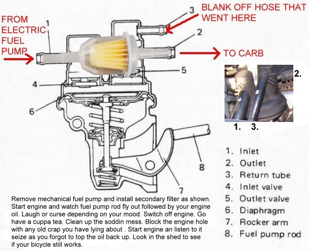

Re: Changed the fuel pump but theres something wrong
Post by Darrell » Sat Apr 28, 2012 3:58 pm
Edweird wrote:Don't forget to blank the hole. Oil makes a mess.
Modified it :thumbup:
fuel pump 2.jpg (76.85 KiB) Viewed 7115 times
If it stopped bloody raining I could do something useful instead :thumbdown:

I haven't got a bicycle so I better get this right :lol:
P.S. Where does the red wire on the fuel pump go ( got to keep you busy while it's raining )

Good question, but I'm not sure. If you connect it to any live after the ignition switch it will work, but what about safety issues as it will pump regardless of the engine running. This is not a problem unless involved in a accident and it's safer if it switched off. Been a had a read-up and it's blooming complicated to make it work like that and would require some electronics. So I can assume most people just connect it to any live from the ignition switch IE: the black and white wire to the ignition coil. I would fit an inline fuse to this wire. Do you know what current this pump uses as that determines the fuse size and whether it's OK to add that load to any particular circuit.
Post by Darrell » Sun Apr 29, 2012 12:06 am
"googled" Facet fuel pump amperage and found this
http://www.facet-purolator.com/faq.php
So I'm sticking with the black and white wire to ignition coil/carb solenoid (on an SJ) fused to the pump at 3amps.
Not sure what colour the coil feed is on a vitara though :er:
