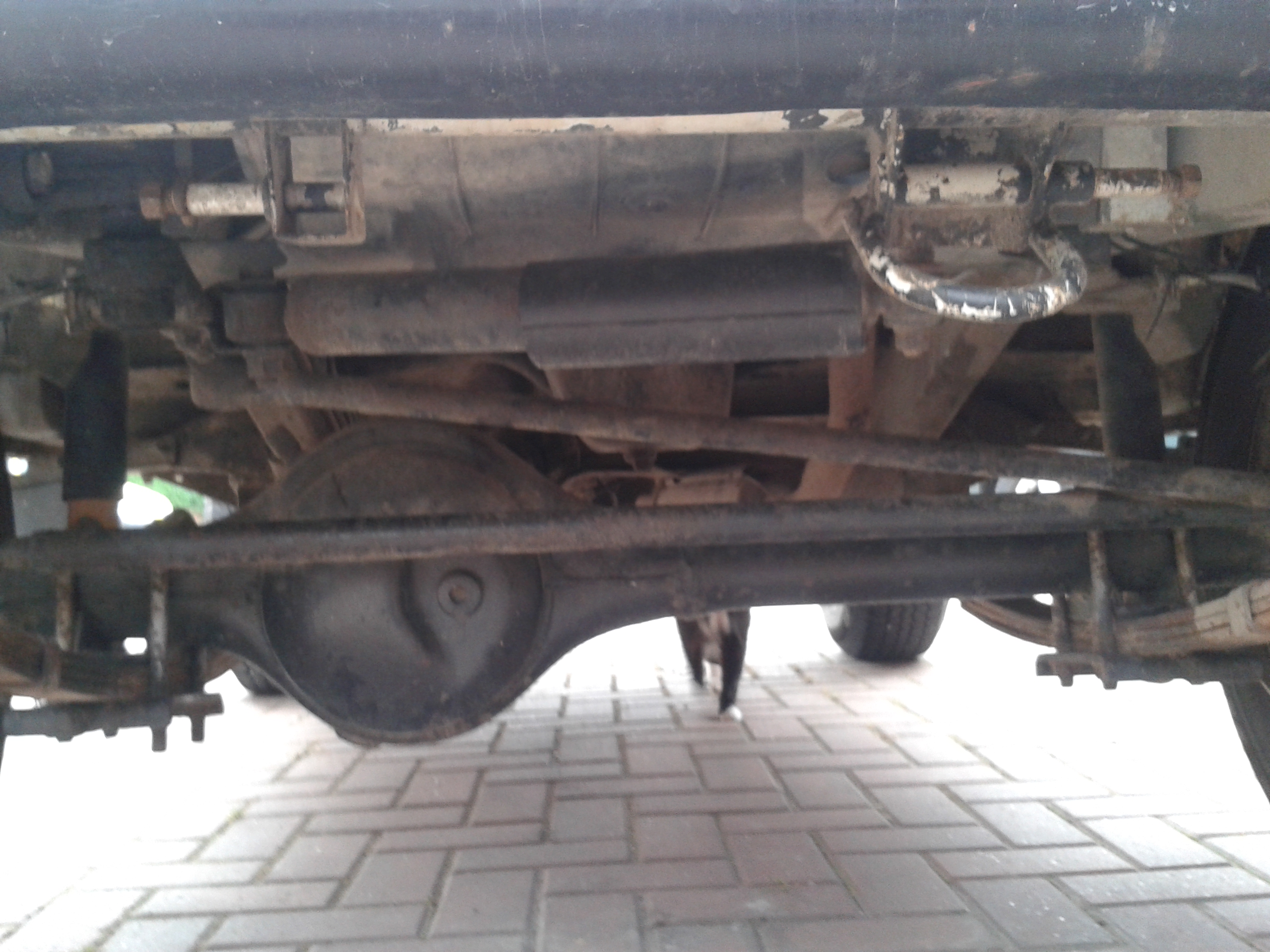

Re: just bought my first sj samuri :)
Spring under
(Cats legs none standard
stupid cat)
Oh right so it may make it better in ways lowering it then? Also if it has been done this badly what else could it have damaged and would this have caused the axle to become bent??
Also I have a few pictures of the spares I got with it along with the new springs that come in with ok bushes?? I don't know why two of the bushes have been cable tied on though?
