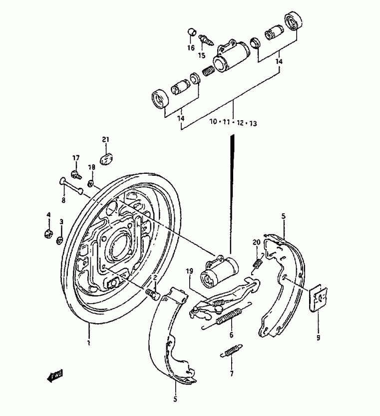

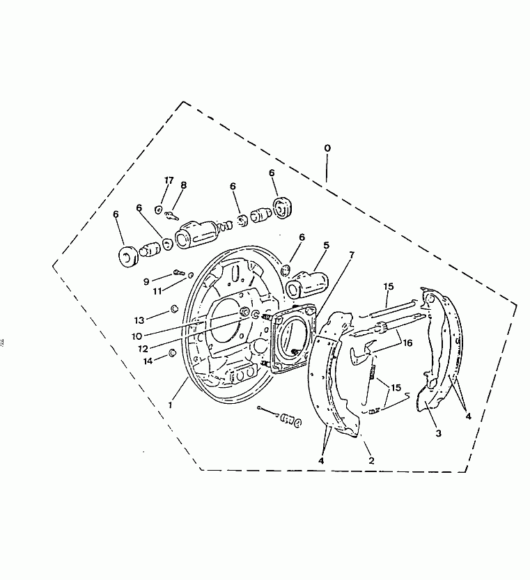

Some use the brake back plate as the bearing retainer, this means the hydraulics/brakes need disconnecting.
Some (hopefully yours) use a separate plate which when removed lets the shaft out without doing anything to the hydraulics/brakes. :thumbup:
I'm not sure if the difference is an age issue or the country it's made/built in.
Re: remove rear half shaft with bearings.......
Post by Darrell » Wed Jul 23, 2014 10:28 pm
Diagrams ;)
