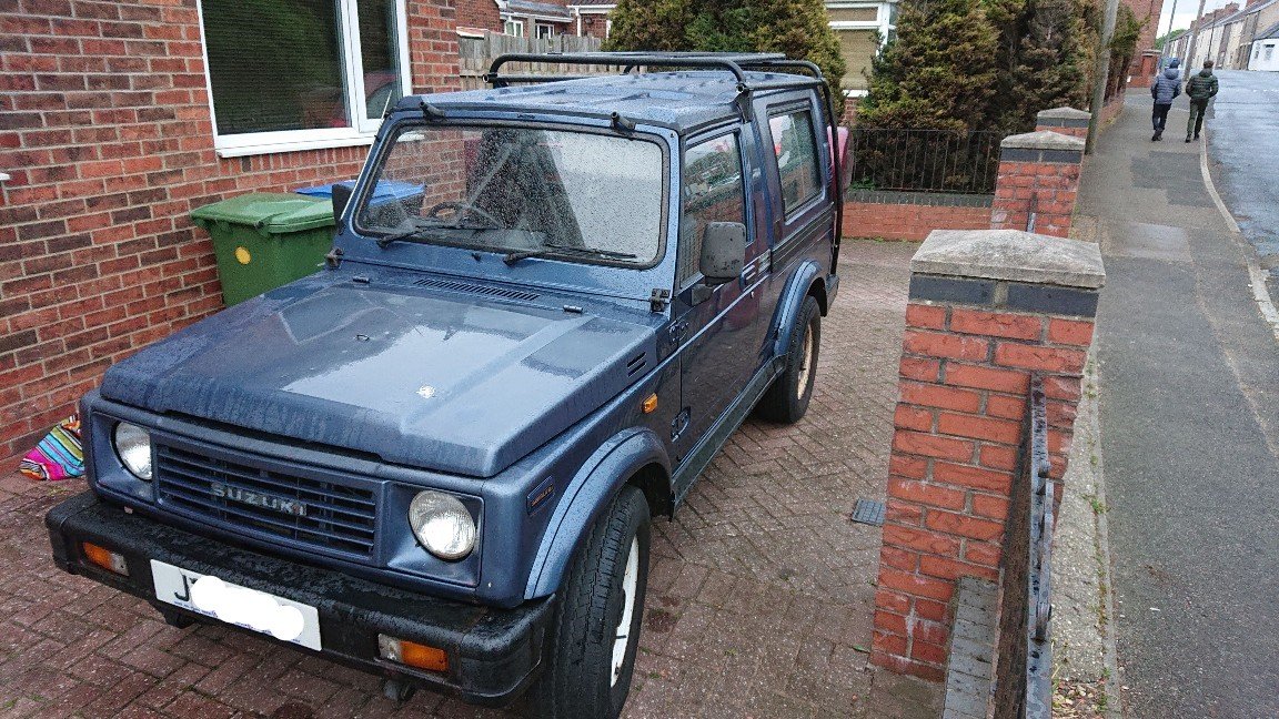

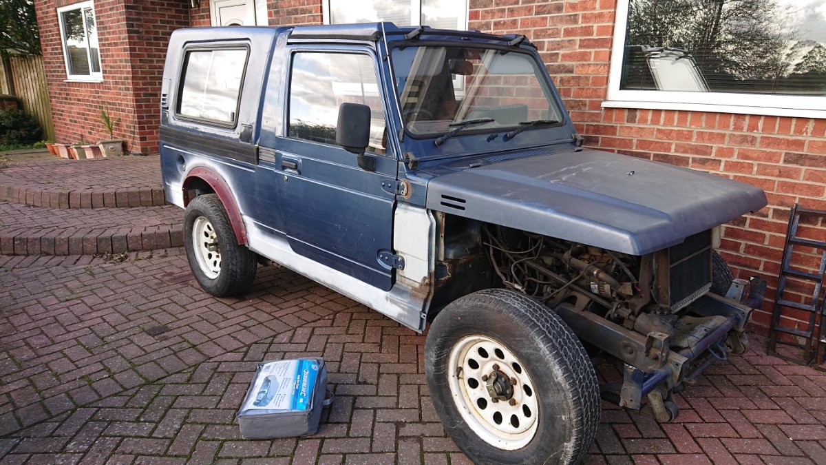

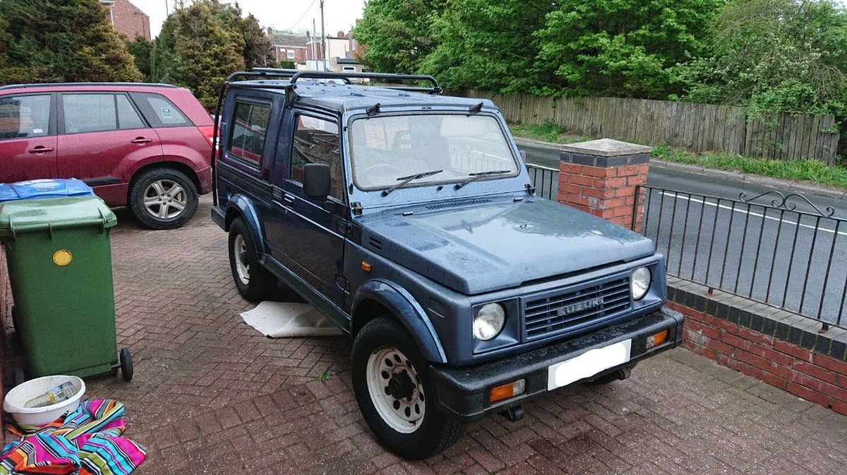

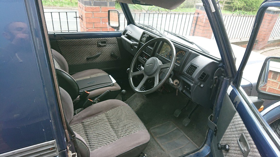

Well we got this lwb 2 years ago now and we are finally getting somewhere after some 3rd party work

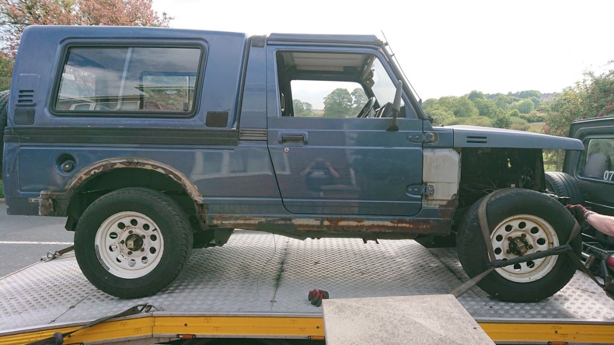

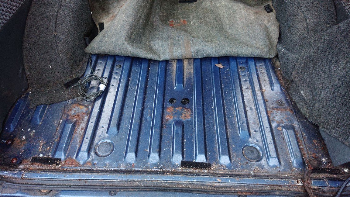

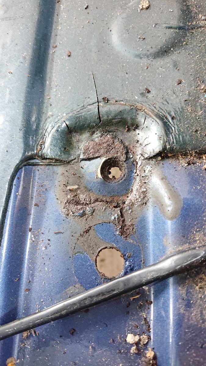

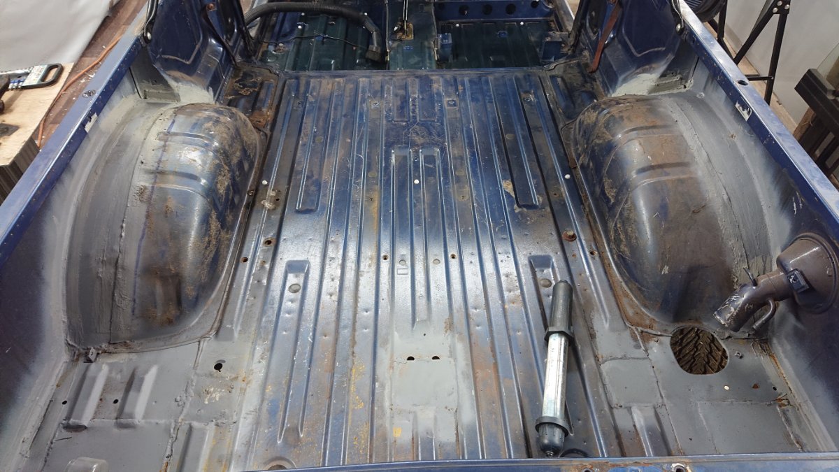

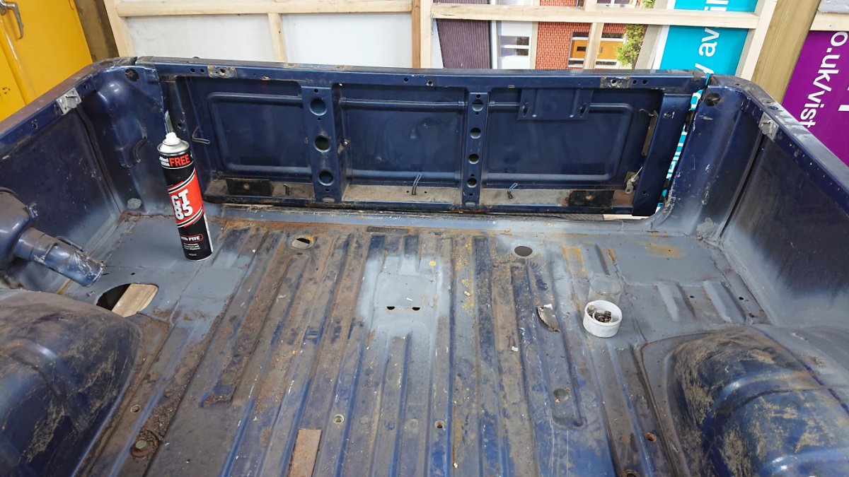

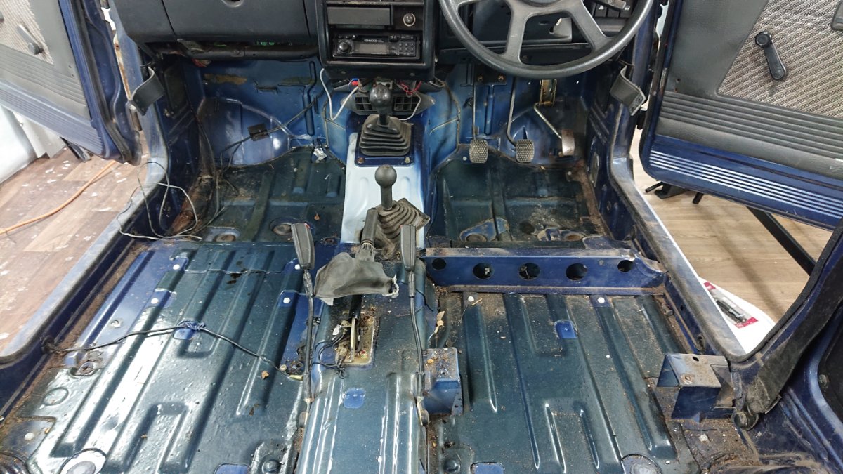

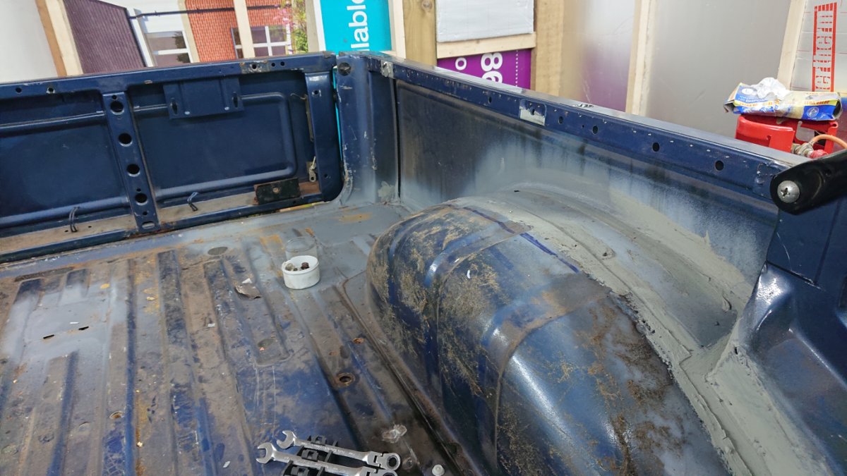

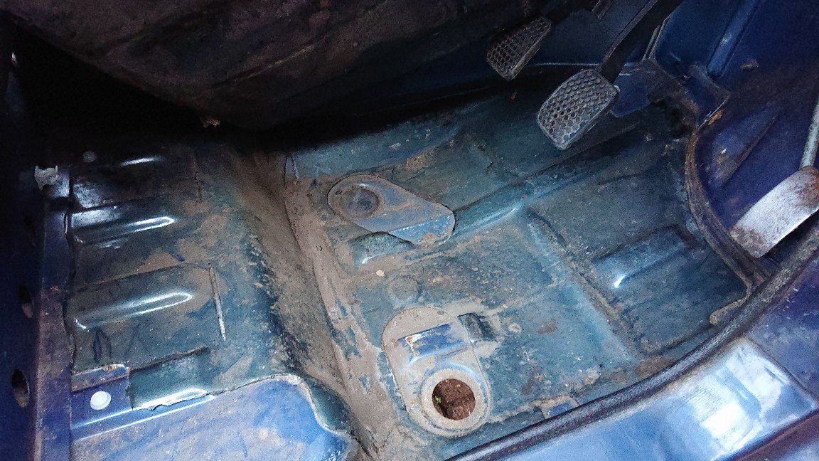

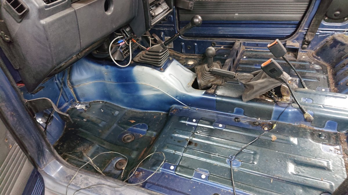

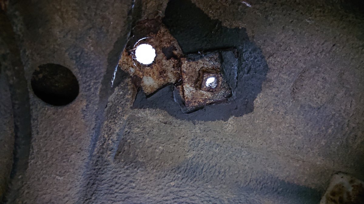

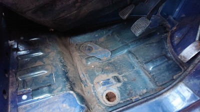

Initially it had alot of hidden corrosion in standard form but it was standard form which is good. No previous repairs beyond a full drivers side floor well at some point from a donor. I really should of pulled those carpets back just a bit further but lesson learned it was still a good lwb.

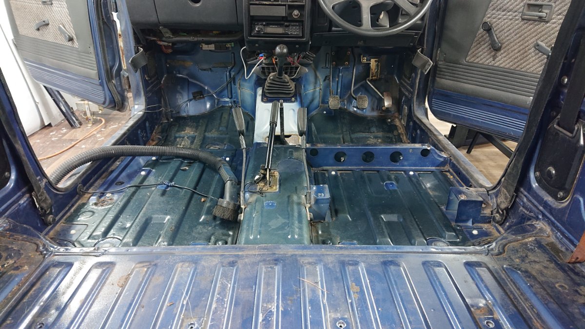

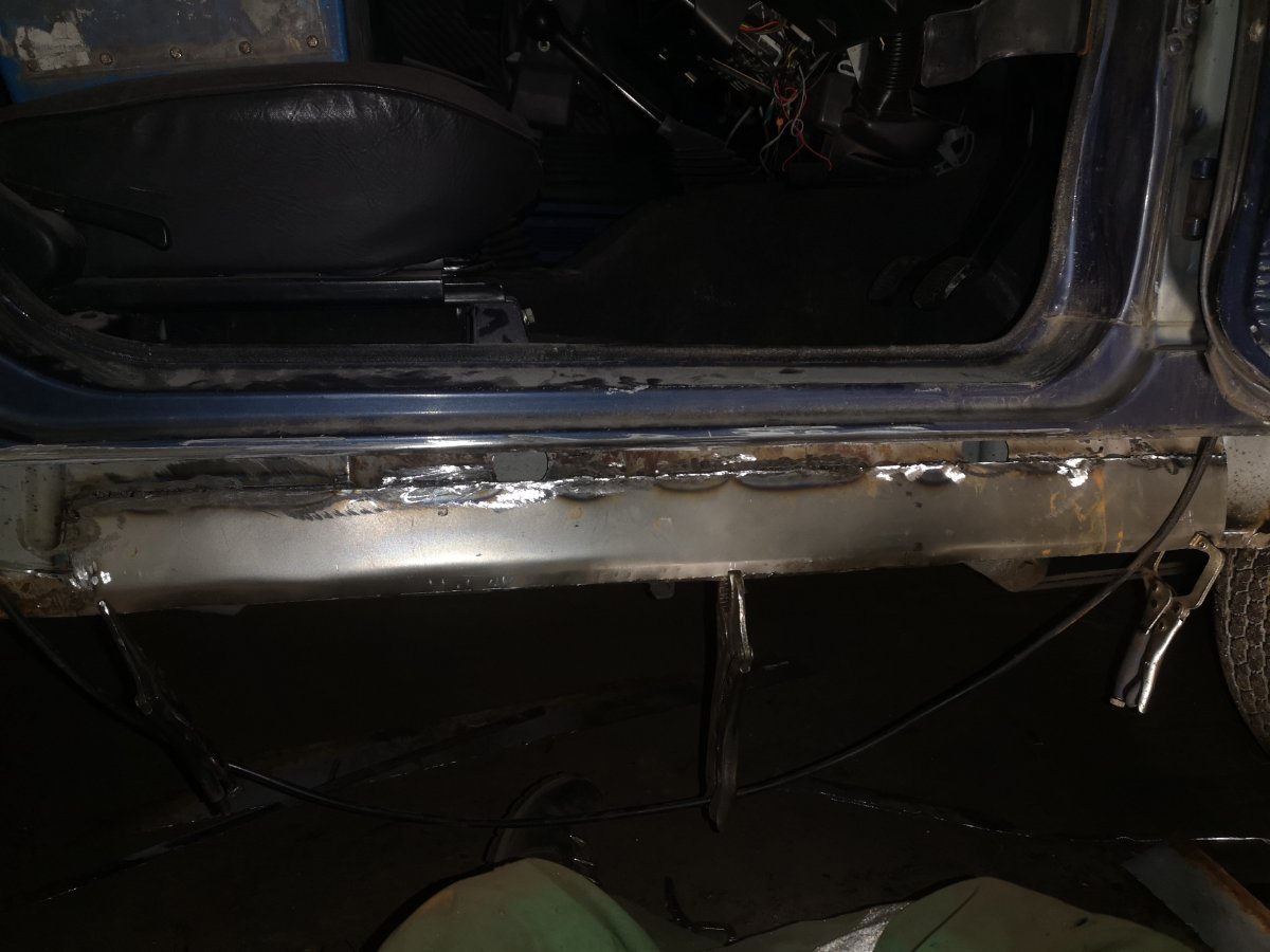

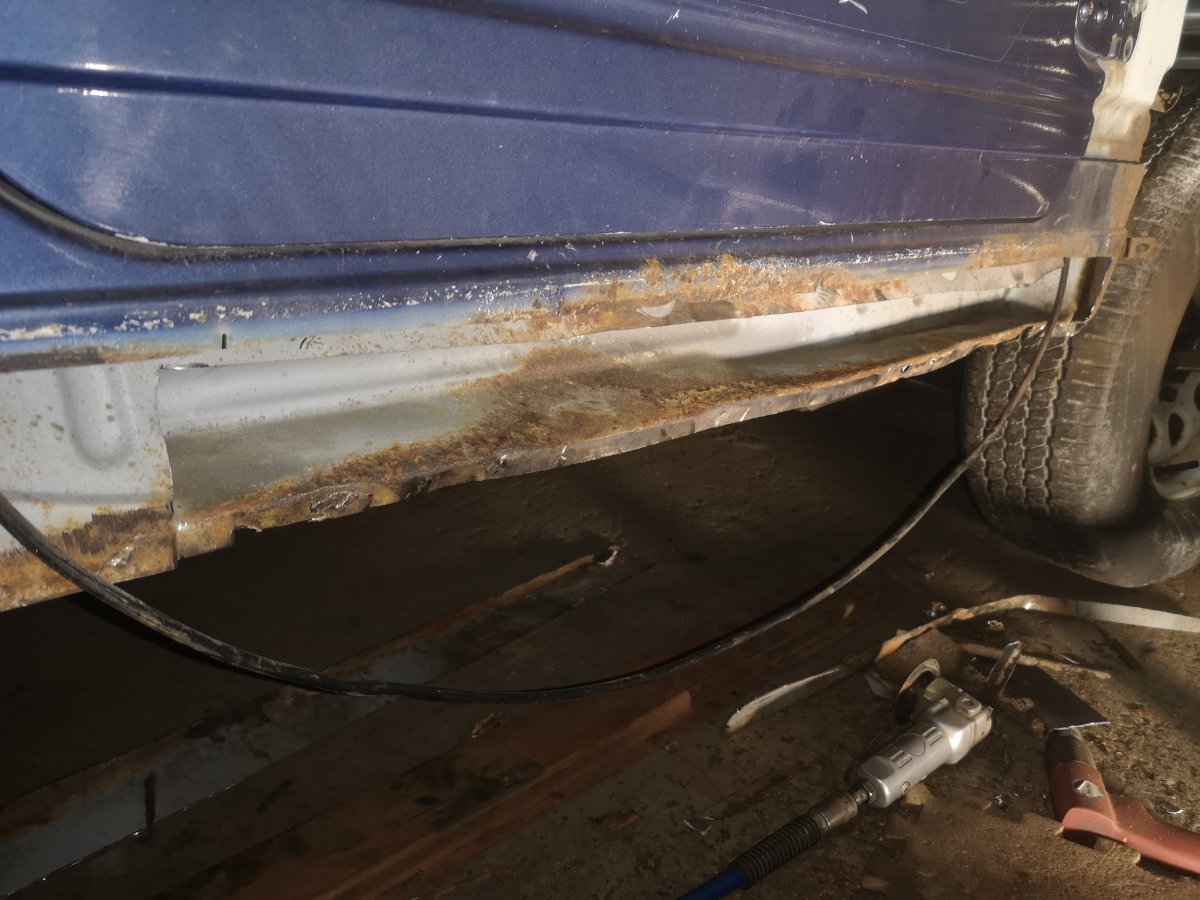

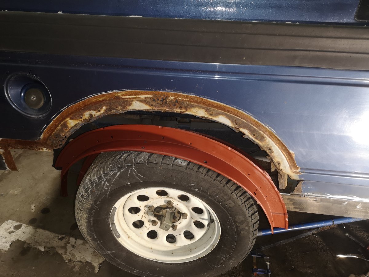

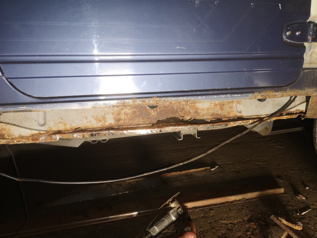

After the trim came off we saw the real state of affiars and how much welding was needed even on a good Sj.

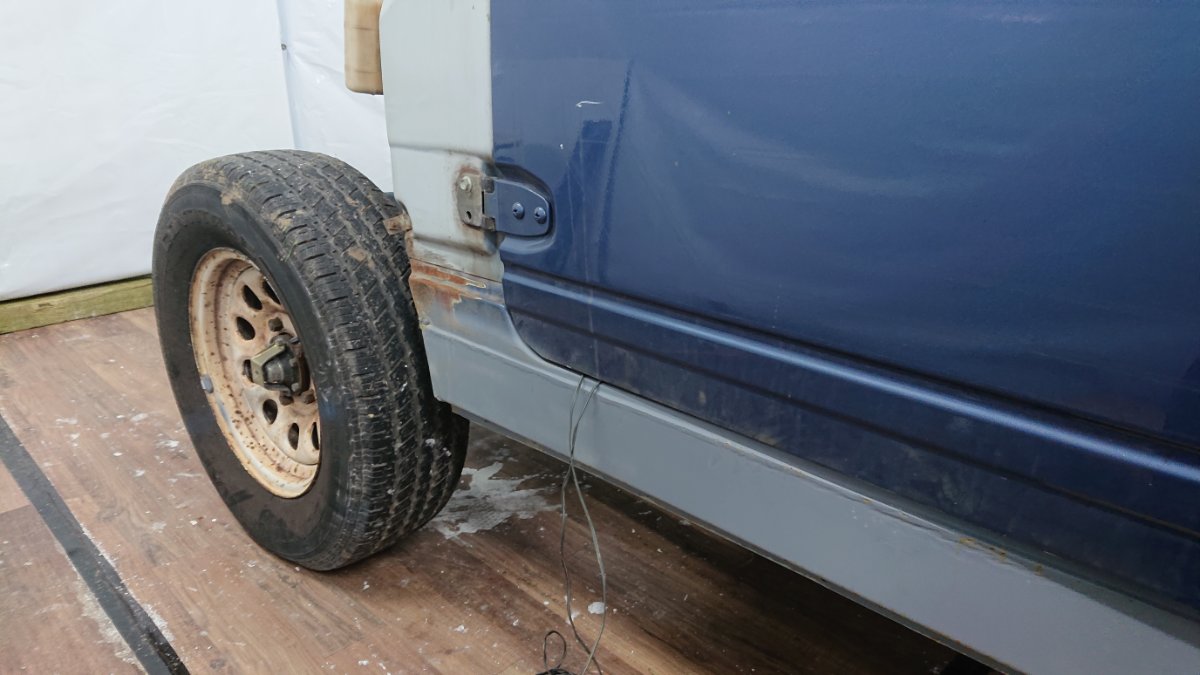

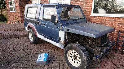

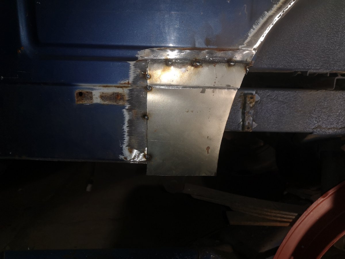

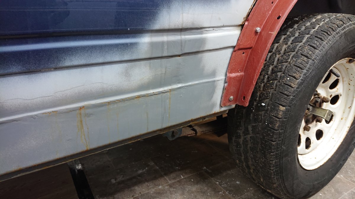

My friend fabbed up some outer sills and trim covers for us, i got two new wings and it was ready for welding.
First of all a friend cut lumps out of it and dropped me in it (yey). Then It went to one lad who did a midnight runner from his unit in the end before not finishing it.Thank god as his work was awful

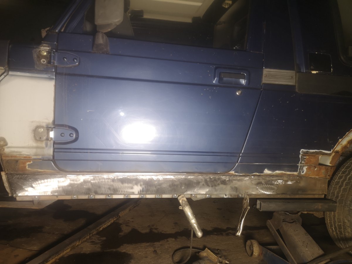

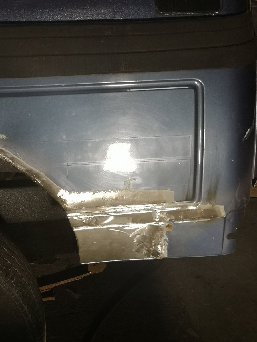

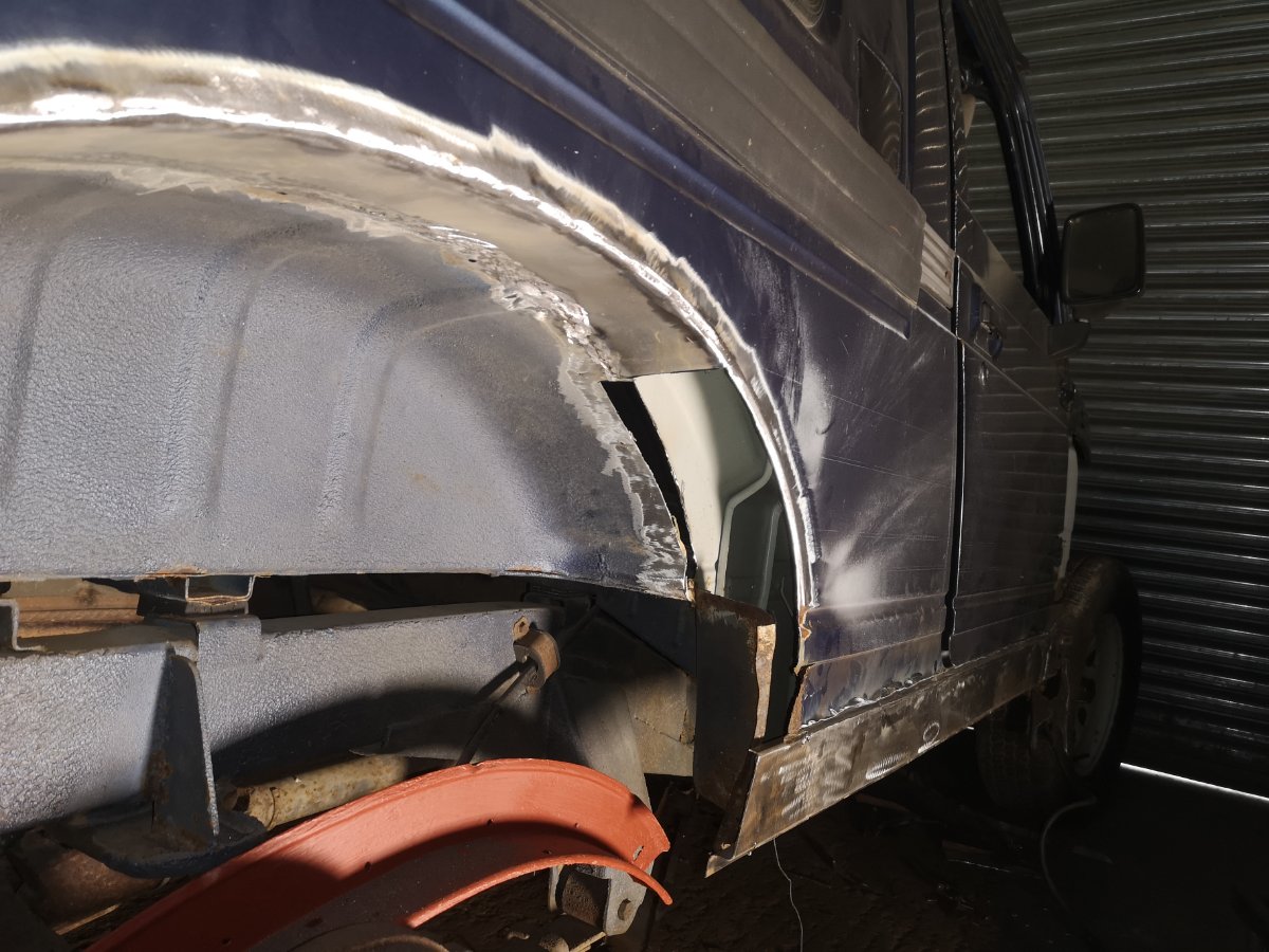

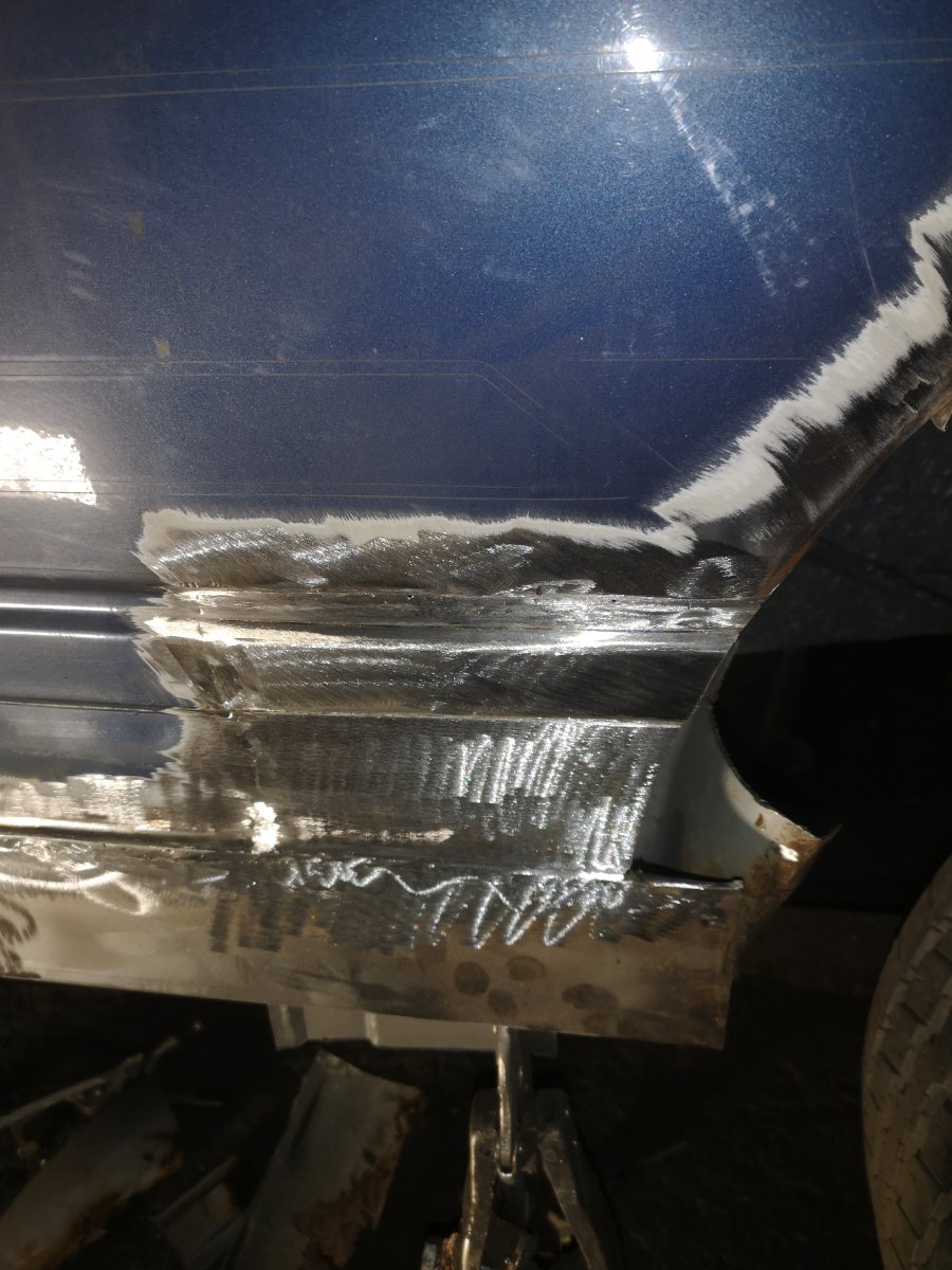

Finally it made its way to a decent welder who could get onto it....
First off anyone paying for welding work will know its a expensive affair and this was too. I can weld as a time served toolmaker but warp free bodywork is a different kettle of fish all together.

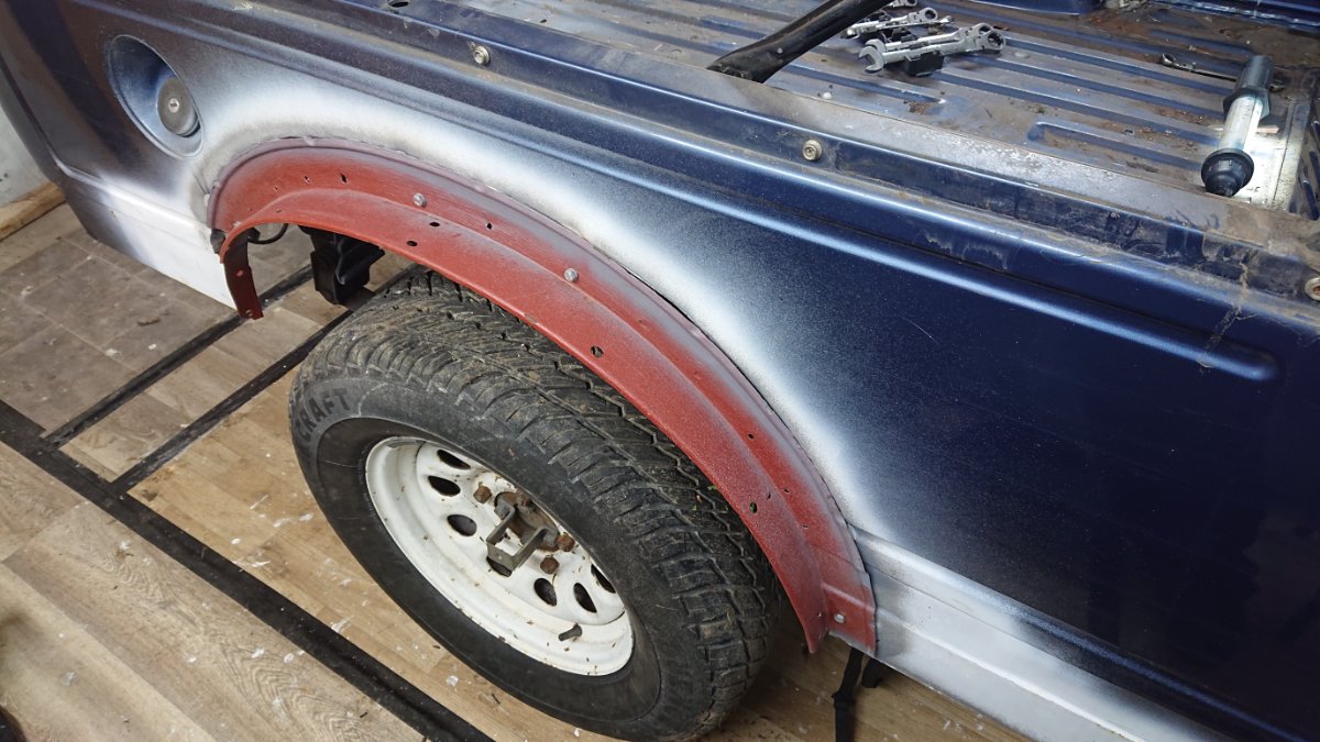

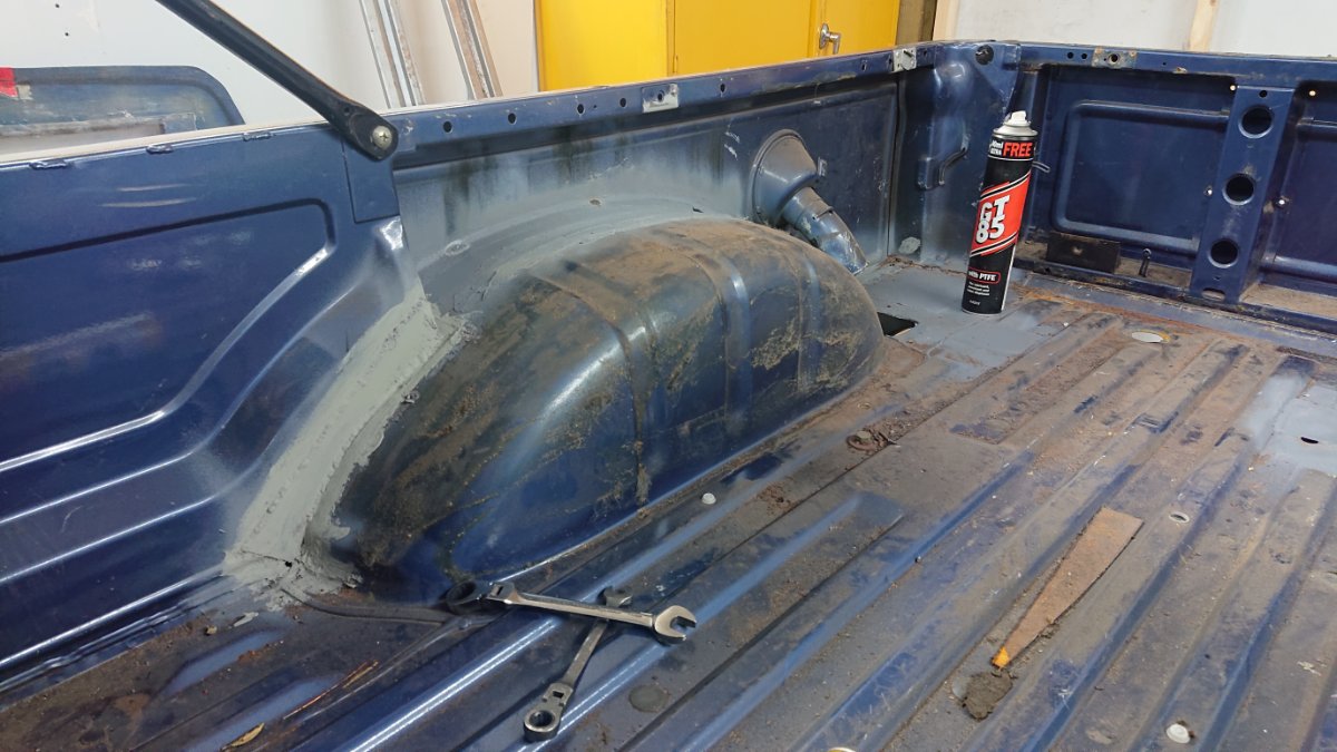

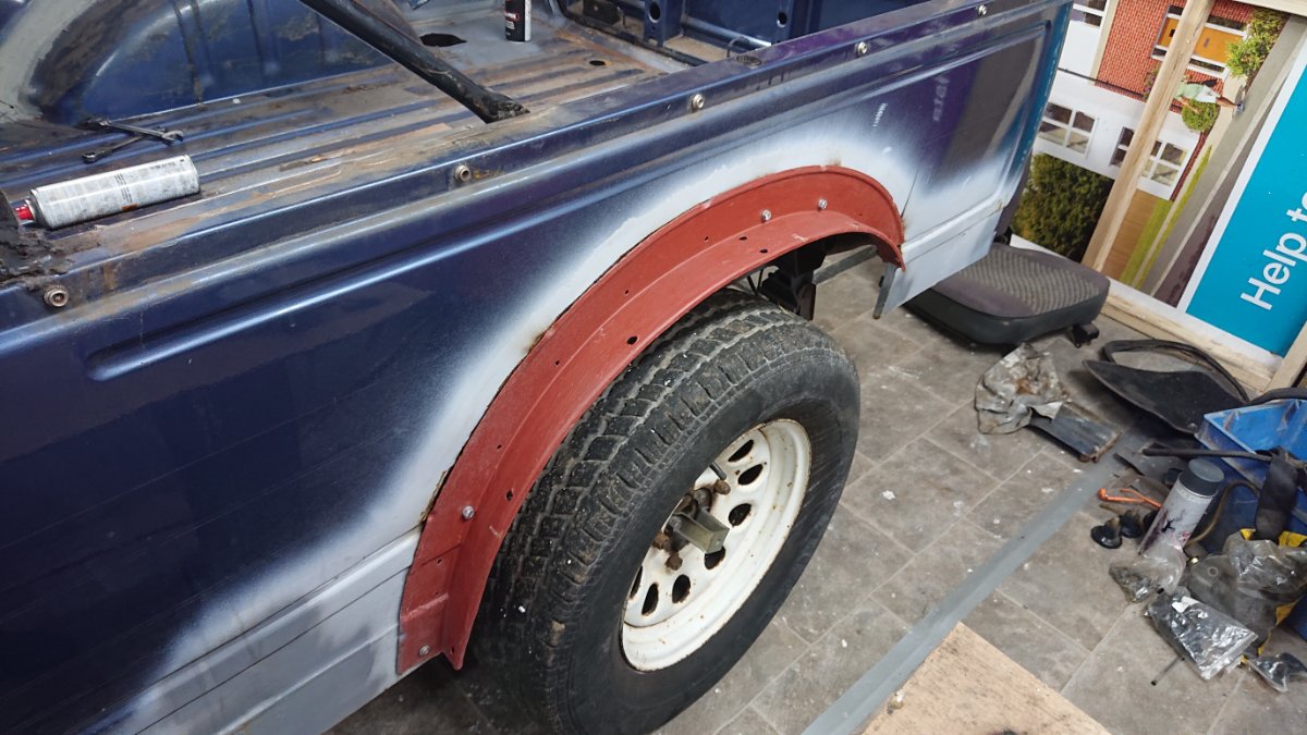

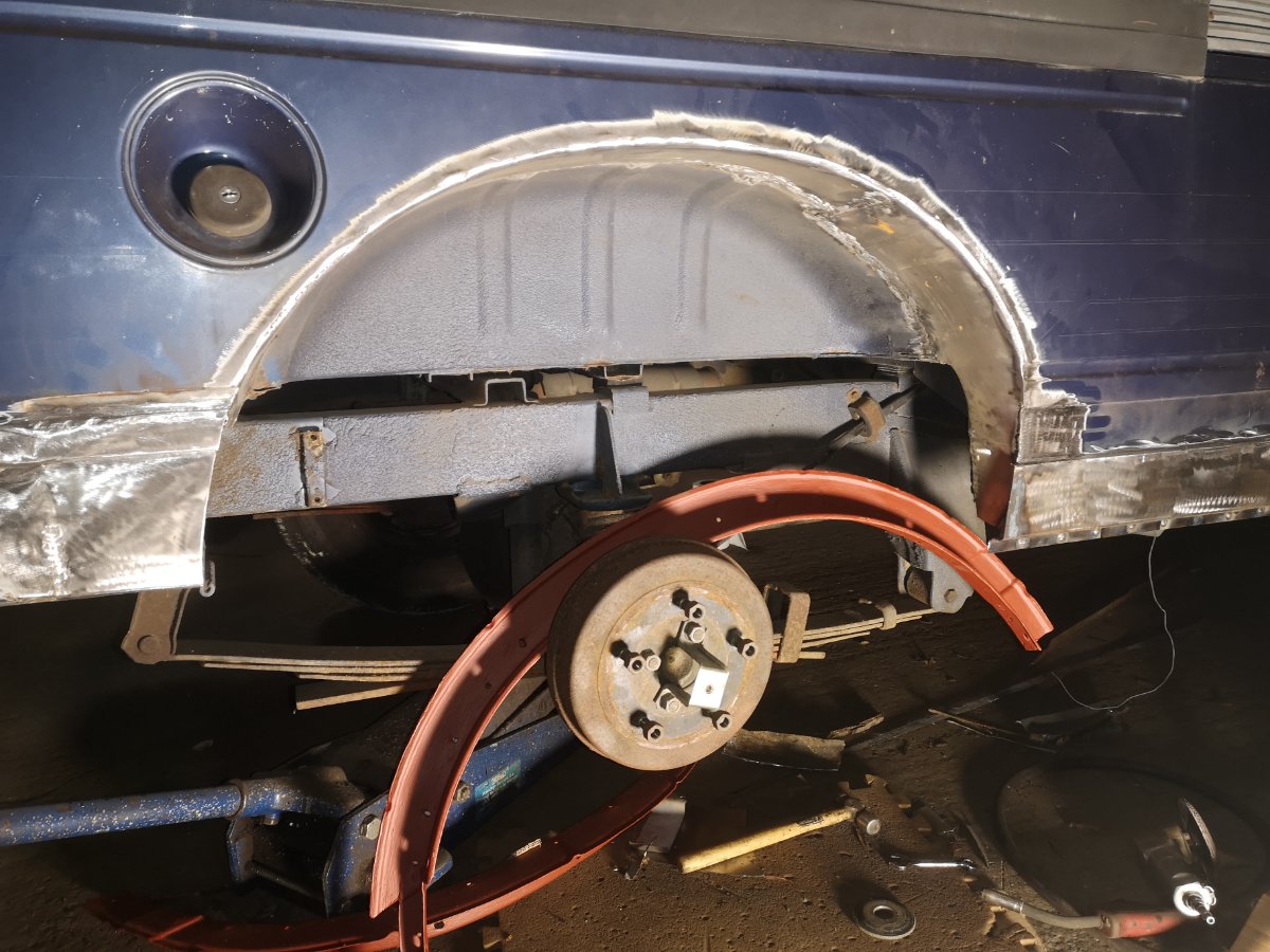

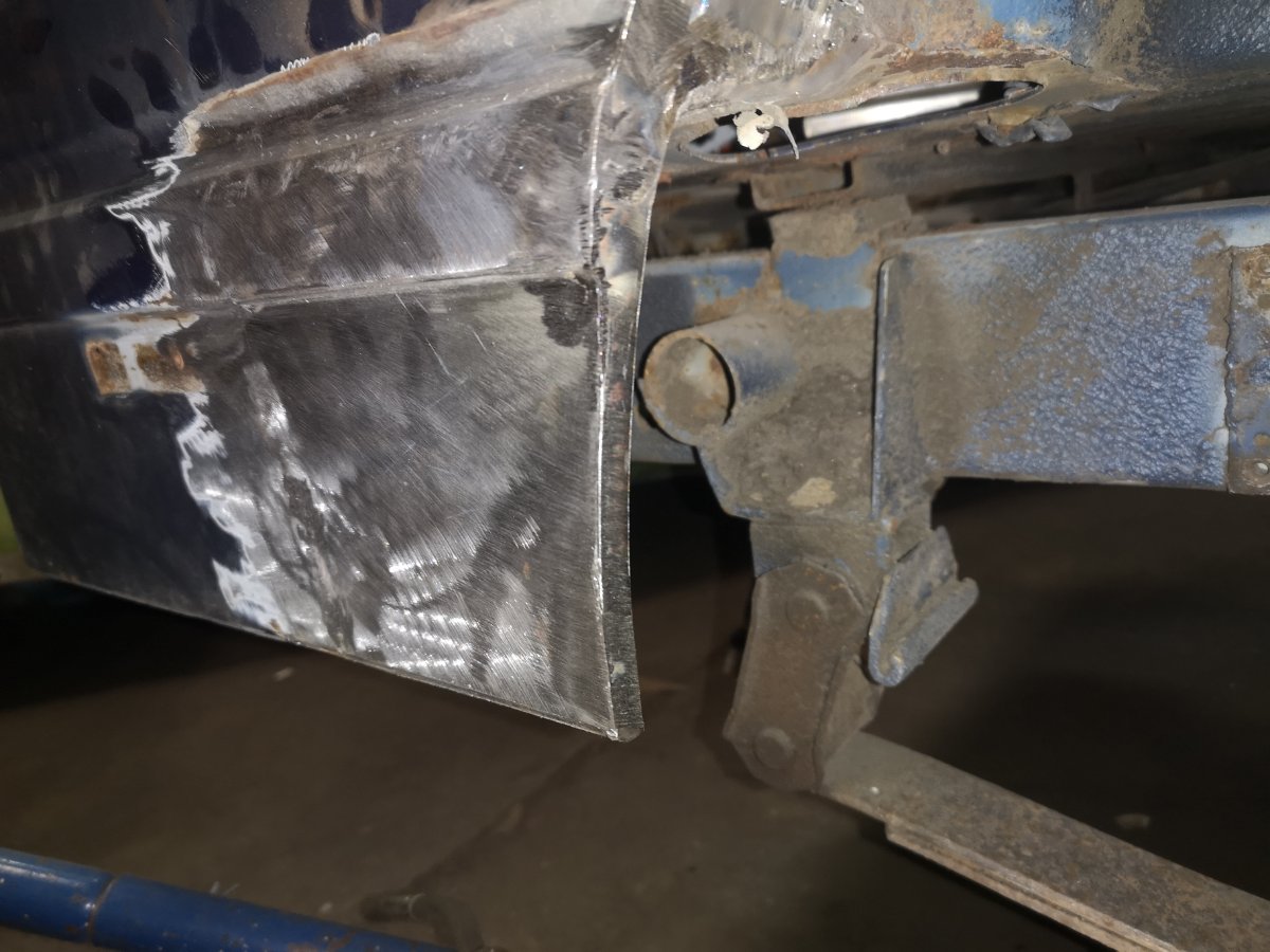

The guy did a excellent job for our tight budget and the limited material left. He tugged the rear arches to remove the corroded areas and added brackets to allow the standard arches to fit still. Enough material was left to ensure the arches still look stock but in reality are floating. The rear quarters also don't have all the creases of a diy so it should come out nice. I have all the gear but im no finish painter so we shall see
I very picky with my work so im taking it back to bare again on welded areas before paint. I really should have given him corrosion inhibitor instead of epoxy primer so i could remove it all back to bare in my heated workshop easily.

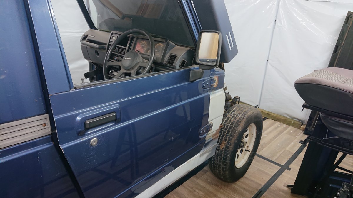

Im in the midst of setting up my own blasting business so have all levels of gear around for the job. Ive also had especially built a nice 6mx4m workshop in the garden so it can get a decent paint at home. I looked at pop up tents initially but read the horror stories and condensation issues.

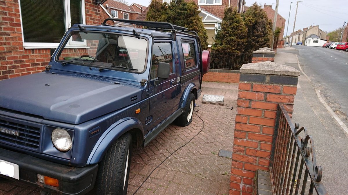

Its going to be our daily 4x4 and hopefully as nice to drive as my last one was once sorted
Anyway ill get some pictures up soon and keep taking as i go. I want Sid on the road for January ideally
