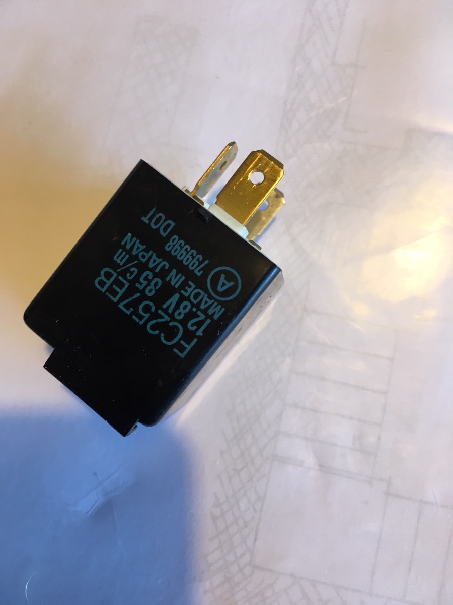

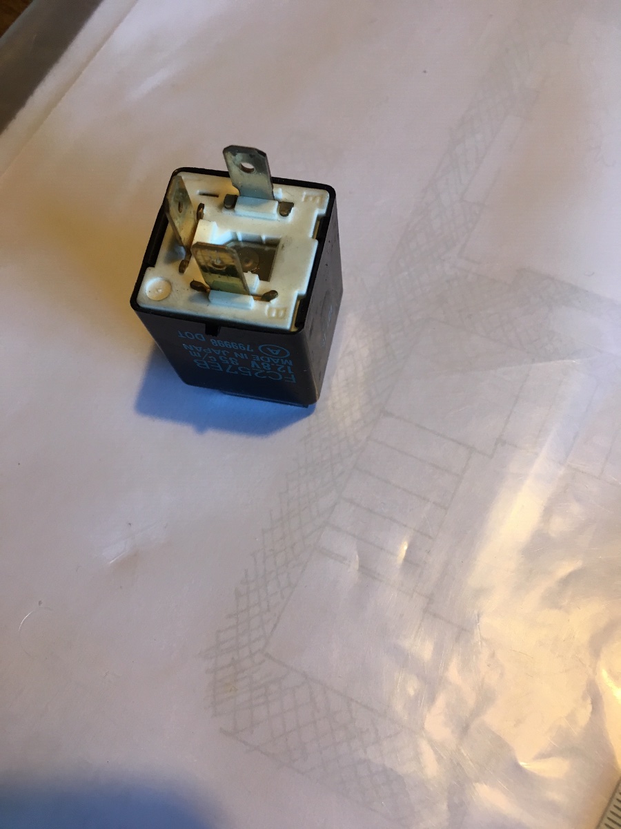

Re: Indicator Relay
I pulled this out late yesterday, sits just above the regulator.
![Image]()
![Image]()
![Image]()
Let me know if it looks the part, if so private message your address and I will pop it in the post.
Re: Indicator Relay
That's great mate Will send you my address let me know how Much, Thanks Very Much
