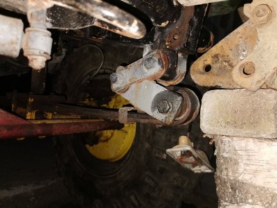

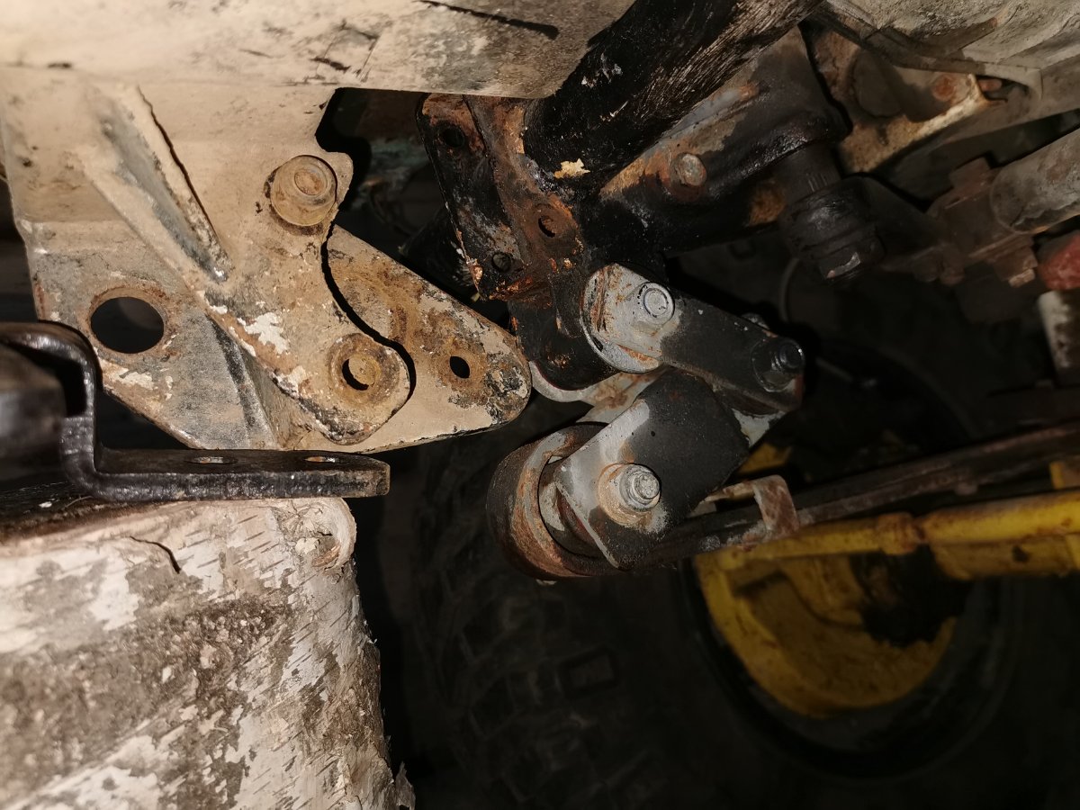

Just a Quick Question. Are these Shackles Normal ? Or should / Can they be adjusted ?? Thanks
Posts: 7535
Re: Shackles
Post by Jordi » Fri Nov 06, 2020 6:20 pm
They are an aftermarket shackle.
Designed to give more flex.
General opinion of most of us is they cause additional axle wobble on the road, if over stretched can fold back the wrong way or jam (yes it happens, i have a similar setup but bolted in a fixed position).
When they droop down you don’t really gain any additional traction as the wheel just hangs, no weight pushing it down.
Remove, swap for standard shackles.

Thanks Mate, will see how it drives on the road first then take it from there, just thought they looked a bit odd.

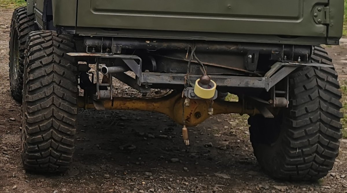

Here is the Back they look different to front.
Posts: 7535
Re: Shackles
Post by Jordi » Fri Nov 06, 2020 7:41 pm
The back are again custom / aftermarket.
Just a longer version of a standard shackle. Depending on how much longer depends on how they affect the suspension and driveline angles.
Originally all 4 shackles would’ve been the same as those in my pic.
