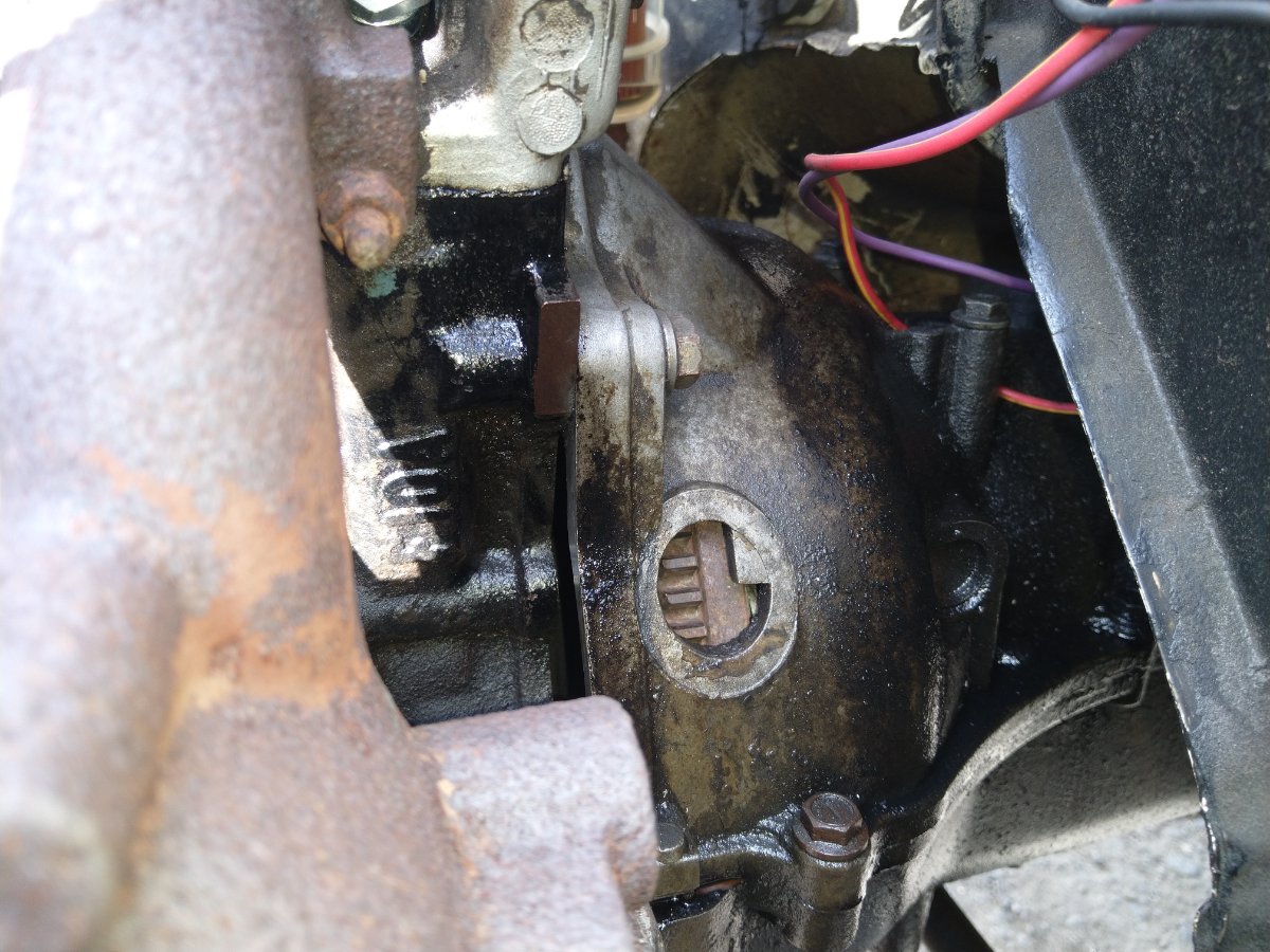

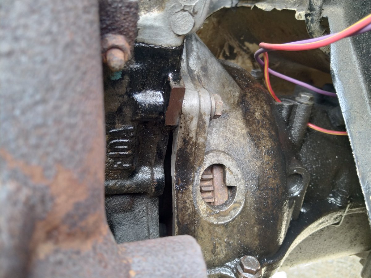

SJ 410 Well the bloddy thing has ran great for months now, but just started loosing oil and chucking blue smoke from exhaust, seems to use more petrol too.
Not sure where oil is leaking from but it seems to be falling on the back of gearbox in pics.
Any Ideas.
Thanks

Could be the distributor oil seal, a common failing. Also I'd get rid of the K&N and put on a genuine Suzuki filter.

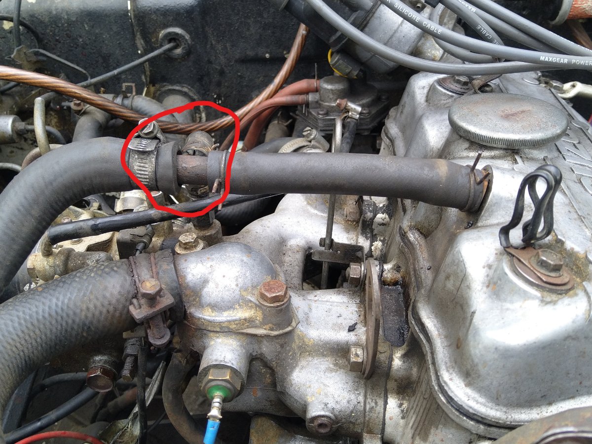

border
Posts: 184
Re: Trouble
Post by border » Tue Aug 10, 2021 8:36 pm
Couldnt find ant breather as such but after a bit of googling assumed this is what it is, or am I wrong, pipe circled in pic, It was full of gink so gave it a good clean. Its a little better but still chucking smoke out on acceleration. no blow back or smoke with filer cap off though.
