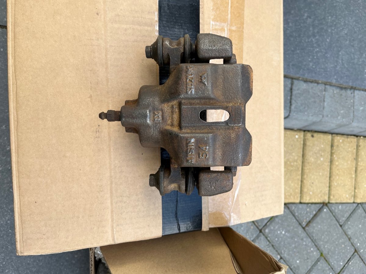

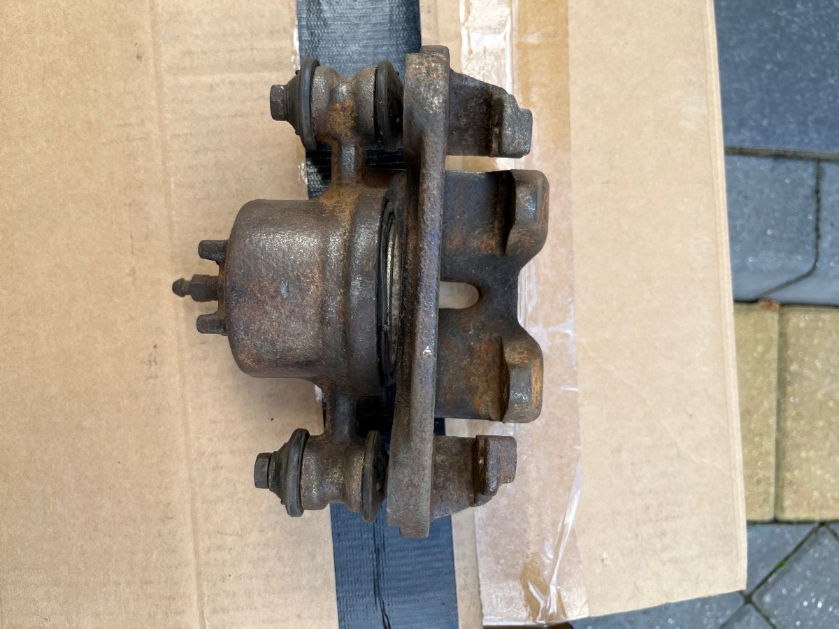

Hi, Just reading up on the problem you had regarding brakes. I have a SJ413 with rear disks fitted by the recently previous owner, so taking stock of what to do at the moment. I have 2 used calipers to fit to the rear disks and I'm not sure what vehicle they came off. So I need to fit the calipers and sort out a handbrake. Any advice would be appreciated. Images show my calipers.

Standard aisin calipers off a Japanese SJ i think.
If not already fitted you may need to swap to a transmission handbrake.
