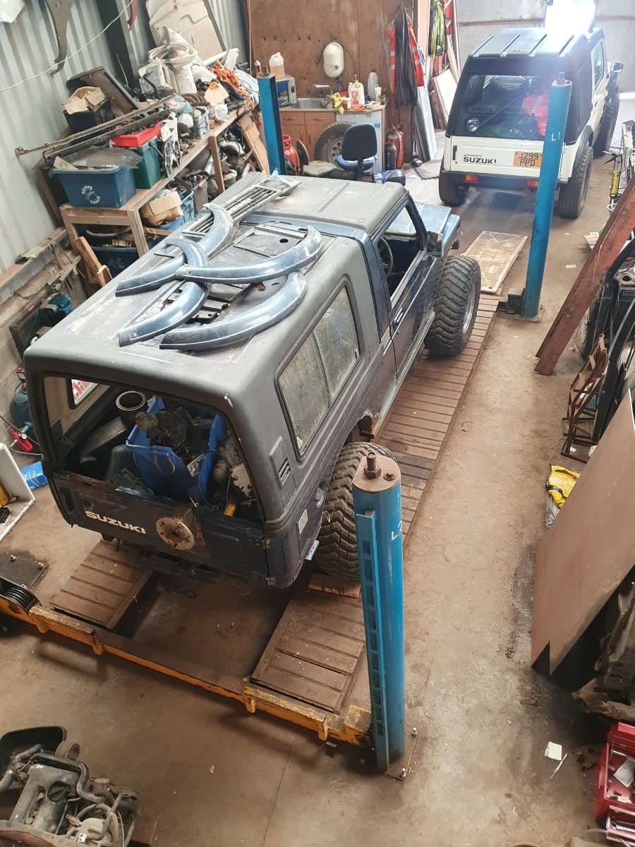

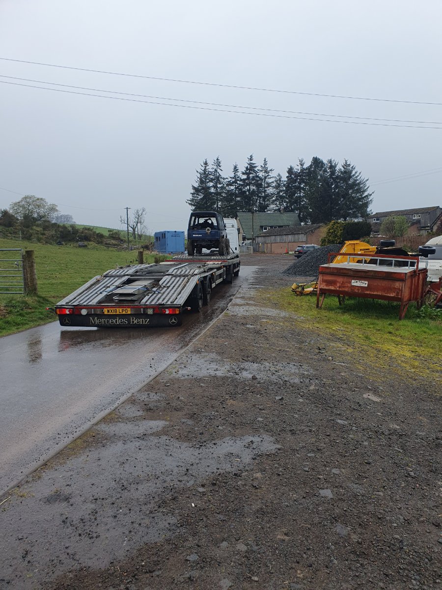

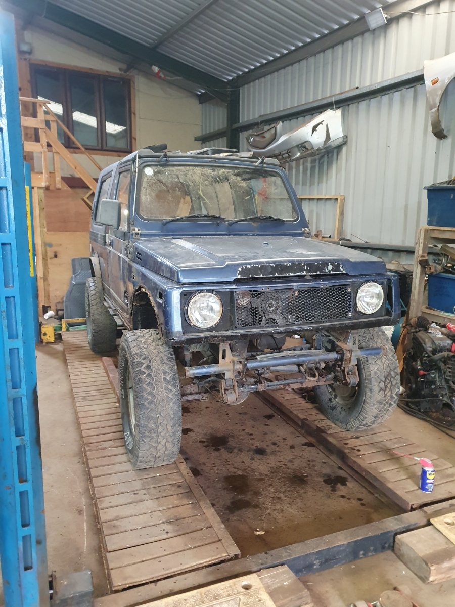

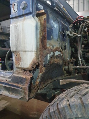

Good morning everyone, I've been after a long wheelbase for a while now and luckily Mike managed to sort me out with one.

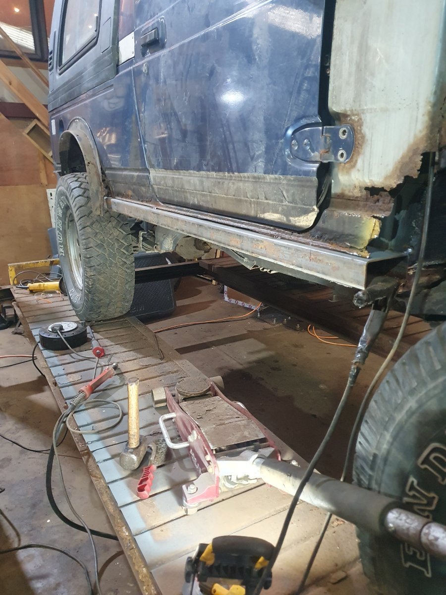

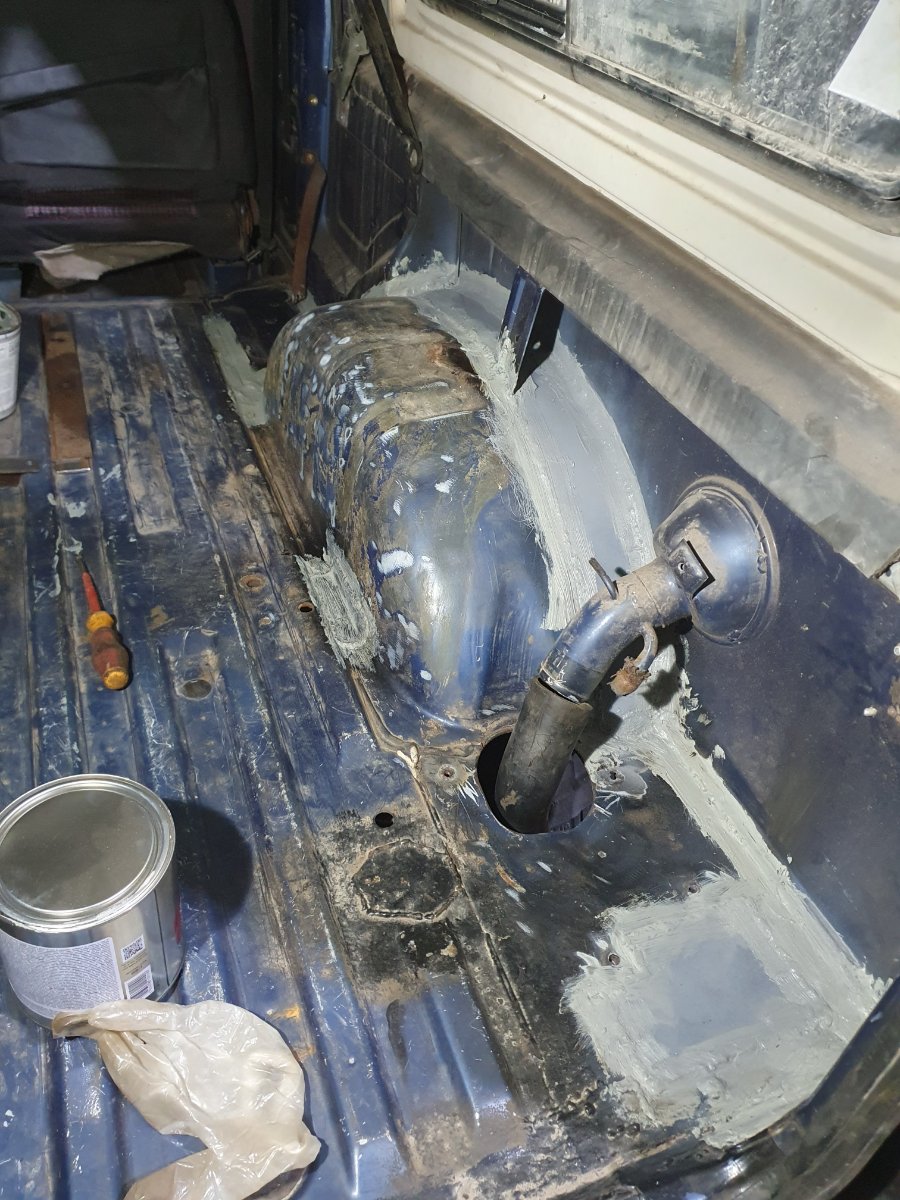

It arrives Thursday and the wife's been away since Saturday morning so I've had a good stint on it already. Sadly the welder packed in last night when I got to the rear arch.

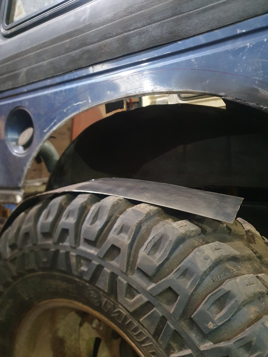

Managed to get the new 50x100 sill on and the front arch tubbed before hand tho.

Made it in safe hands though. The delivery guy was brand new.

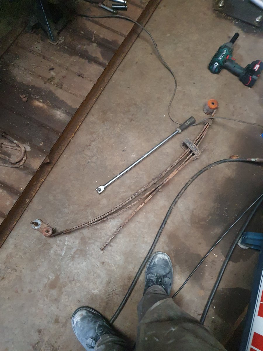

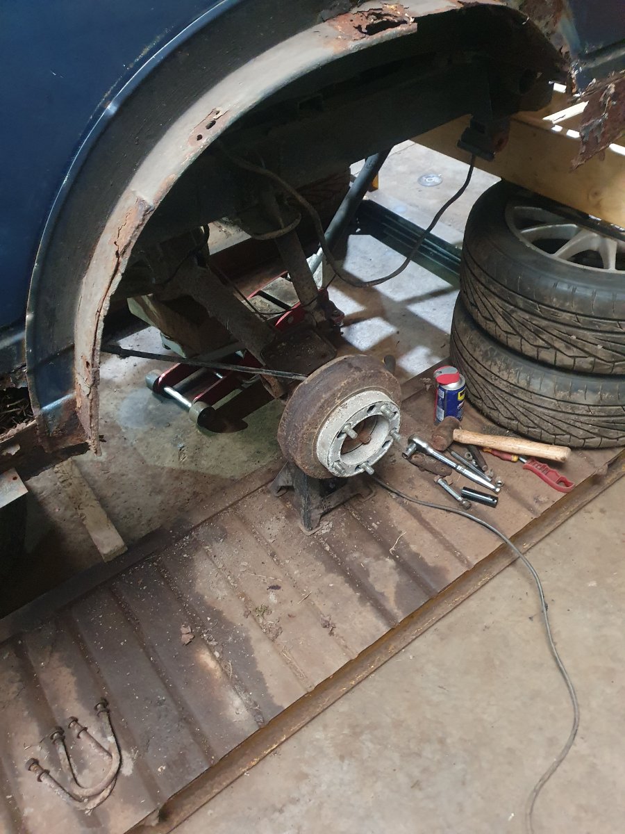

Managed to get 2 hours up the garage today. Got the rear shock and leafs off today without snapping anything thing. Glad as its the first time I've had a sj without any snapped shock mounts (so far)
Next time I'm up I'll be stripping the rear of the white one to get parts swapped over. One of my friends is hopefully gonna buy the white one for his Mrs, he'd planned to build her one but dosent have the time.

Since I last posted Ive got all the suspension and wheels swapped over. Fitted a break servo from my old nissan primera that I recently scrapped but haven't plumbed it up yet.

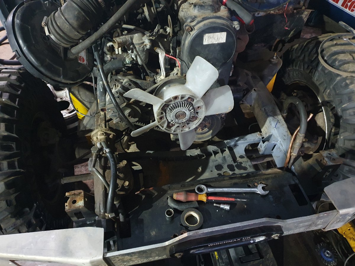

Dashboard is back in, most connections are back together still some stuff under the dash to connect up, also need to remove the loom thats been added for a rear wiper.
Today I got all the plumbing connected up around engine but then removed the radiator so I could get the lines in for the power steering. Next job will be notching the front chassis leg fot the power steering to clear, have also left got a new crankshaft pulley to allow me to run powersteering on the 1.3

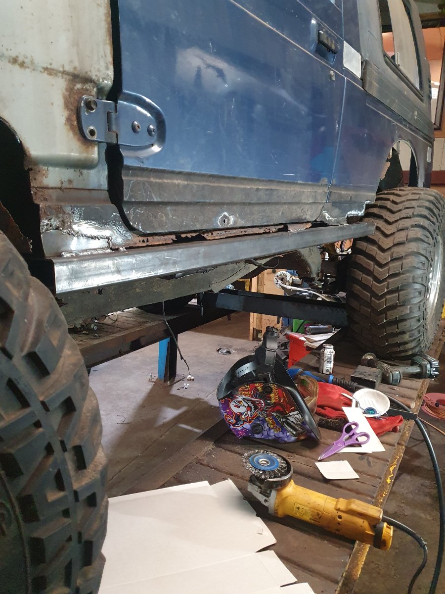

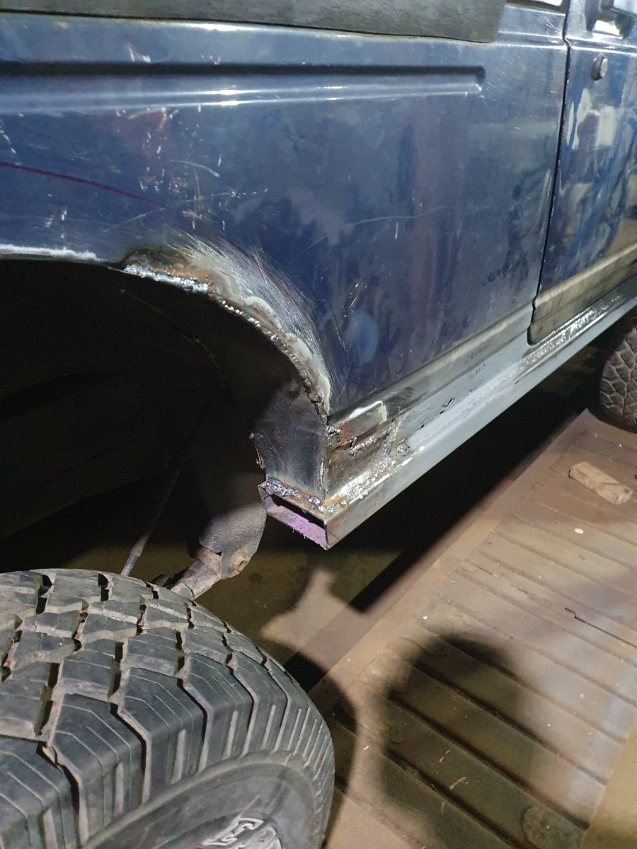

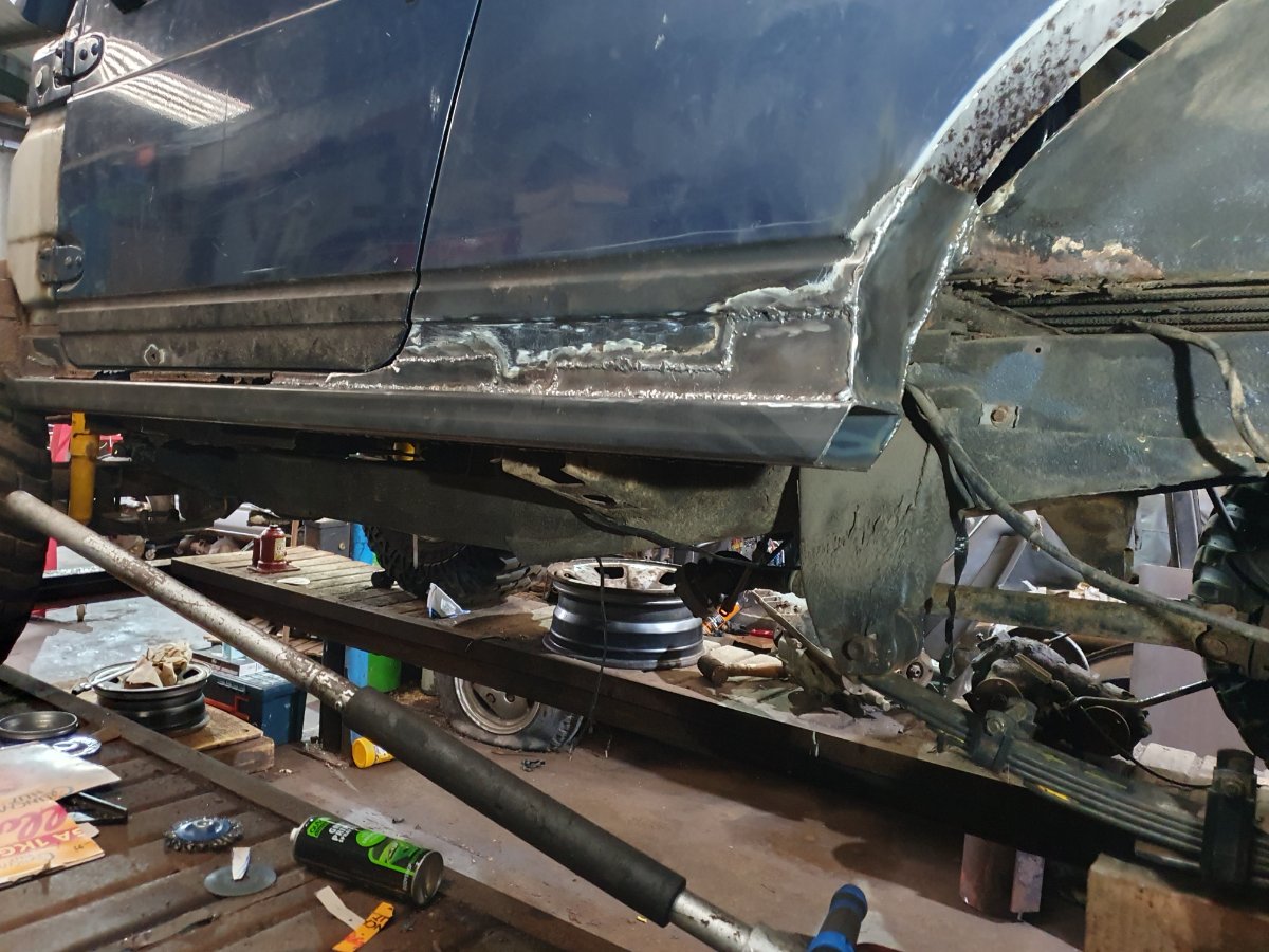

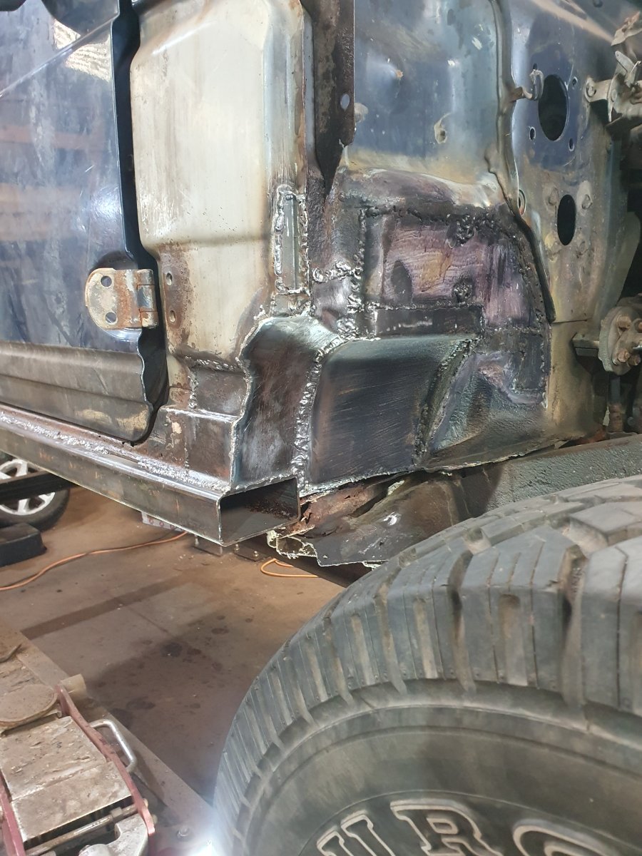

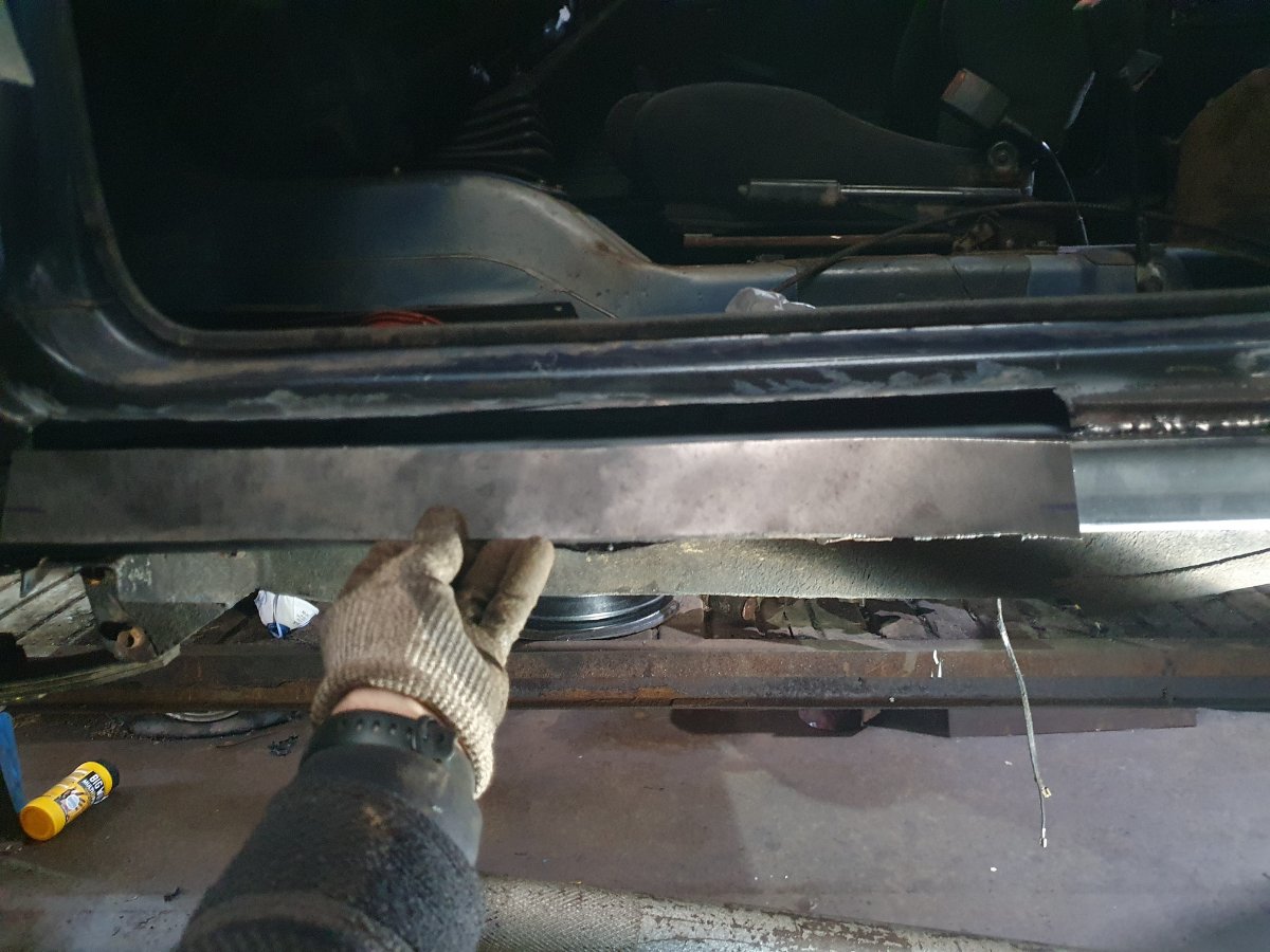

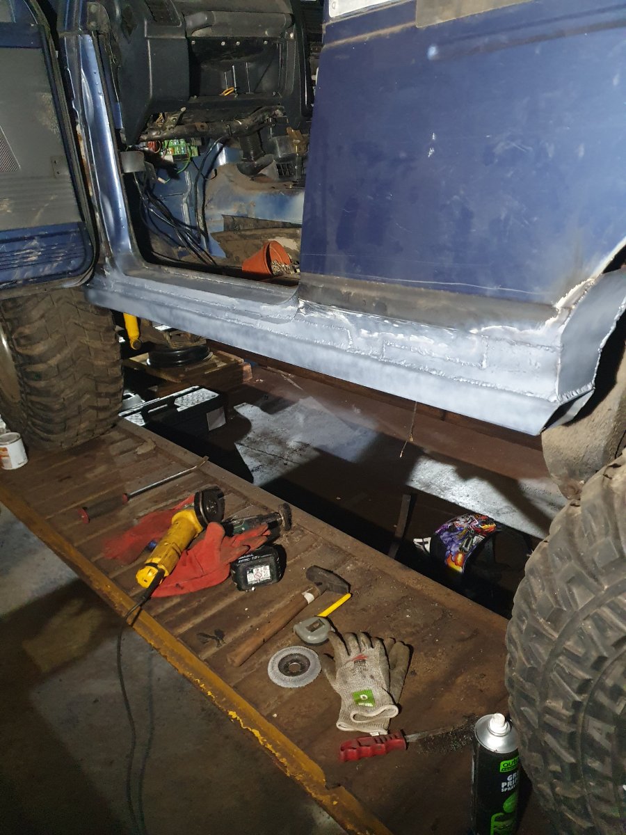

One side pretty much done, just bodymount under pedals to sort, but will get them when have both sille on so can lift it of chassis for access.

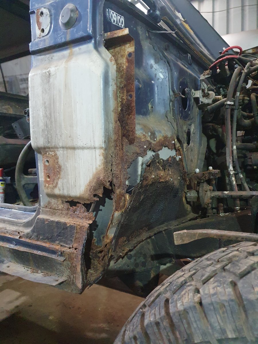

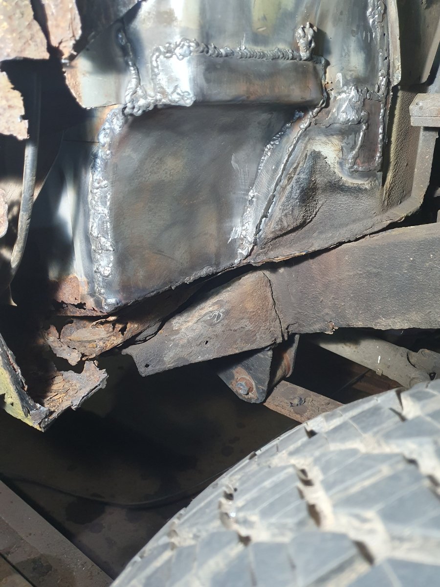

Passenger side is cut out from the rear arch forward still to attack the bulkhead. Flipped the seat brackets back over and made some better bases for them that fit the standard mounting holes.

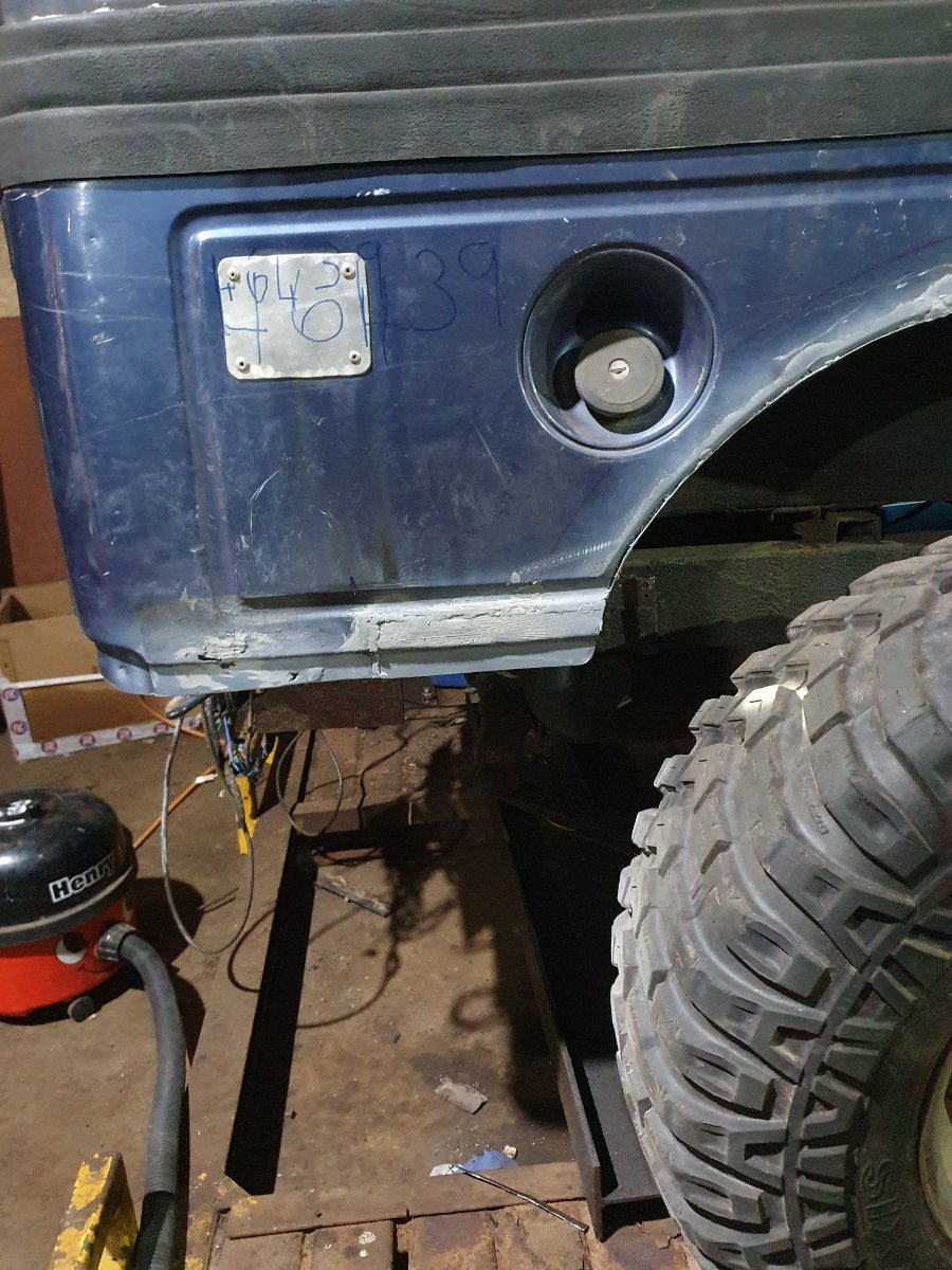

Post by Rankine » Wed Nov 22, 2023 5:57 pm
Another day of welding, slow progress but its getting there.
Not sure whether to tackle the rear or bulked next will see how feel in morning.
