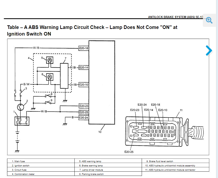

I have an ABS and service brake light stuck on, upon connecting OBD tool ( Icarsoft) I have the error 'DTC c1063 Solenoid Valve relay Malfunction' . After searching the interwebs , it appears this error code is an electrical issue within/ or connecting to the ABS pump .
Before I get to work switching the pump , I would like to probe the pins on the connection terminal , such as checking for voltage on the wheel sensors (while spinning the wheels) , voltage from the ABS fuse , ground pin to ground ( you get the idea) . So i am looking for a pinout electrical diagram that shows what each pin leads to .
I found this image for another suzuki vehicle to give an idea what I am looking for .. Though this likely isn't the same for the Wagon/Agila I have
