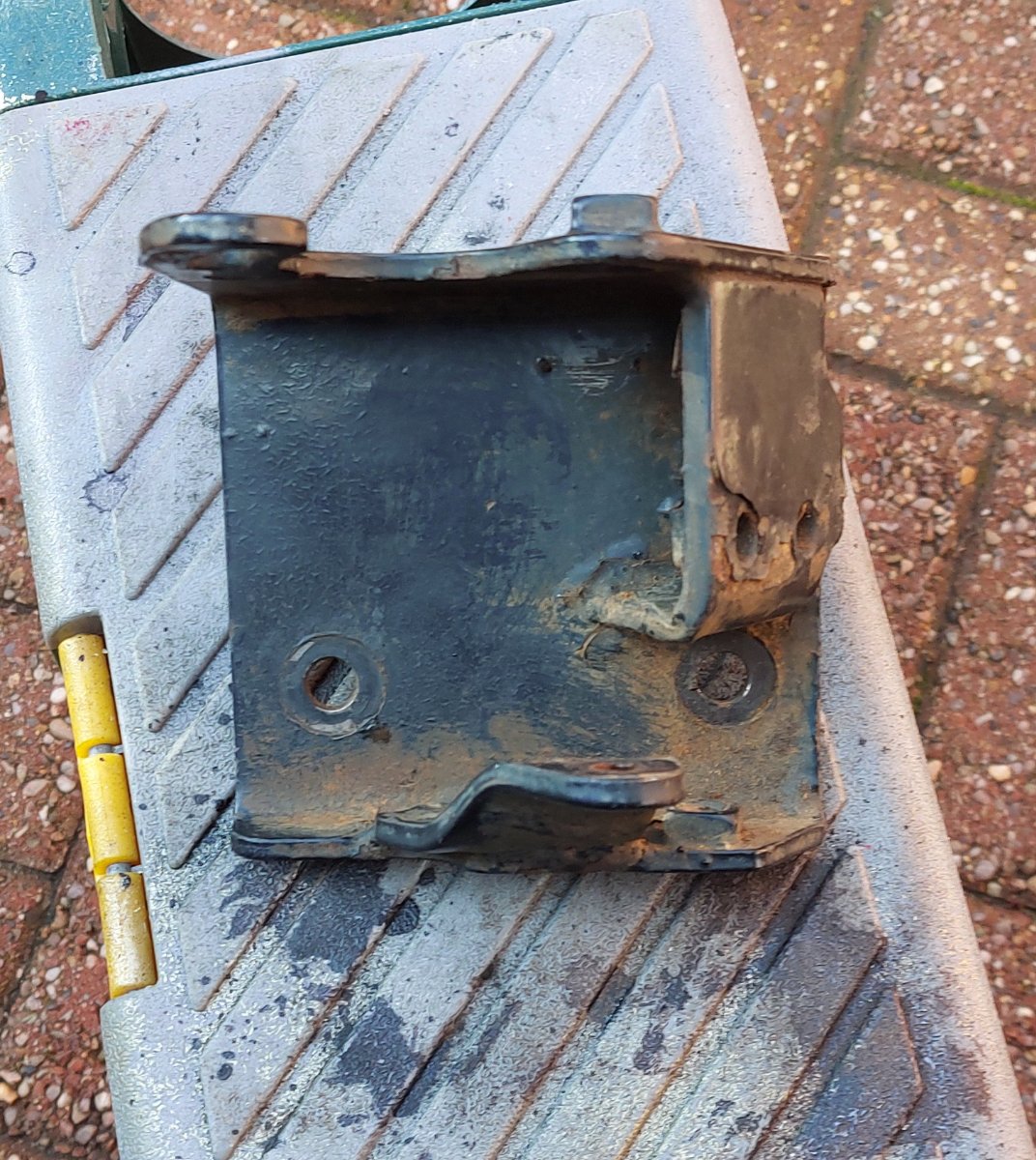

I purchased this bracket, from a Vitara I believe, to find centre to centre of holes is some 20mm different to fixing holes on block.
My logic suggests I should line up the centres of the crankshaft pulley and pump pulley, see how the holes relate and drill new holes if necessary.
Can anyone offer comments on that approach?

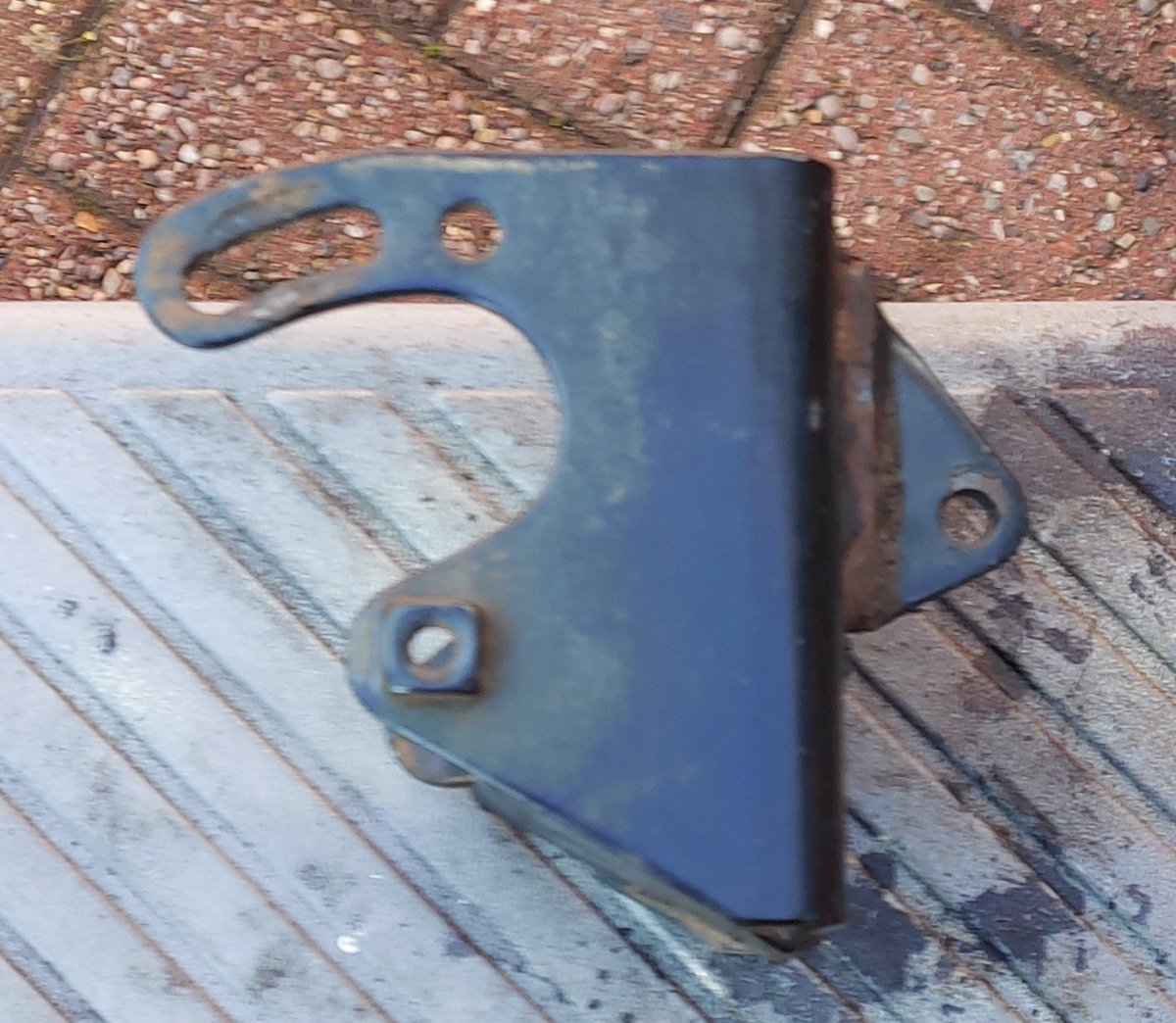

Have drilled a 10mm hole 60mm from the top one and given the bracket some paint.
Should fit now.
