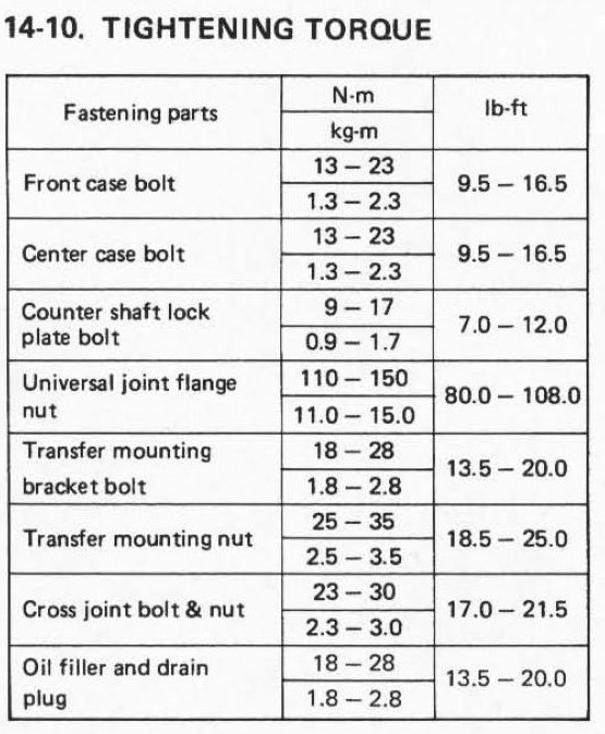

Hi,
Does anyone know the torque settings for all the bolts in the transfer case and the flange nuts?

Post by Darrell » Fri Mar 11, 2011 3:47 pm
Someone called :D
Re: torque settings for transfer case
Post by Darrell » Fri Mar 11, 2011 3:57 pm
In fact - why not have the whole section :thumbup:
http://www.suzuki4x4.net/manual/sj/chapter14.pdf" onclick="window.open(this.href);return false;

Post by Jumpinjacks » Fri Mar 11, 2011 4:01 pm
Perfect, Darrell your a legend :rockin: . Thanks alot for that
