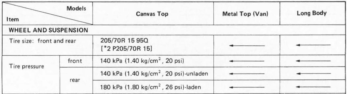

What pressure should the tyres be on standard suzuki rims?
Mine were all low so I pumped them up to 32psi and they are now all pretty hard and seem to give a harsh ride when driving over bumps :poke:

Here you go

Thank you! So thats 20psi all round?
Re: Pressure
Post by twiss » Mon Mar 14, 2011 10:43 pm
Yup... If I'm going on a long motorway journey I tend to pump them up to 28-30. Saves a bit of fuel ;)
