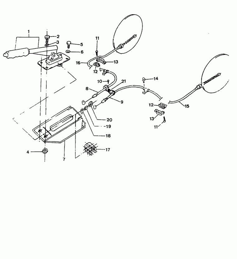

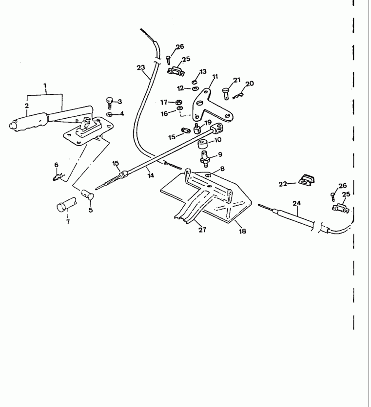

Not much help as I've not done the job, but I've found a few diagrams of different types and assume they need the mechanism as diagram 2.
I have the transfer drum using diagram 3 so have no pictures to help. Which version of cable do you have now......

looking at the diagrams your lever (in cab) may well do the job (be the same) but underneath is different for a twin cable setup . It looks like it has a box which the two cables are inserted into, then a link bar from the two cables to the lever. I assume you really just want a handbrake lever assembly from another SJ that has the twin cable arrangement.

EXCELLENTDarrell wrote:looking at the diagrams your lever (in cab) may well do the job (be the same) but underneath is different for a twin cable setup . It looks like it has a box which the two cables are inserted into, then a link bar from the two cables to the lever. I assume you really just want a handbrake lever assembly from another SJ that has the twin cable arrangement.
progress!!
