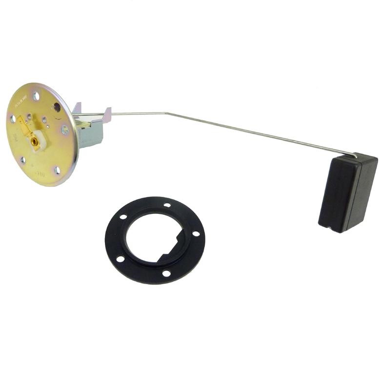

Just out of interest, where did you find the jimny ones for sale. I thought they are a complete pump/sender/filter unit on those.
I only know of 2 senders for the sj, one with just the 1 connection (part No 34810-80001) and the other with 3 because it has a low level indicator (never seen a pic or part No).

Not sure on the Jimny sender im afraid mate but do have a brand new genuine Sj Sender still in its box which type is yours? the clip in type or the one with 6 retaining screws?
