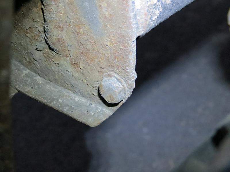

When I first got my sj I fitted 215r15 tyres with no lift and they rubbed on the front bumper mounting plates, however I just cut/ground the plate back to near the nut and bolt & they just missed. Just give it a good check before driving very far as this edge may cut into the tyre. They only rubbed with quite a bit of lock on.
Didn't need much cutting
