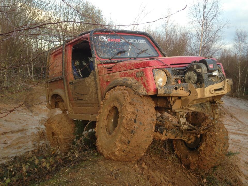

- mike harris
- SCUK is my life
- Posts: 1829
- Location: hascombe Surrey
Re: What would you do???
Now don't get me wrong I've broken some suzuki axle parts, but I run boggers.
Depends how you drive and gearing ect.
These are close to 34 and are 13 wide ish, I've always thought about yota axles, land rover ect, but have you ever tried to lift a yota / lr axle?! You can't. Sj axle I can compLete !!
The mods are there to make them strong, solid crush collars, uprated shafts, fully floating back axles, axle trussing. It all works trust me .....
