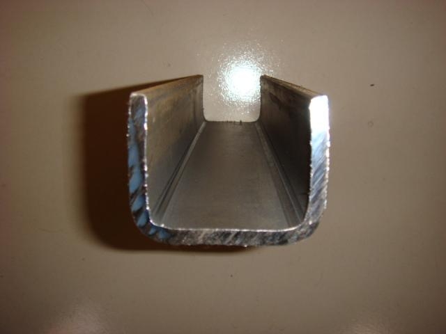

Jordi chears also what you mean u shape
Do I need to cut the spreader plate as a shape of a U so it is welded to the chassis in the middle aswell if you understand
Re: rock sliders ideas
Posted: Wed Jan 01, 2014 9:24 pm
by turbo-tom
"U" section metal.
Posted: Wed Jan 01, 2014 9:27 pm
by Jordi
Same as in Tom's picture. Instead of just welding a plate to the side of the chassis it will wrap around it, nice and strong
