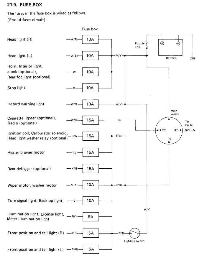

P.s. Darrel, Id appreciate it if you could post a wiring diagram to match the igniton (if you have one?) Thanks
Re: Ignition barrel Strip down
Post by Darrell » Fri Dec 14, 2012 9:45 pm
My wiring diagrams don't match the wire colours I'm afraid :er:
ign sw.JPG (15.54 KiB) Viewed 6501 times
Post by Tramp » Fri Dec 14, 2012 9:49 pm
That's fine darrell, ill continuity test it and write the colours down..... well I will for connections that have coloured wires!
