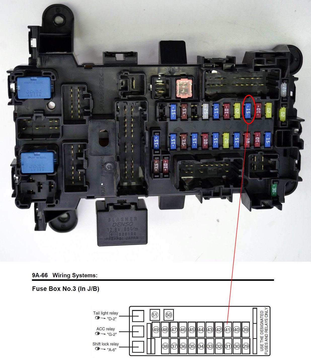

im new to this so please be gentle lol not even sure if its Electrical or not.Anyway not sure in which order but the Radio /clock /lighter have stopped working not sure if they are all connected or not the fuses are all ok so can rule them out.Any ideas would so helpful .Oh by the way its a 2006 Grand vitara 20L Thanks

Double check this fuse as it feeds the Audio/Multi Info Display/Acc relay (No acc relay cuts all aux sockets).
Suzuki GV JB fuse box 3.jpg (257.69 KiB) Viewed 4842 times

Just like to say thank you for helping me sort out my problem it was the cigarette lighter that was the problem all sorted now thankfully
