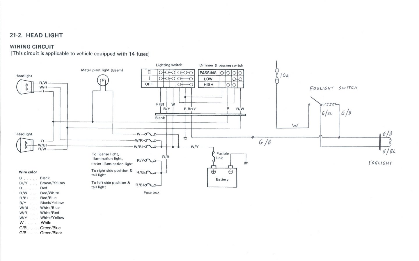

Post by Darrell » Fri Mar 10, 2017 9:19 pm
This help
At the foglight.. Green/blue live with foglight switch on.
Green/black earth when headlights on.
Headlight foglight.jpg (98.26 KiB) Viewed 4932 times

Thanks Darrell,
That might help, I did do a search and found your diagram but i must admit, I'm not much good with electrics and diagrams but I'm hoping my dad might help me tomorrow with a multi meter.

I managed to get the fog lights working momentarily, the green/black wired had corroded at the connection end so put a new connector on and connected it back up and they worked,
I then turned all lights off, fitted the fog light covers back on and went to test them again and nothing.. :( and also the light on the fog light switch has gone very very dim, it does light up but very faintly.
Also, when the headlights are either off or only side lights on (I), the green/black wire becomes live but switches to earth when all lights are on (II)
