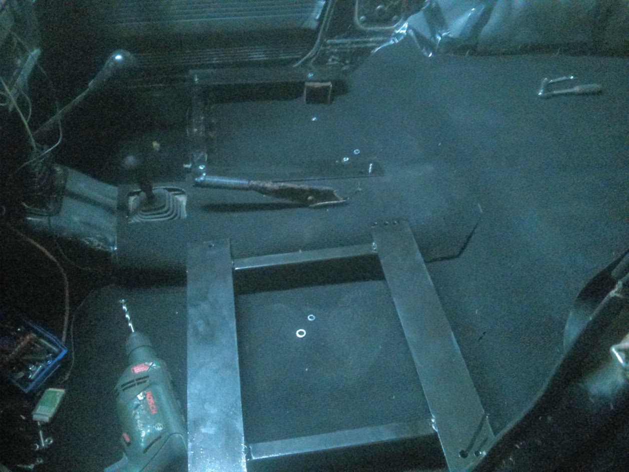

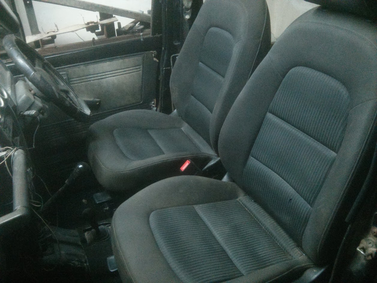

I put Audi A4 seats in mine. The drivers side needed some flat plates as adapters. The passenger side 3x1 box section with some flat plates on top.
I welded them together but you could bolt them easy enough

Old recaros, swift gti and ignis sport seats are easy to fit.
Only issue with the a4 seats is how high you need to mount them, twiss's seats are far too high for me.
