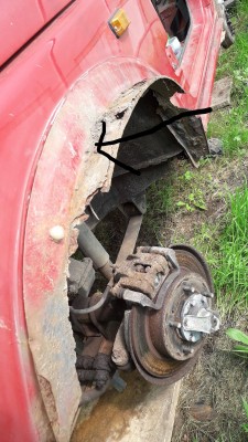

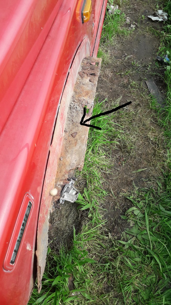

Post by robin b » Wed Apr 17, 2019 1:15 pm
hi can anyone tell me what part this is and if its possible to get replacements thanks
Re: hi from norfolk
Post by ScottieJ » Wed Apr 17, 2019 9:46 pm
unfortunately if the arch lip is that rotten then the main arch behind it is probably not going to be too healthy either.
How good is your welding? if you can weld then it's not too hard to repair, if not then it might be best to buy a whoe new wing but they are quite pricey.
