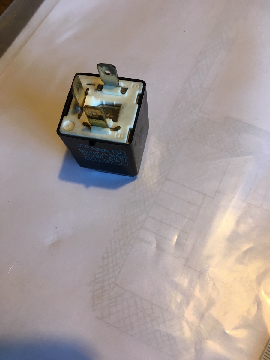

SJ 410. Indicators dont work at all, after reading other posts might be Relay, mines looks to be an after market one, pulled the wires out by mistake and dont know which way the bloody things go back, Im hopeless at Electrics.
Think I need the correct 3 pin relay .
Will a Universal 3 pin be OK ? or would it have to be the correct part for Saxuki SJ ?
Also only got lights on passenger side too, nothing on drivers side,
Thanks

I am no great electrician either, but I do have an SJ 410 (1987) which may still have the indicator unit and right connector on it. I will have a look tomorrow in the daylight.

Post by lundigee » Mon Oct 26, 2020 9:13 am
I pulled this out late yesterday, sits just above the regulator.
Let me know if it looks the part, if so private message your address and I will pop it in the post.

Post by border » Mon Oct 26, 2020 9:35 am
That's great mate Will send you my address let me know how Much, Thanks Very Much

Post by ScottieJ » Tue Oct 27, 2020 10:18 pm
Is your SJ Spanish or Jap? If it’s Spanish is the bottom right screw in the fuse board fitted and tight? The flasher relay earths through that screw so if it’s not fitted then the indicators won’t work.
Also check all fuses, Some Sjs are fused separately for each side.
Check all earth wires as well.

Post by border » Tue Oct 27, 2020 11:17 pm
Thanks Mate, Its Jap, managed to borrow a relay as Lundigee has kindly offered to send me one. plugged it in and they worked straight away, I so pleased about that.
Now trying to get rear lights rigged up.
