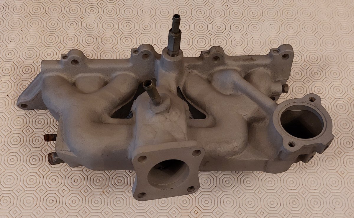

Had a manifold, off a SJ413 / Samurai, adapted to accept a SU HIF44 carb. This was done by Rockwatt Engineering.

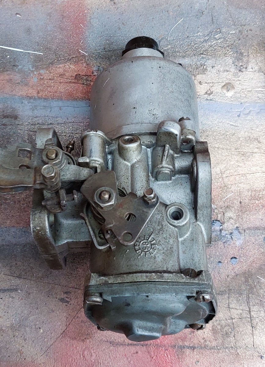

The SU carb I am planning to have reconditioned and fit.
Am using Carb Exchange at Leighton Buzzard for the reconditioning work. Have used them in the past with excellent results. Drawback is 9 week time period. They must have a long Xmas & New Year!!

Is that a HIF38? You need the HIF44 for a 1.3/1.6

Sold to me as a 44. It is a 38 now I have checked.
Took the sellers word for it!!
Another search needed.

Shouldn’t be hard for you to sell the 38, they are good on the Sj410 F10a engine 👍
