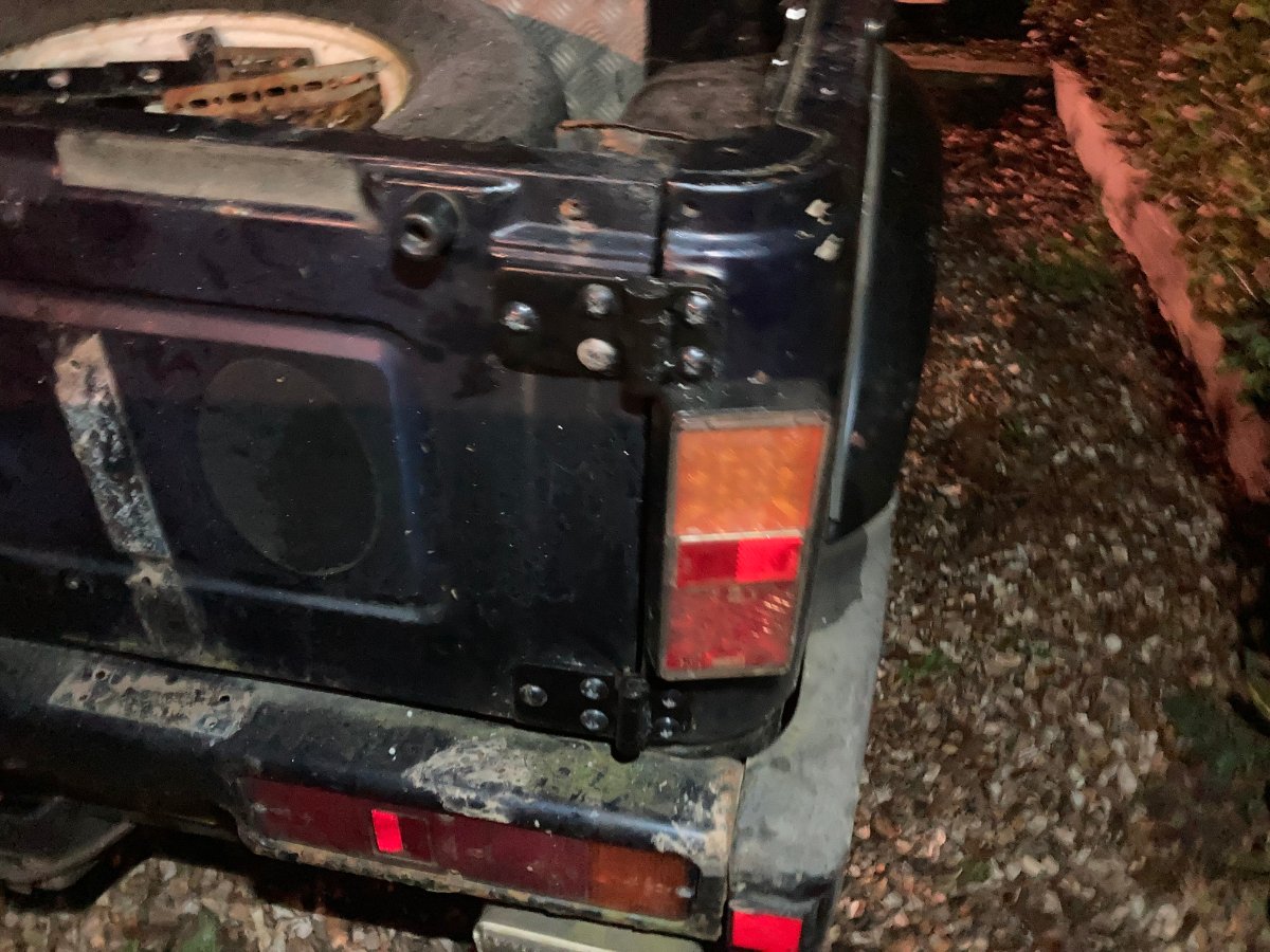

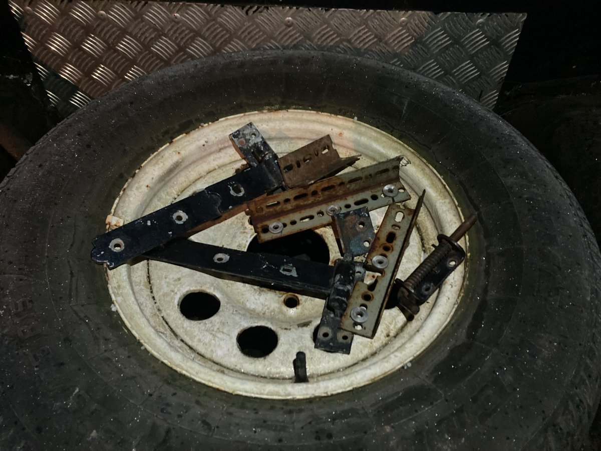

Anyway, today I pulled off the gate hinges that were holding the tailgate to the back bumper. I don't know quite what was holding what up but I suspect the door catch was doing most of the heavy lifting...
Crap photos I'm afraid as I'm working by head torch, but I ordered a set of hinges from India which got here in no time, appear to be galvanised, and pretty decently made. Gave them a quick kiss with the satin black for good luck.
The original hinge bolts, amazingly, all came out without stripping or twisting apart and I've used them for now to hang the door properly. I've ordered a bag of stainless flanged bolts and I'll swap them, and probably the main door hinge bolts as well.
Ol' mate Dave certainly liked his recycled shelving legs, and the rest seems to have come from the hardware store including the gate hinges and the spring loaded catch that was opposite the proper door catch. He also has a thing for the washers you get on self tapping roofing screws with the butyl rubber on the back.
Making an appearance in Dave's repertoire is a new addition, imperial nuts and bolts. I haven't got a great deal of imperial tools but an 11mm more or less did the job.

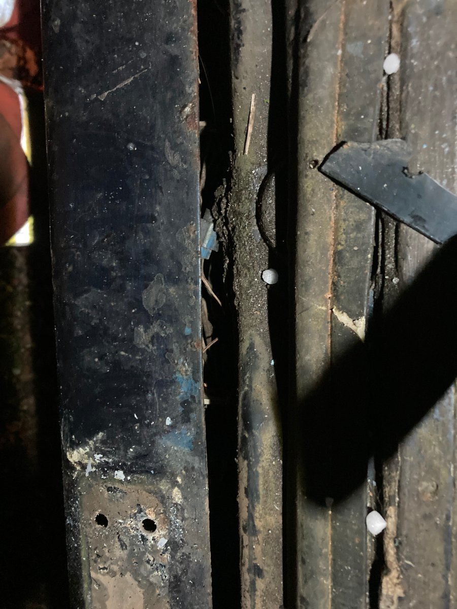

I couldn't help but notice that in the gap between the bed and the bumper there are scotchlocks looming threateningly, wish me luck. :roll:

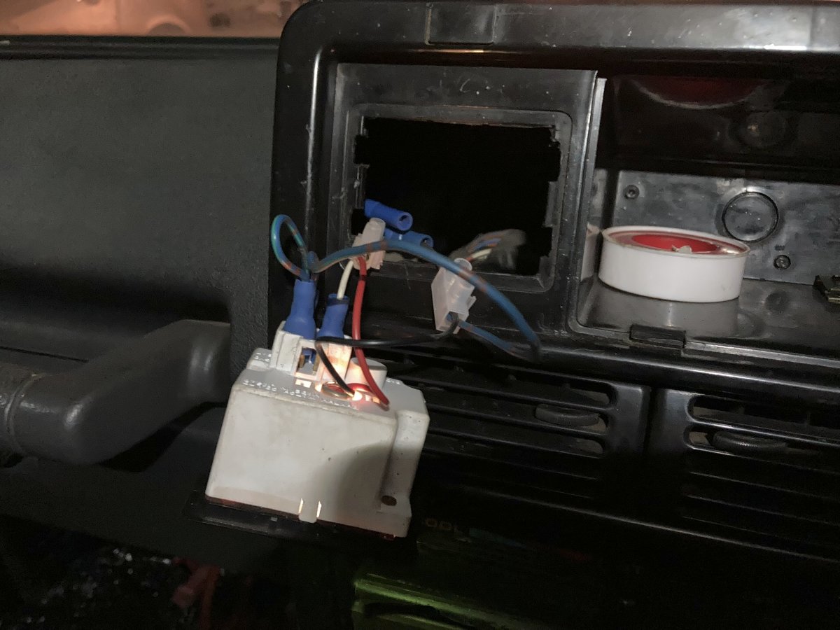

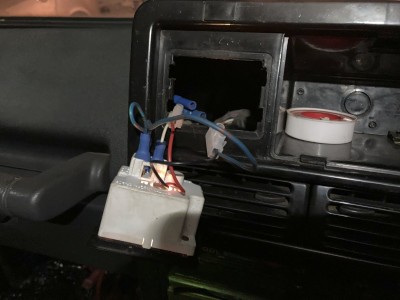

HOW DID HE EVEN MANAGE TO F*** UP THE CLOCK WIRING?!? :shock:

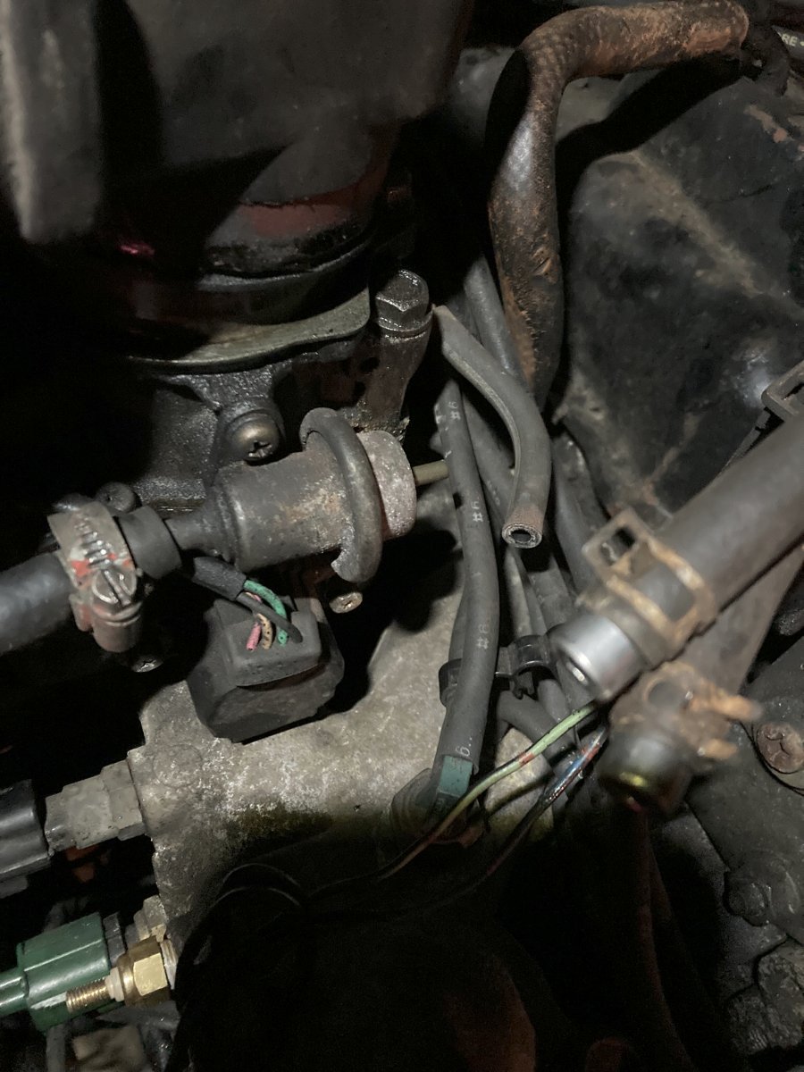

While we're at it, and in the absence of a fuel pressure gauge, I'm not getting anything out of either side of the fuel pressure regulator or any of the hoses, engine on or off, at all.
