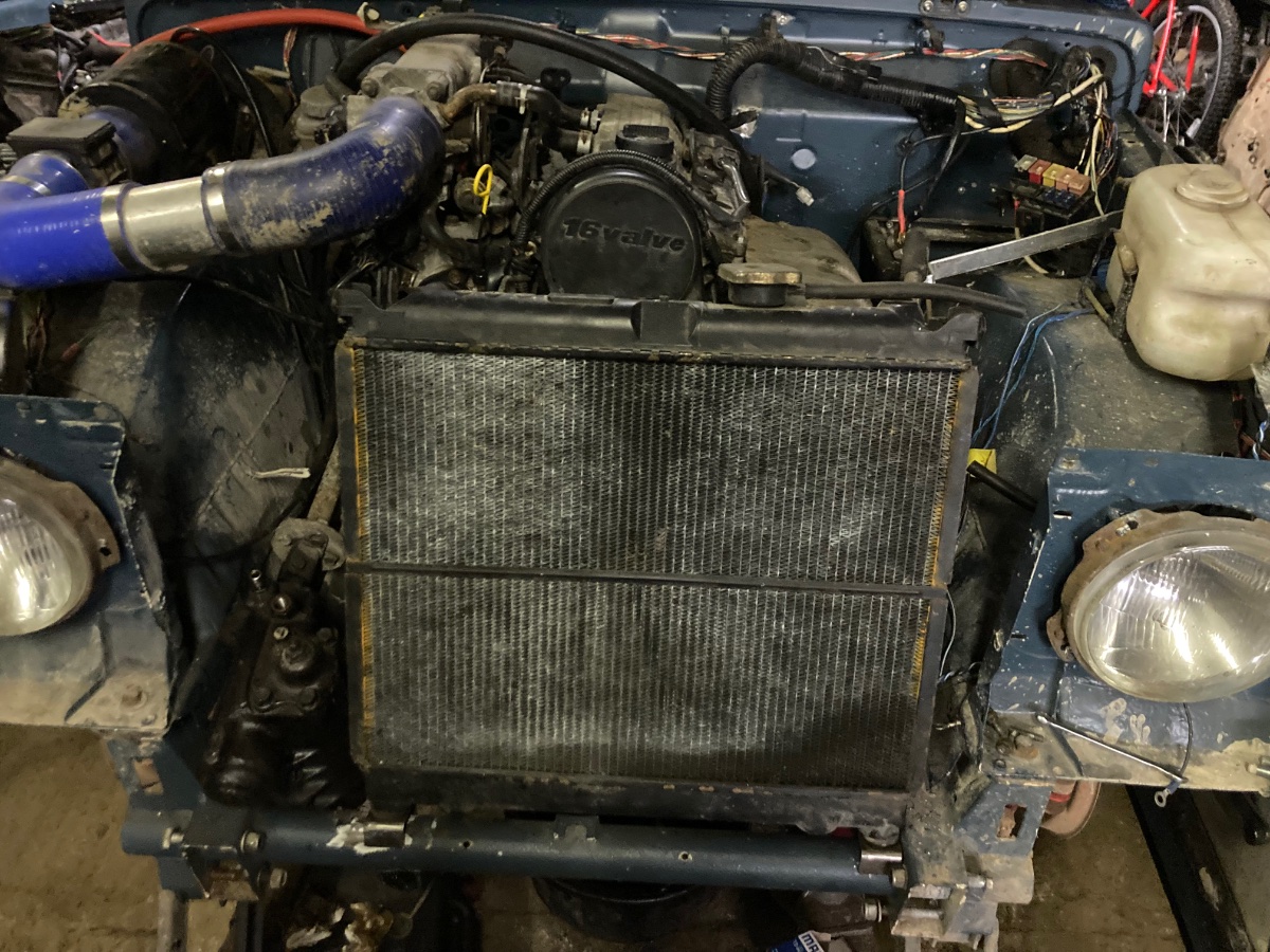

Knocked up some lower mounts for a vit rad, mounted in the same way I did it on blue (not welded on yet)

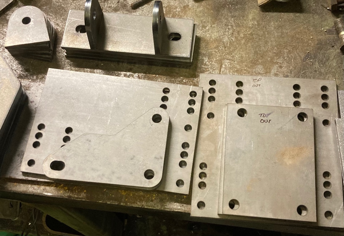

Also I’ve decided to lower the engine and to do this I’ve had some bits cnc laser cut, I’m planning on fabricating stock style mounts but I’m making a jig so I can fab mounts with with various engine height changes.
I also have some other bits cut for making bush style engine mounts for Blue and other future builds as well.
I’m happy to sell kits or even make up engine mount kits for people if there would be any interest in them?
Also have a few other products in the pipeline that might be of interest for those of you that off-road your SJs.

Some nicely cut plates. Would these mounts purely be for the gv 1.6?
Re: Bowser. LWB on 33s
Post by ScottieJ » Thu Mar 27, 2025 4:07 pm
Rankine wrote:
Thu Mar 27, 2025 3:11 pm
The engine plates will fit all G13 and G16 engines 👍 that’s the reason the hole is ovaled on the OS plate. NS bolt pattern is the same on both.

I'd be interested in some bush style ones, especially if could be reused if ever put in a g16
