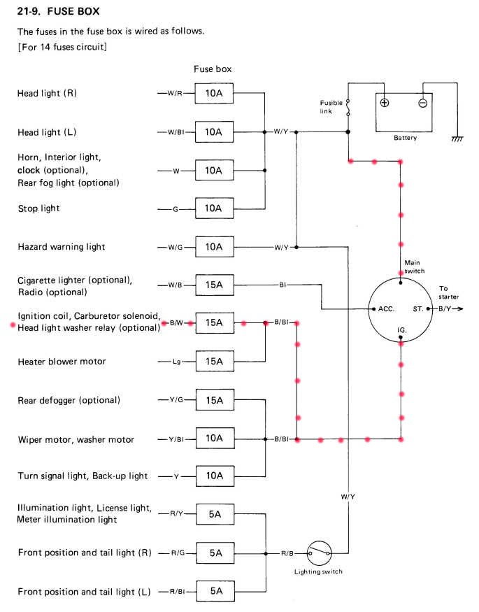

The headlight power supply comes direct from the battery but the ignition circuit goes via the key switch. Best to check for 12v at the coil and then work back from there (assuming it has no power).
Does the heater fan and wipers still go ?
Here's the basic circuit

as Darrell said, it sounds like your ignition switch, whip it off and check for continuity through it in all the different positions
