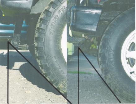

Have a look at the picture below I made up as a comparison of the approach angle, with and without extended shackles - I know one picture is bigger than the other but the angle doesn't change with size. The approach angle on the standard shackles is much better and it is a more capable vehicle with the standard shackles on!
