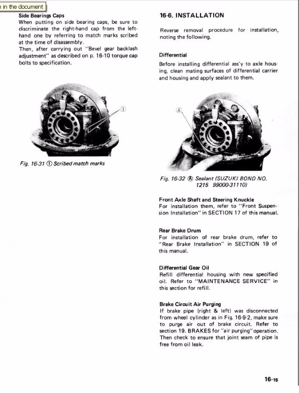

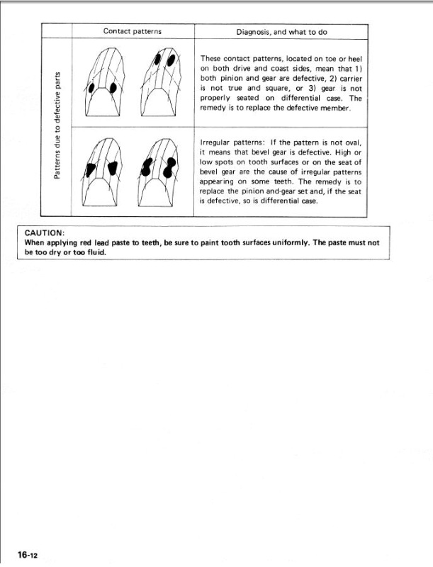

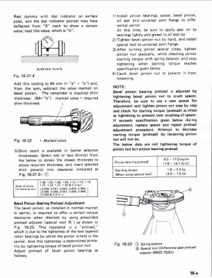

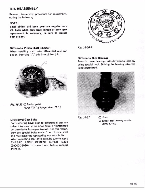

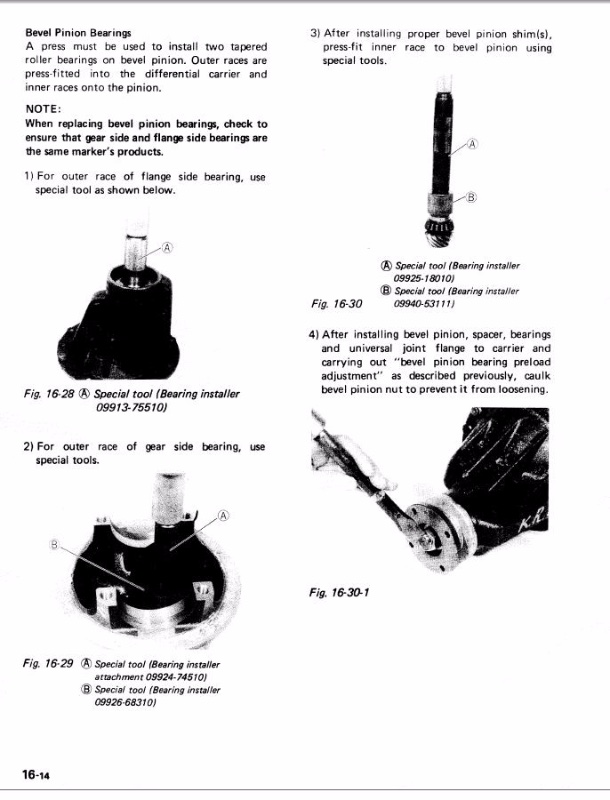

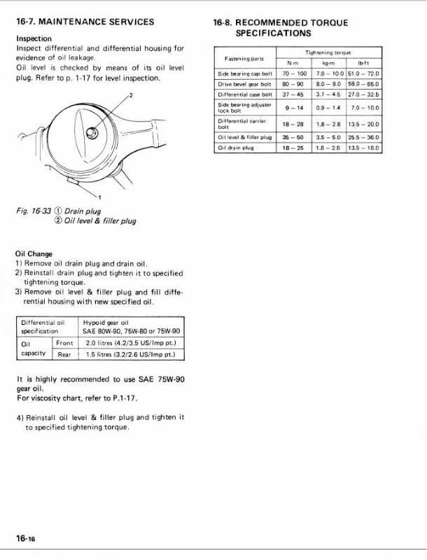

Differentials: Setting up and servicing etc.
Ring Gear Bolts 10 - 10mm bolts
Ring Gear Diameter 6.90 Inches
Pinion Shaft Diameter/Splines 1.379"/26
Pinion Bearing Preload 7.8-14.7 in-lbs
Backlash .004-.006 in.
Ring Gear Torque 58-65 lbs-ft
Carrier Bearing Cap Torque 51-72 lbs-ft
Pinion Nut Torque Zero endplay (crush sleeve)

OK time to be serious.... having been frightened by all the above info (thanks Scottie) do you absolutely need all those special tools (which I don't have) or is there a redneck way of doing this? I really need to sort the backlash in my front diff :-(
Re: Differentials: Setting up and servicing etc.
All you really need is a dial indicator and the spring scale, if you are rebuilding your existing diff then you shouldn't need to worry about setting the pinion depth etc as long as you rebuild it the same as it comes apart.
