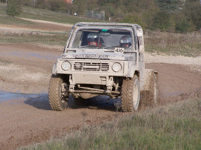

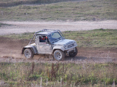

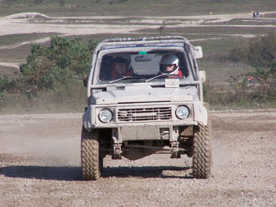

Hope the build goes well. Just a few pics of your old one for inspiration.
