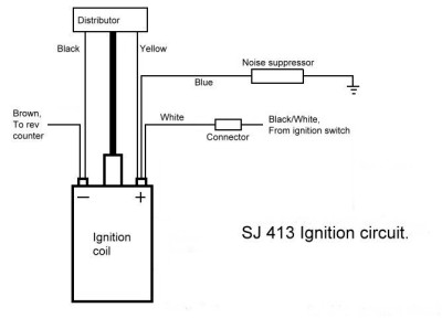

Coil/Dizzy
Make sure you are using a 1.3/1.6 coil. The 410 one with a ballast resistor is not suitable.
From loom the Black/White tracer goes to coil +
Rev counter (brown) if you have one goes to coil-
From dizzy Black/White tracer goes to coil+
From dizzy Brown/White tracer goes to coil-
Brown and Black/Green tracer from loom doesn't need to connect to anything at this end.
It’s wired up the same as a 1.3

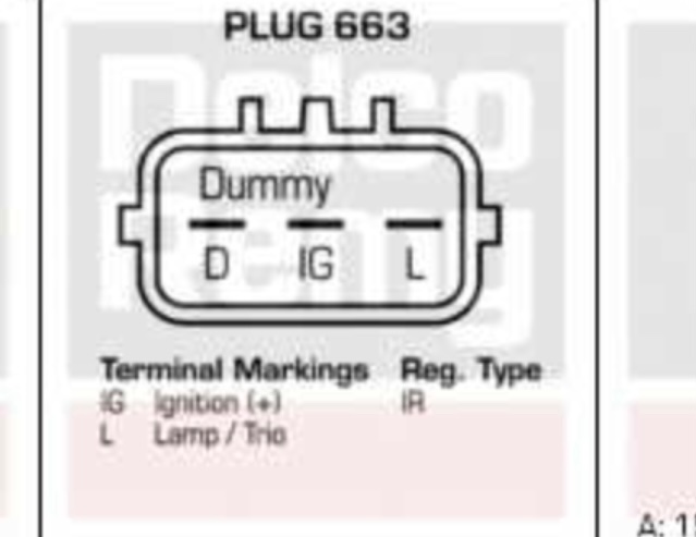

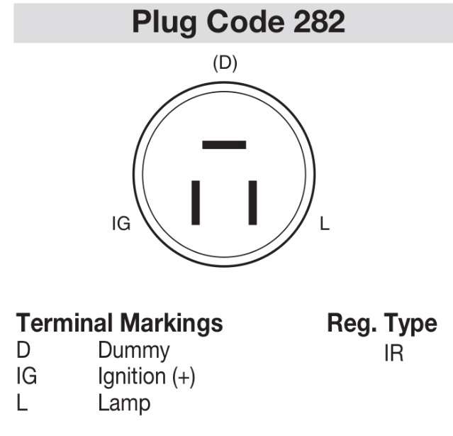

Alternator
Uses the same colour wires as original
White/Yellow tracer to bolted +terminal
Black/white to Ignition live terminal on plug
White/red to Lamp terminal on plug.
