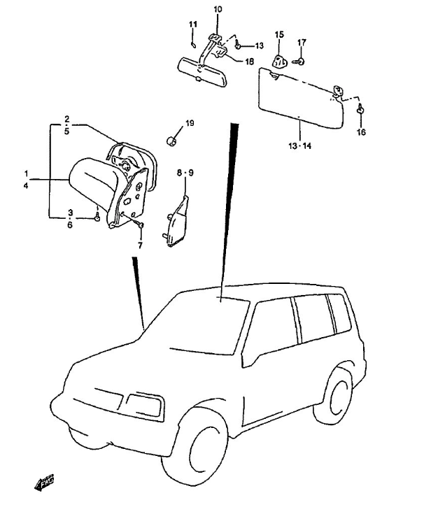

I removed the rear view mirror whilst I was trying to find out why the sunroof wasn't working, and now I can't work out how the damned thing stays attached to the roof, It has two massive holes, presumably for the bolts, but whilst I have screws that screw into the threaded holes in the roof none of them will keep the mirror in place as their heads aren't big enough, am I missing a pair of washers or something?

If its anything like the SJ they have these small plastic cone things that the screws sit in.

Post by Darrell » Wed Aug 21, 2013 11:06 pm
Well it shows a plastic cover............

there is 2 plastic bungs that go in the holes then screws go through them

thanks for the replies, I can't find the bungs (must have put them somewhere "safe" so as to not lose them). but have managed to use a pair of longer bolts and large washers for now.
