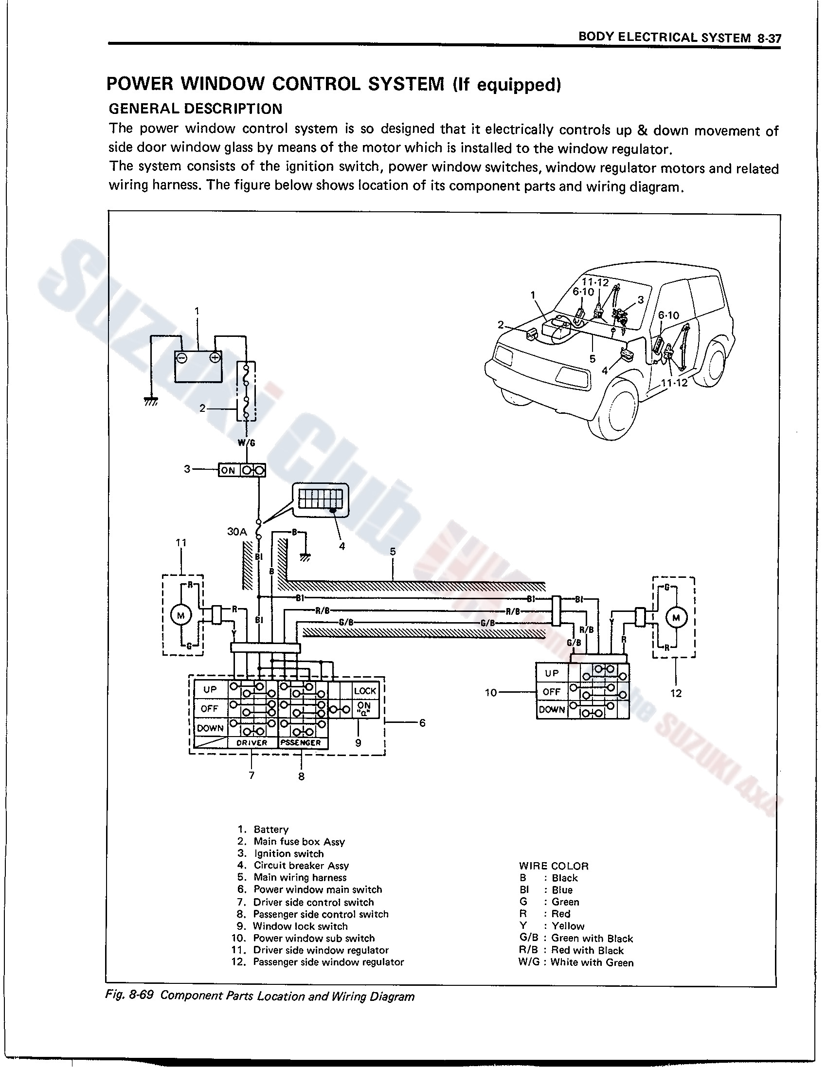

does anybody know what may be wrong with my passenger side window, it opened and closed fine but now has completely stopped working!? is this a common fault and how do I fix it? Thanks people! :rhino:

This might help, it's for an SJ. I'd think it will be simliar.

I think it could either be a dodgey switch or the motor, how do I know witch one it is? :) :D
Re: Vitara window faults... help!!
Post by Darrell » Sun Apr 13, 2014 10:21 pm
I assume it's just the one window stuck, not both.
IE: fuse not blown.
Otherwise it's a multimeter job.
