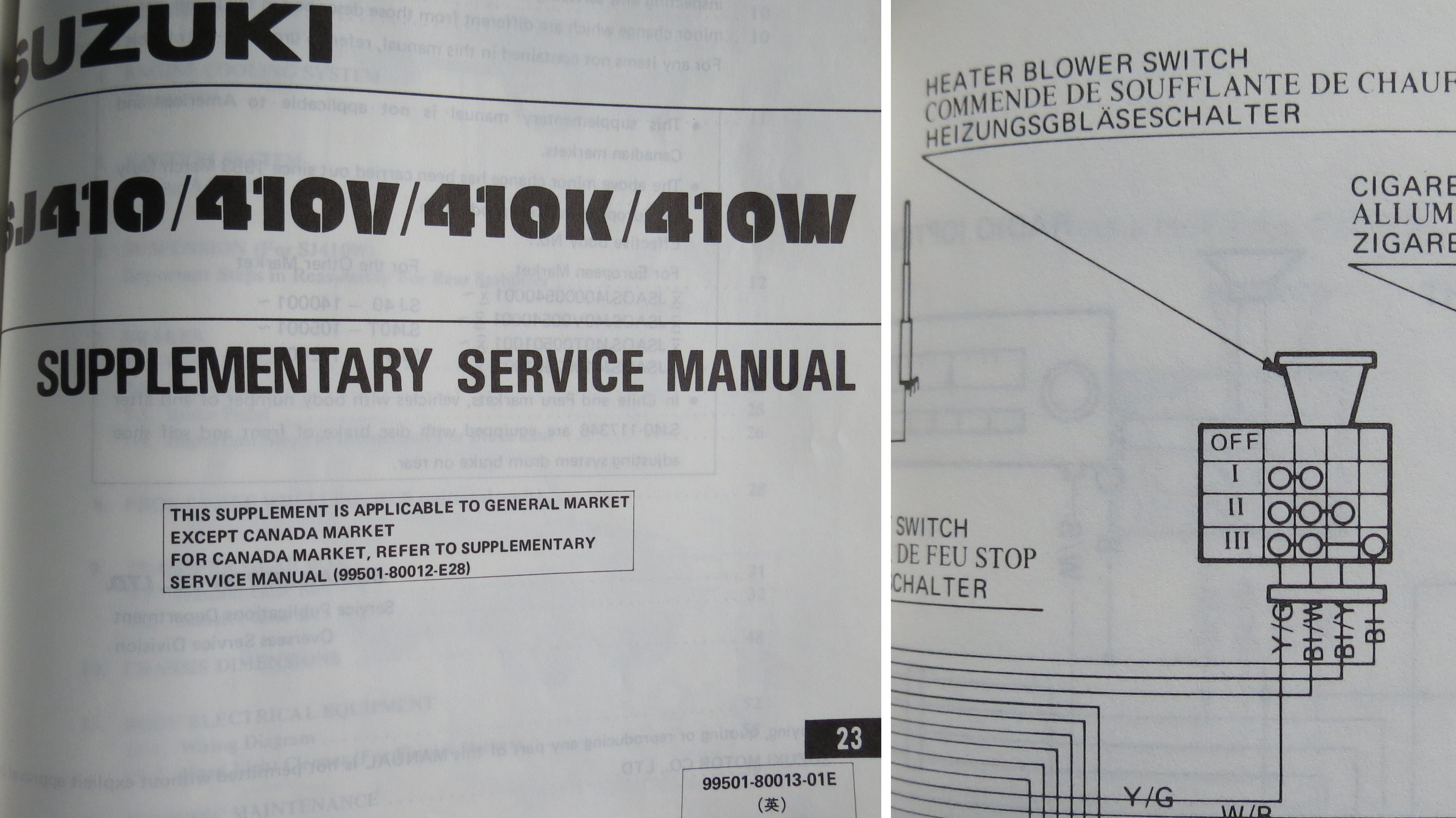

Not that it's relevant on yours as the Vit loom shows light green for the fan supply, but I see a supplement in the 410 manual showing that some earlier ones may have a Yellow/Green suppling the fan circuit.
410 heater switch.jpg (648.73 KiB) Viewed 6736 times

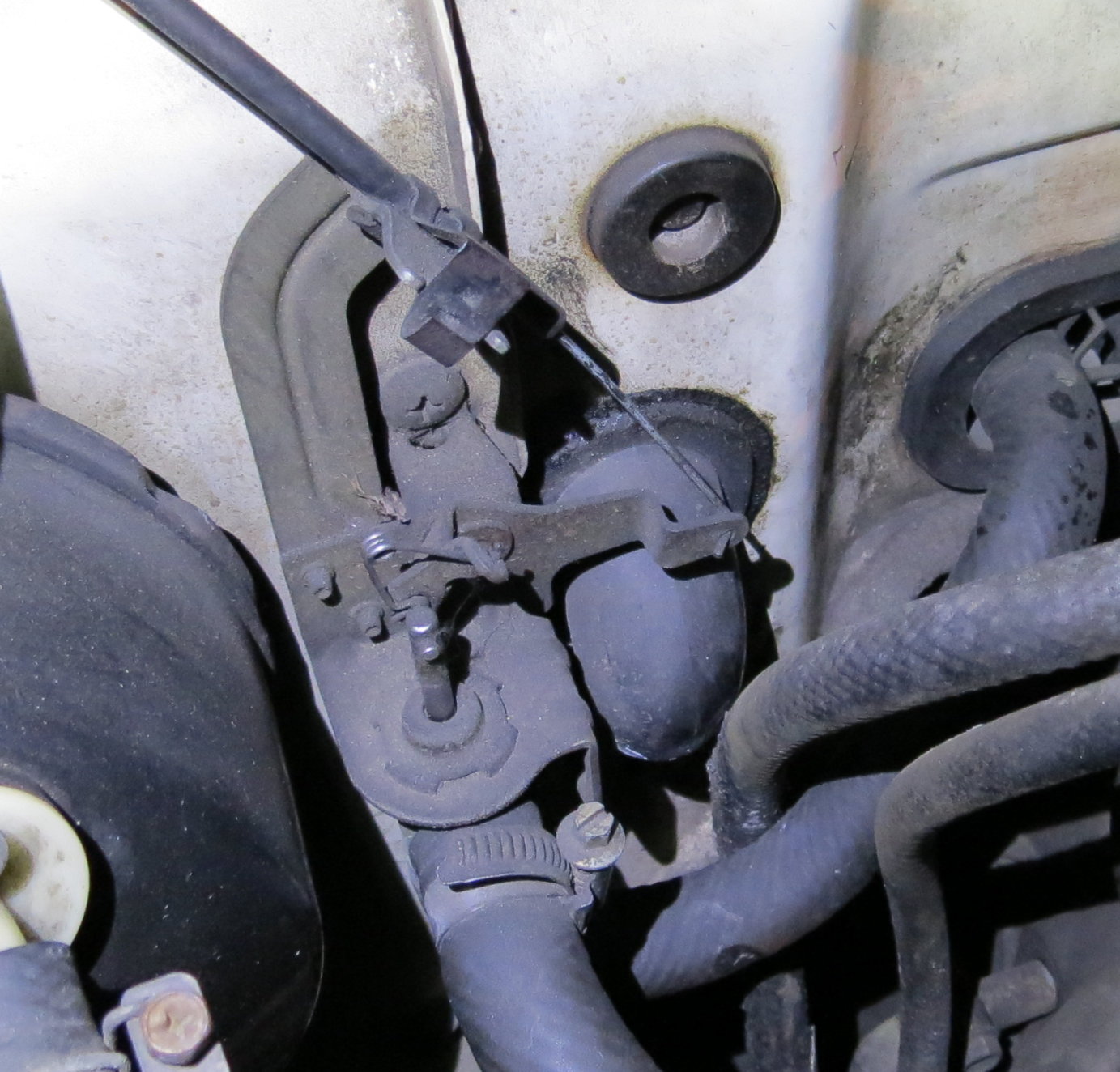

Cheers Darell got that wiring done today n all spot on blew afew leaves out from someware but all is working minus afew air ducts and tubes but atleast it works , left it tickin over bout 15 mins felt a slight tem change , i noits cold out there lol , so to make sure i got it wright that valve thing on the bulk head that controls hot and cold ? Which position should it be in , thanks
Re: Heating
Post by Darrell » Sun Nov 20, 2016 5:56 pm
My 413 in the hot position. Not sure if the 410 has the same valve though. Either way pin pulled out :thumbup: .
PS: RHD if anybody else stumbles on this post.
SJ413 water valve hot position.jpg (286.05 KiB) Viewed 6705 times

Post by lukey4x4 » Sun Nov 20, 2016 9:31 pm
Cheers darell yes mine looks the same but on its side cheers
