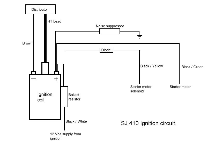

i got a new coil with the ballast resistor attatched yesterday, and it's doing the exact same thing! maybe its the wiring? the black/green wire goes to the starter, but when i replaced the starter maybe i got it wrong? and help would be much appreciated!
Posts: 11709
Re: engine cuts out
Post by ScottieJ » Wed Dec 07, 2011 12:14 pm
Can you post up some pics of the coil and starter wiring.
There should be a black w/green tracer and a black w/yellow tracer going to the starter, I'm wondering if you have wired it up slightly wrong.
Re: engine cuts out

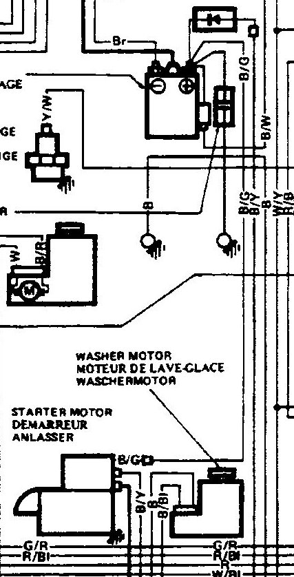

Post by Darrell » Sat Dec 10, 2011 3:39 pm
I've revised my diagram to show all wires. I believe the black/green wire that goes to the starter fits on the starters main supply from the solenoid. The black/yellow goes onto the solenoid. I don't understand why there are 2 wires from the starter as both seem to supply 12v to the ignition coil when starting. Once it's started though the coil supply is from the black/white wire from the ignition switch. Does anyone know for sure where the black/green is connected at the starter :er:
My modified diagram and a crop from the 410 wiring diagram............

Re: engine cuts out
Post by mk1joe » Sun Dec 11, 2011 11:20 am
hi, ive wired up the new coil with the black/green wire but at the starter motor end it is disconected and im not realy sure where it goes. could anyone tell me where abouts to connect it or maby even a picture?
cheers
joe
mk1joe
Posts: 707
Location: gosport
Re: engine cuts out
Post by mk1joe » Mon Dec 12, 2011 4:49 pm
would it work better with the green/black wire just connected to the main 12v supply to the starter like on the diagram?
Re: engine cuts out
Post by twiss » Mon Dec 12, 2011 4:54 pm
I don't own a 410 myself... but is there any reason why it's wired up like that?
My Samurai starter motors (and most others I've encountered) have a big chunky wire from Battery +
... and a small thin wire that eventually goes to the key start position, via the dashboard battery light
Is there any reason why that wire really needs to be there?
