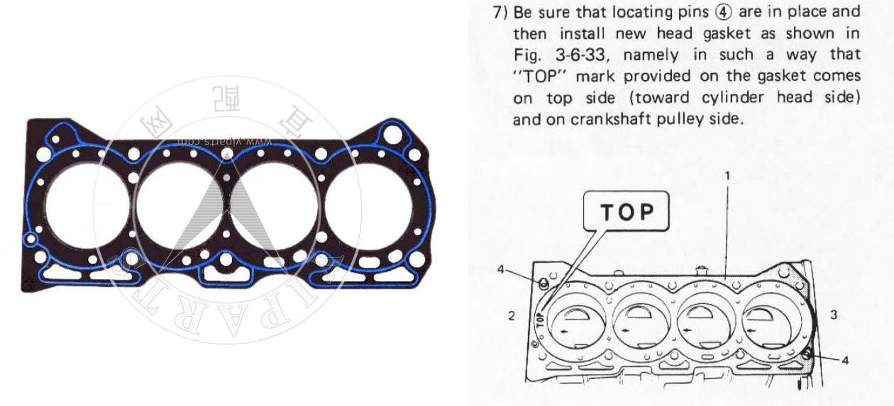

I thought I'd look into this head gasket and from I can see you can't fit it wrong (or is that just me)
Pic from motorfactors - Diagram from workshop manual.
head gasket.jpg (110.71 KiB) Viewed 5865 times

They can physically be put on 180 deg out. But you would have to be pretty distracted not to notice. I have chucked one on in a hurry then turned around to pick up the head and turned back and realised straight away.

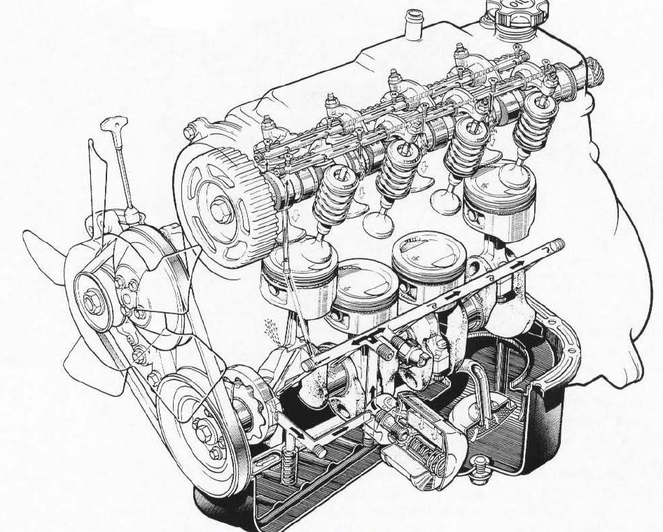

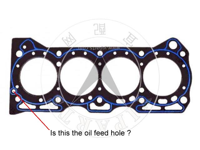

More diagrams :thumbup:
oil feed.jpg (44.88 KiB) Viewed 5860 times

the one I ordered previously was off ebay, i matched the engine code but when it came down the whole's for the aligning pins where not big enough so i had to force the pins through to make them bigger, and some of the water ways where slightly out but not much. some had a bridge where my block didnt. so i will check this oil whole to see if i had it lined up ect and check its not blocked.
and this time ill go to Suzuki specialist and buy the gasket locally :)

it it is the wrong way round it will stick out of some sides/corners on one side and leave a gap on others.
If it lines up with the outline of the head all the way round its on the right way round.
