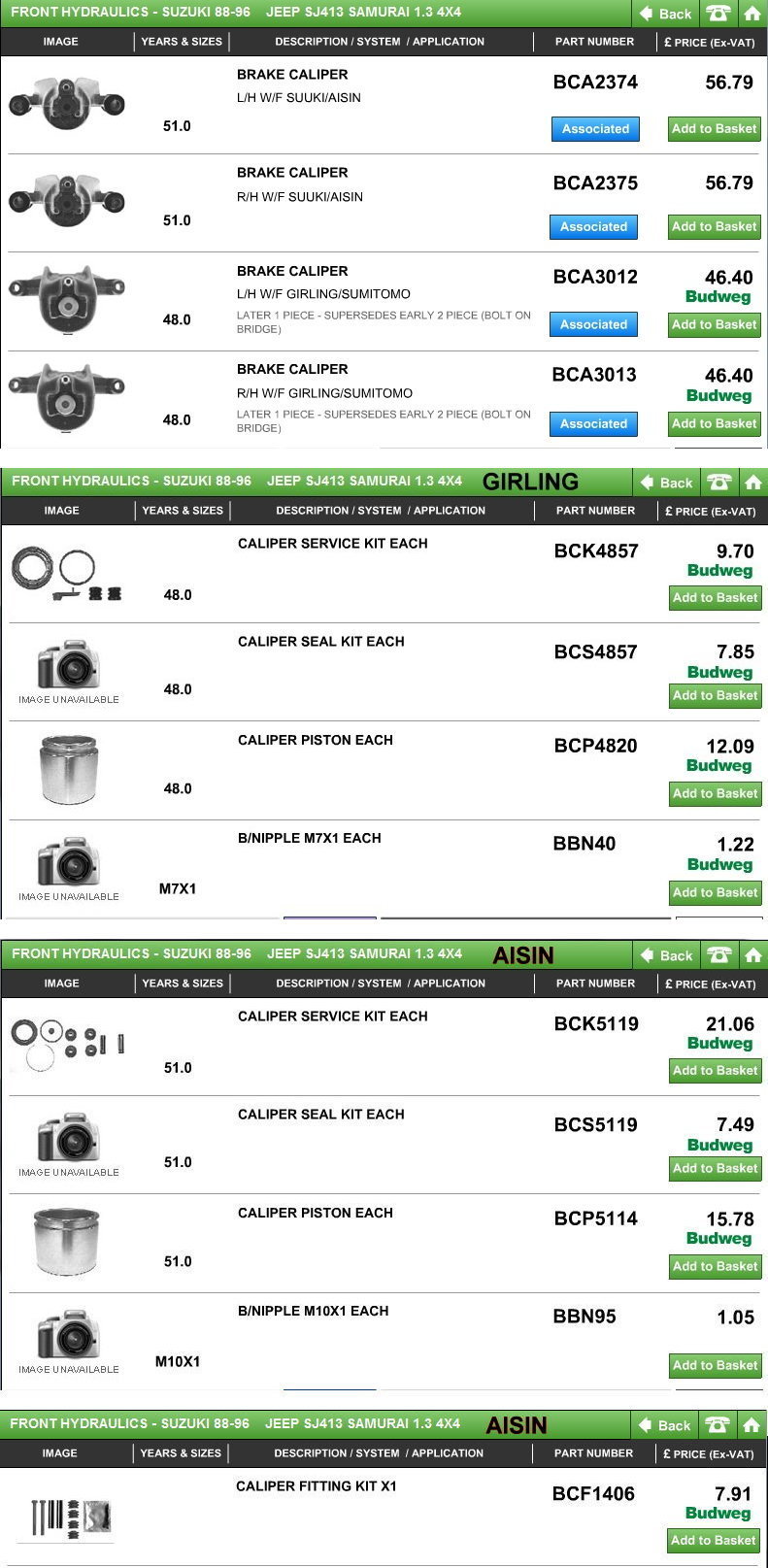

See you have some nice calipers fitted now, but decided to have a look around Brakesinternational to see what I could find. I was told they had spares but were not listed. Well I found this lot !
Aisin-Girling @ Brakesinternational.jpg (227.75 KiB) Viewed 6604 times

Nice find. Be worth saving that page. Surely there's a demand for callipers on here.
I realised that the cost of a refurb including replacing the piston and seals would be around 40/50 depending where you got the parts. Given the time taken to carry out the work it seemed sensible to just buy new ones and save the effort.

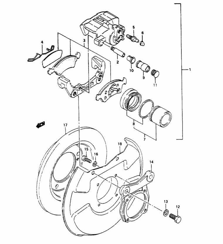

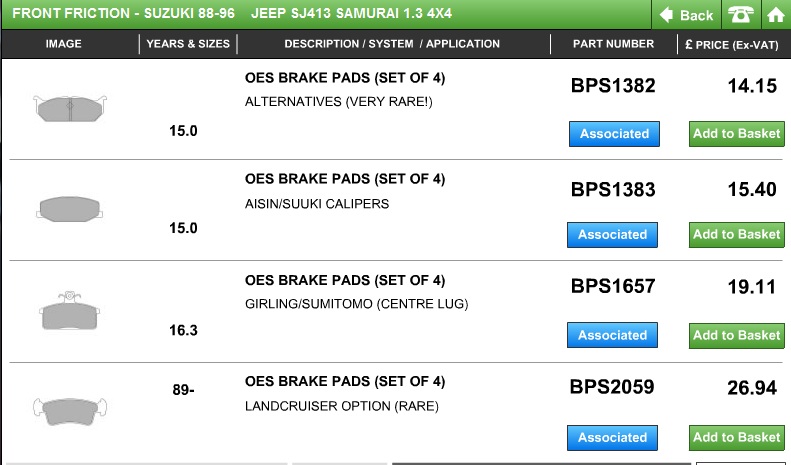

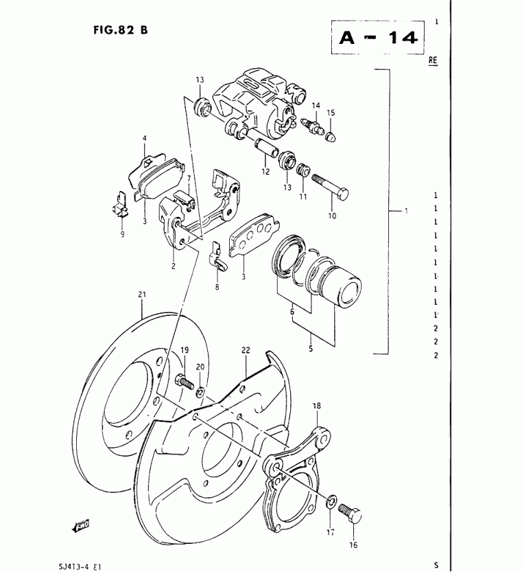

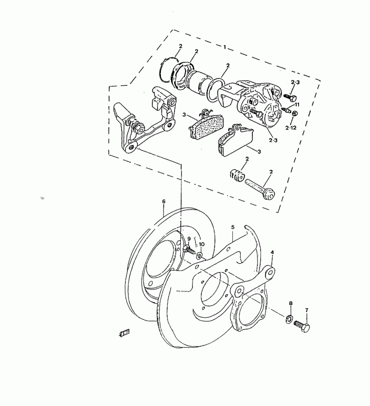

Back to the original post :oops: this was commented "not to mention some monkey rounded off the 6mm Allen key bolt!" and I thought "what allen key bolt"
Right then, went and found these diagrams. The only type I see with a allen bolt are the landcruiser type. I have never seen these type on an SJ or even heard of any fitted. Anyone else ??
aisin type.gif (51.13 KiB) Viewed 6596 times
Girling type.gif (40.38 KiB) Viewed 6596 times
Landcruiser type.gif (57.15 KiB) Viewed 6596 times
Pad type .jpg (89.39 KiB) Viewed 6596 times
