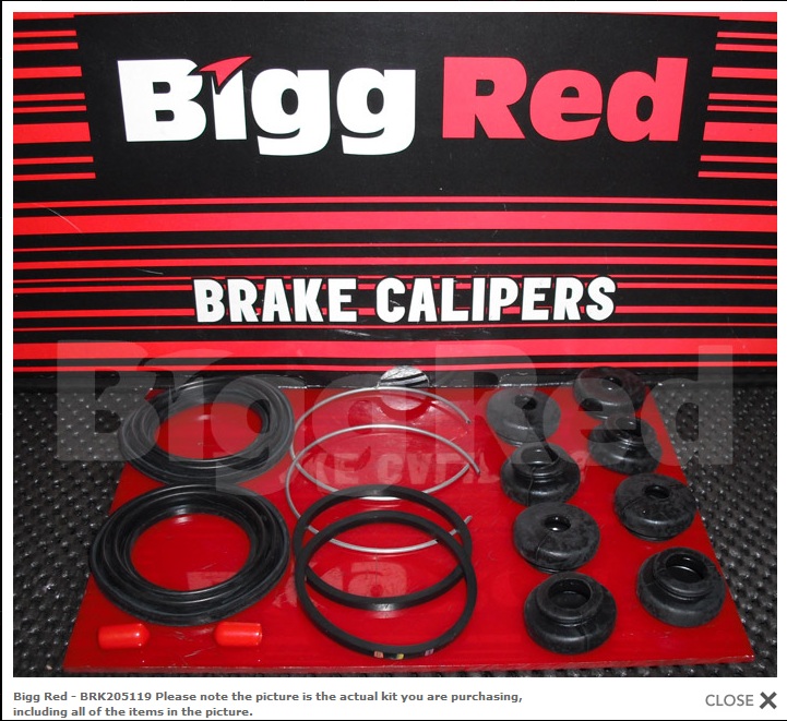

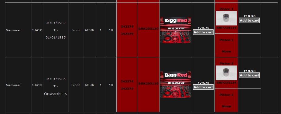

Never heard of bigg red, but just had a look at their site and they seem to have a perfect kit ??.
http://www.biggred.co.uk/catalogue.php
I think that's good value as it comes with all the bits in the pic. you would pay that at Suzuki just for the slide seals

I cant decide wether to buy new callipers or just rebuild my own with this kit. If im going to have ongoing problems i would rather just buy new callipers.
Do you think its worth buying this kit and refurbing mine ?
Re: Asian caliper rebuild kit cost?
saying that its going to be £50 for seal kit and piston plus postage and whatever else. New Jinmy callipers are about £75. not that much in it really counting in the time and effort to rebuild them
