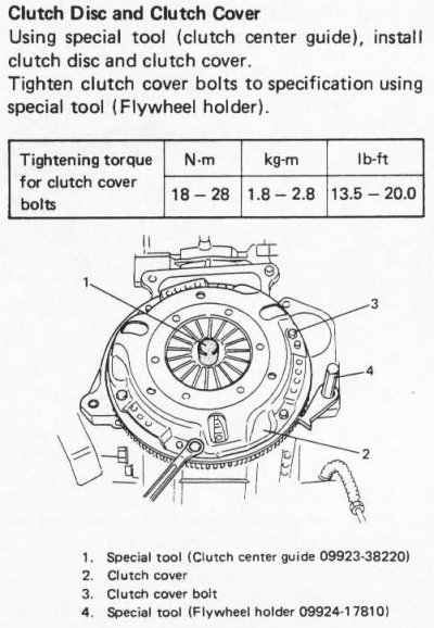

Post by Darrell » Sat May 25, 2013 10:03 pm
Well done :thumbup:
I remember taking the exhaust off as it was in the blooming way :er:
Feel free to bung this in if you want.
SJ 413 clutch cover torque settings.jpg (55.34 KiB) Viewed 7088 times
The 410 manual gives no torque settings (or I can't find them).
