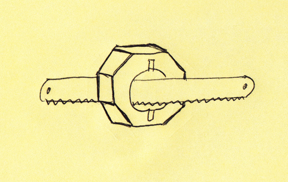

What I have occasionally done is to take a spare nut and fit it on a junior hacksaw and cut grooves in it.
I have then wound this nut down the threads to clean all the rust off before undoing the fixing nut.
This works quite well as the rust has grooves to go into and does not jam up straight away.
A bit crude but it works! wd40 at the same time helps wash the crap away.
A top quality diagram on a post-it note :D
thread chaser.jpg (137.13 KiB) Viewed 5760 times

Darrell wrote:A top quality diagram on a post-it note :D
If you don't have a diagram, make one. :hahaha:
