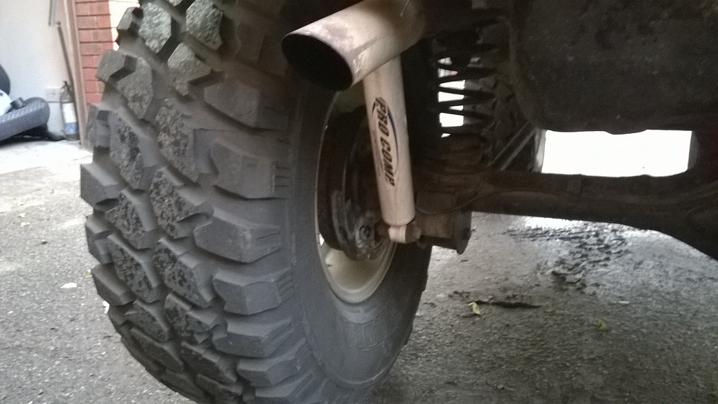

Bodywork is rough as hell, dents everywhere but NO rust as is the underside. Clean as a whistle. Props seem to be ok (ish) rear is spot on but the front and middle have a bit of play in them. A mate (Sam Hi Lux owner x2) is looking for some Toyota Landcruiser props, with the funky UJ meaning they can run at extreme angles. Failing that I'll source new props or get some fresh UJs.
Do you mean double cardon props? If so you are going to have to completely change the angle of your front and rear diffs as you need to point the flange straight at the tcase outputs for proper alignment. The front would require cutting and turning the steering knuckles and that's not an easy job, rear would mean cutting off and relocating the spring and link mounts.
Double cardon props actually bind during flex before a normal prop will, they have less movement in the UJs.
Best to stick with a normal prop, it will be less work. seeing the angles of your props I don't really think you have to worry that much.

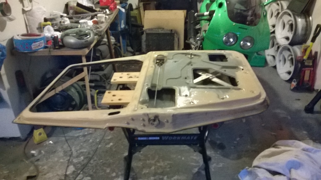

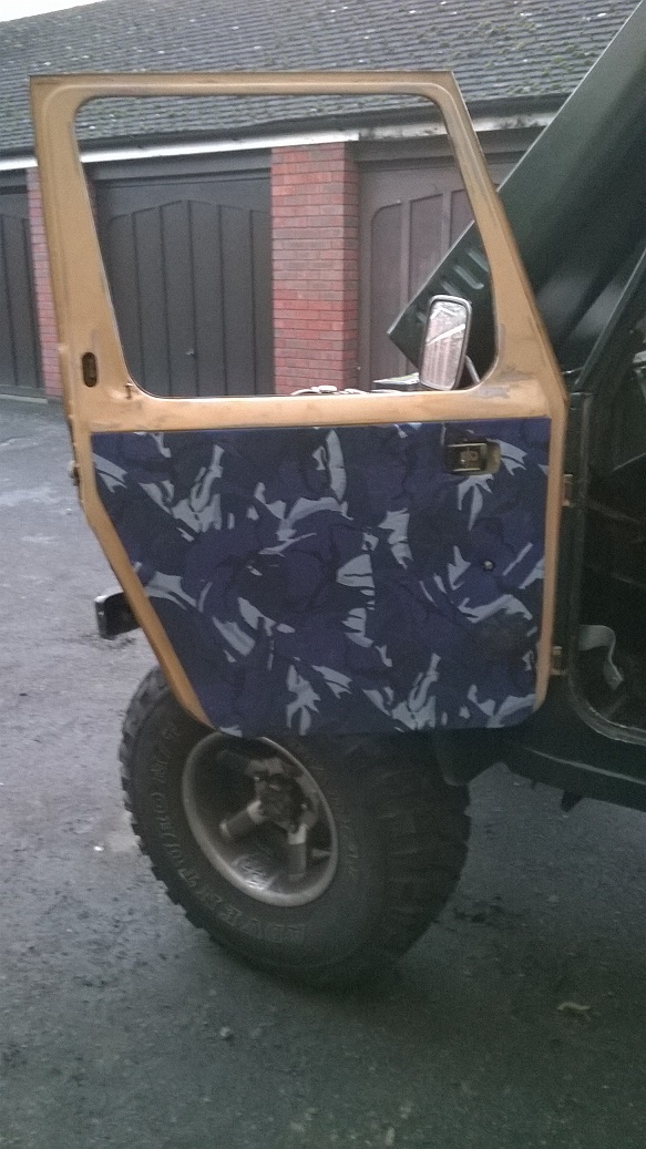

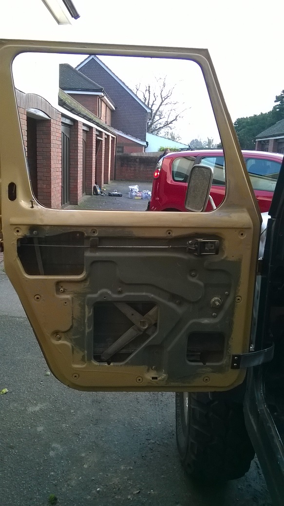

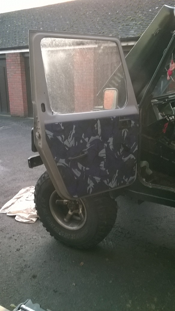

Did some more bits today...bumper painted, door off and that's been sanded down, inside primered and it's all back on the car. Side light packed up again...I hate electrics, I really do. And then the fog light joined in the fun and games. Got a new one in the garage and will bung that on tomorrow.

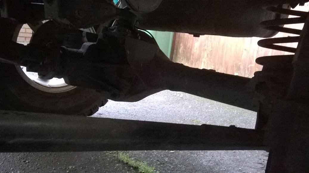

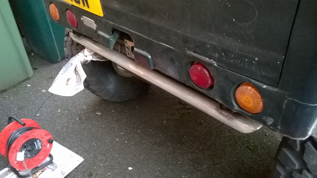

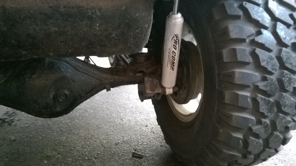

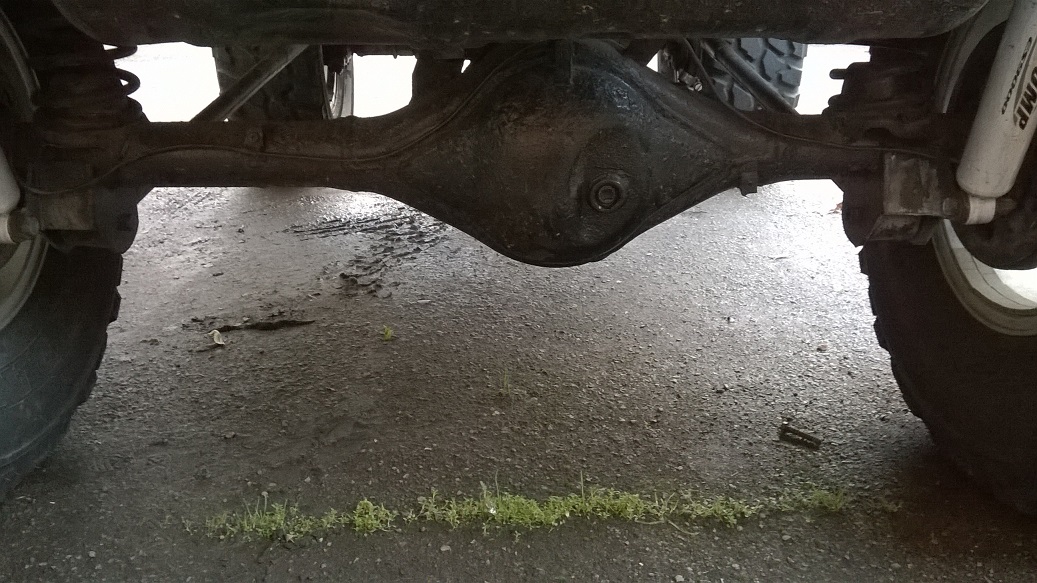

Oh and Anton...pics of the rear axle for you!

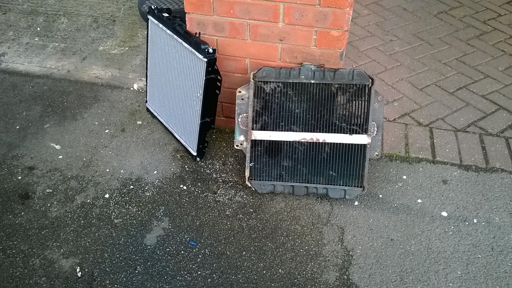

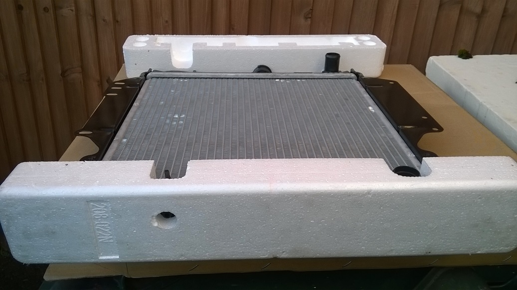

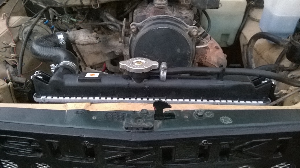

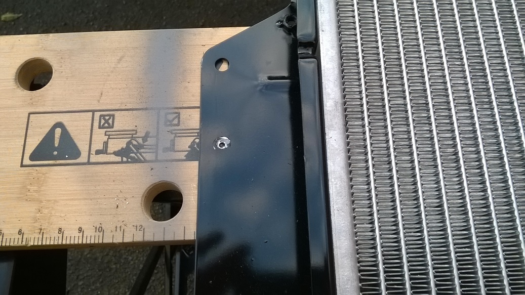

Did the radiator today amongst other little bits, good to know that a 413 rad can wriggle into an LJ with a few new holes drilled in it...

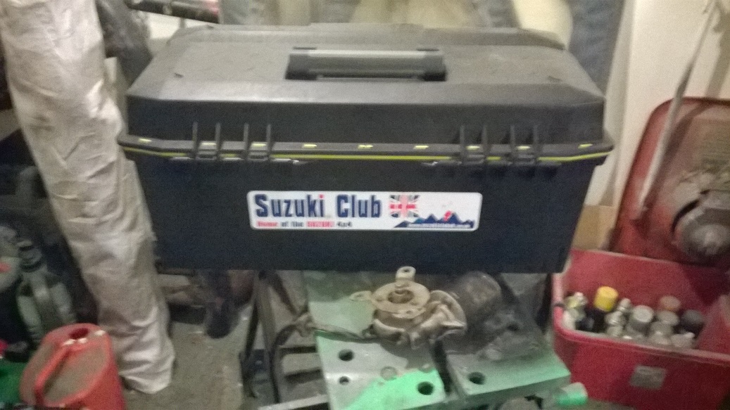

And put my SCUK sticker on!

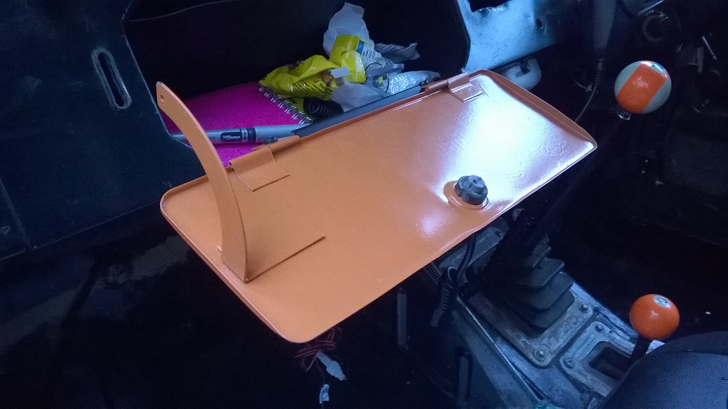

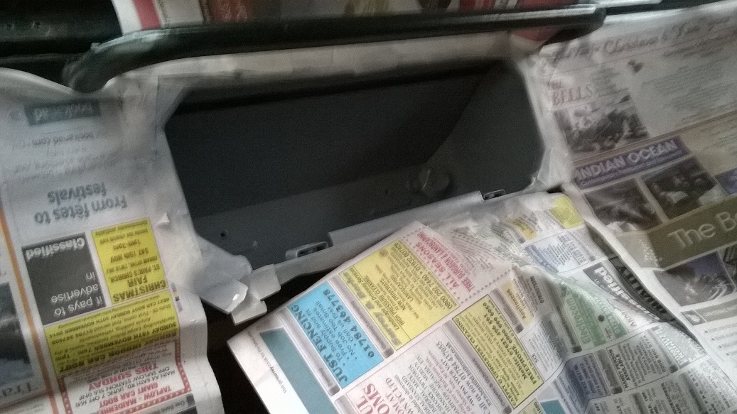

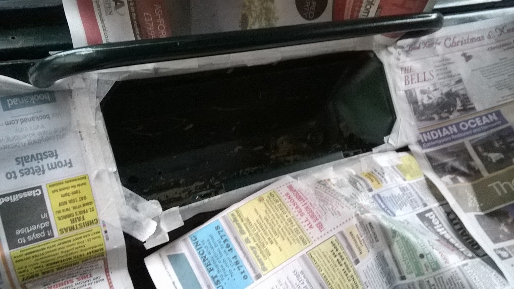

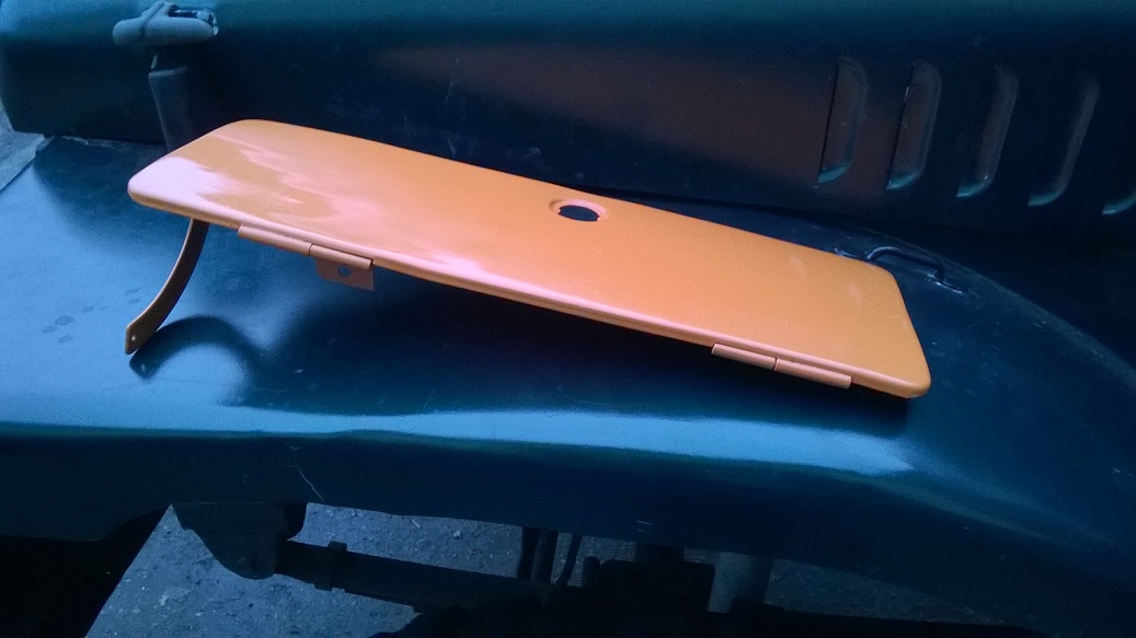

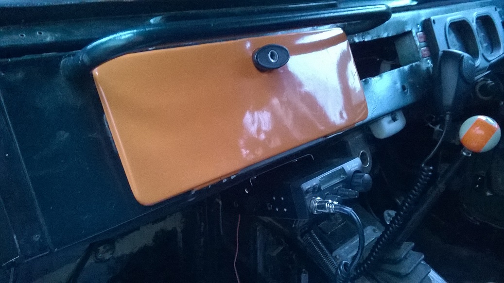

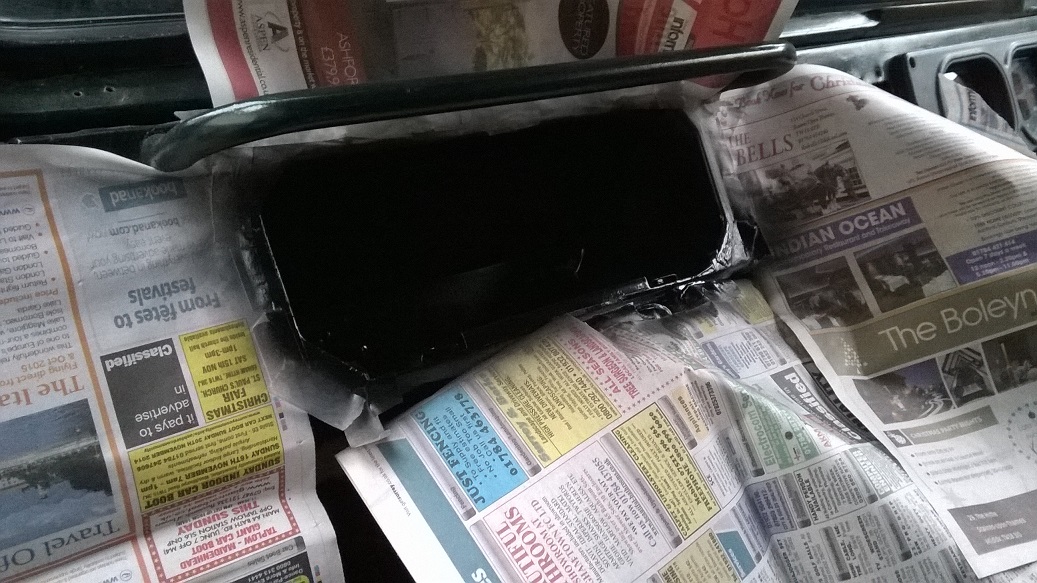

Cleaned out and painted the glovebox, then decided to make some trim for it from the remainder of the door card stuff I had left over. Automotive glue doesn't work with it so I'll use velcro.

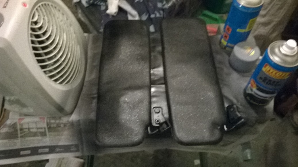

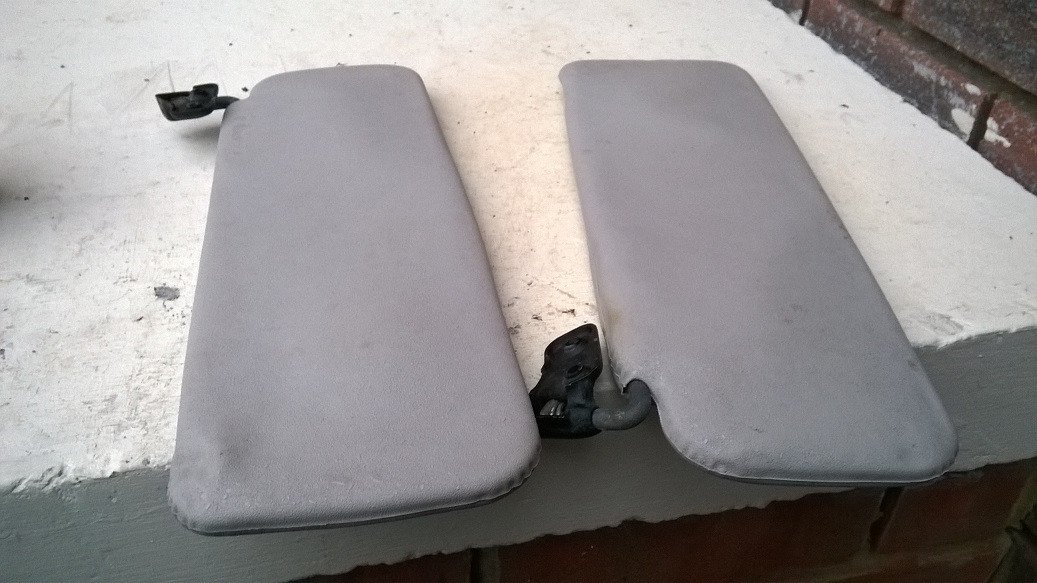

Sun visors arrived from Steve Green, many thanks matey! Cream not a good colour, but I needed a set badly, they are now black!

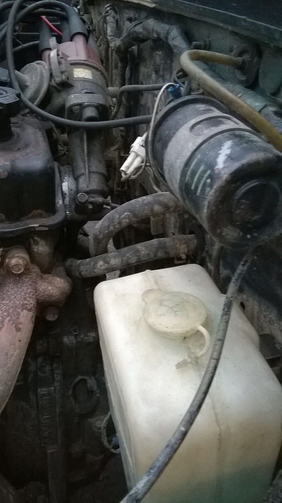

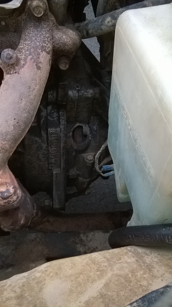

Since I out in the new radiator and thermostat P6 has been loosing coolant...both rear heater hoses were leaking, so new ones on...anyone got that engine blanking rubber? (see pic)

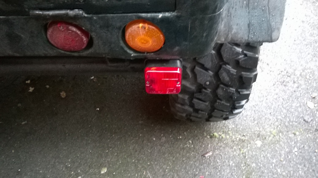

Fog light packed up, so a new one put on.

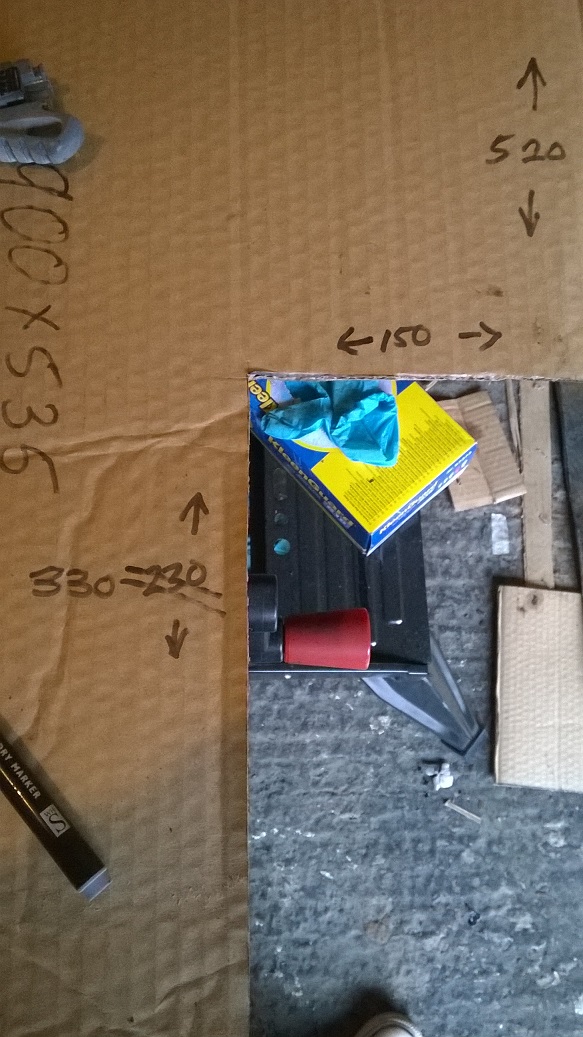

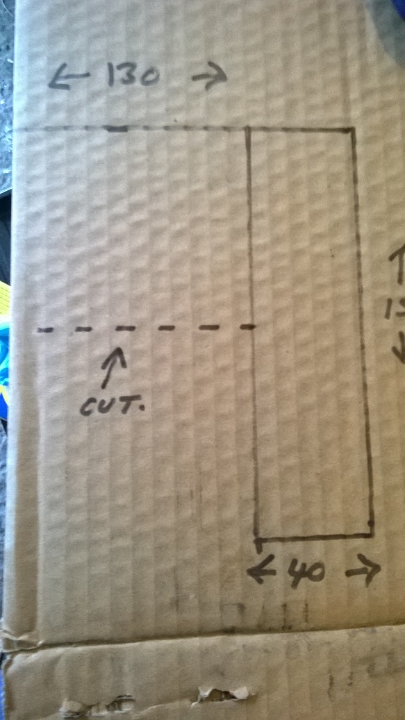

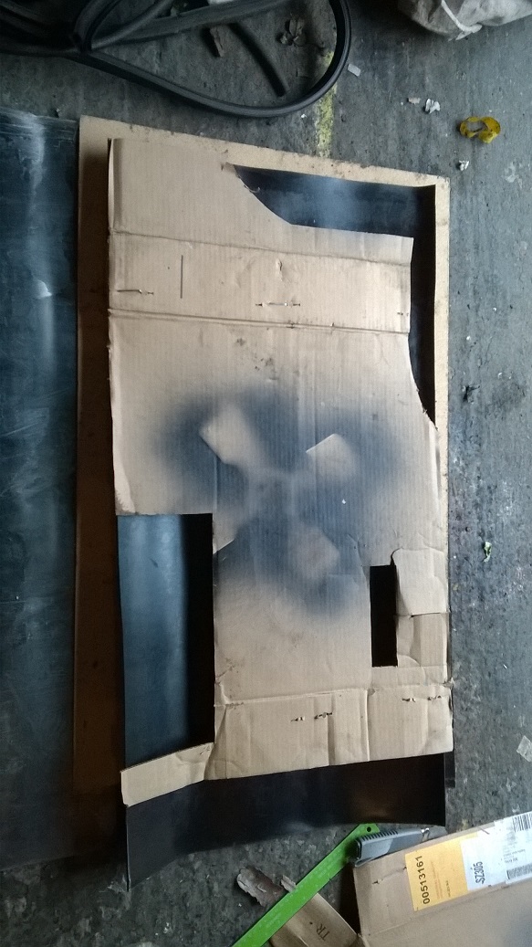

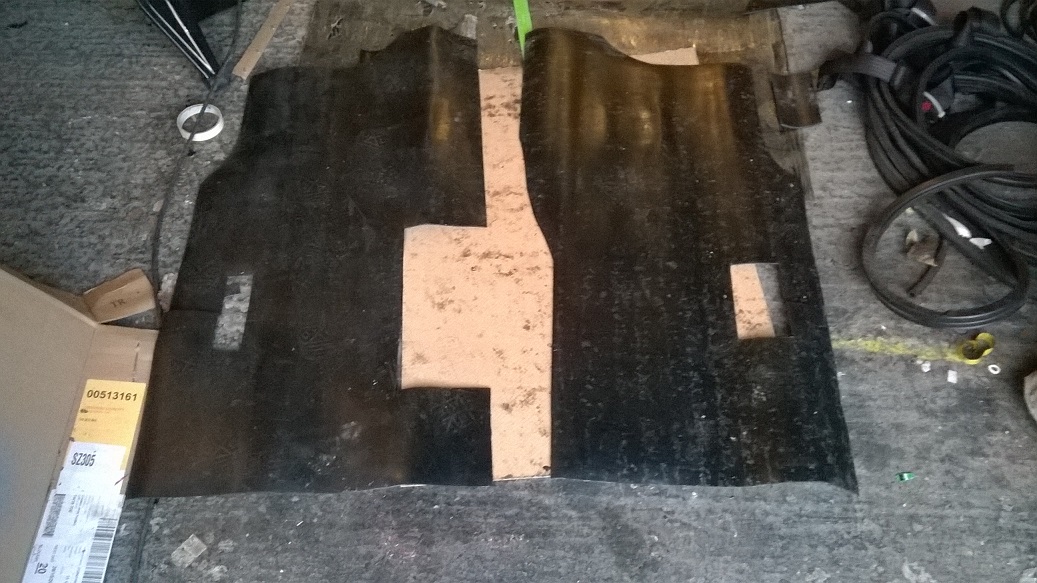

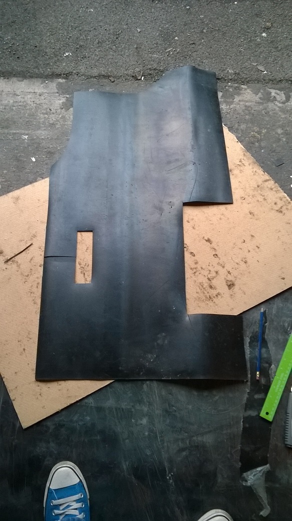

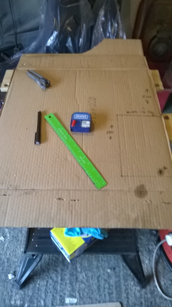

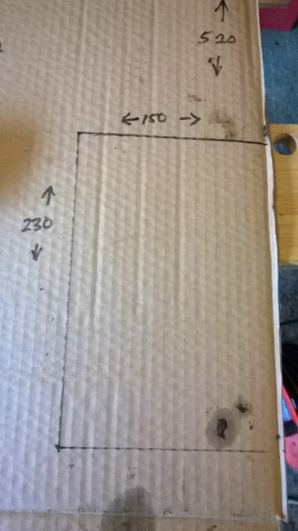

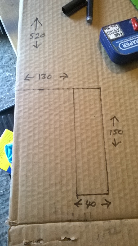

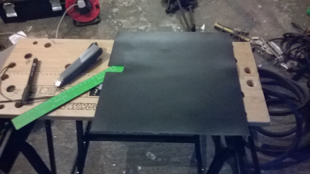

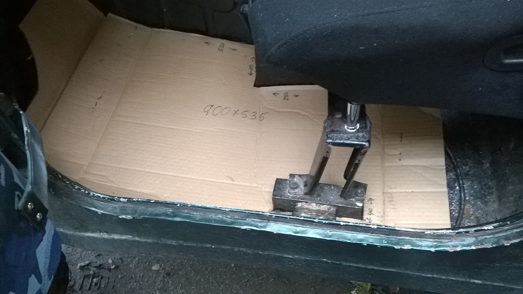

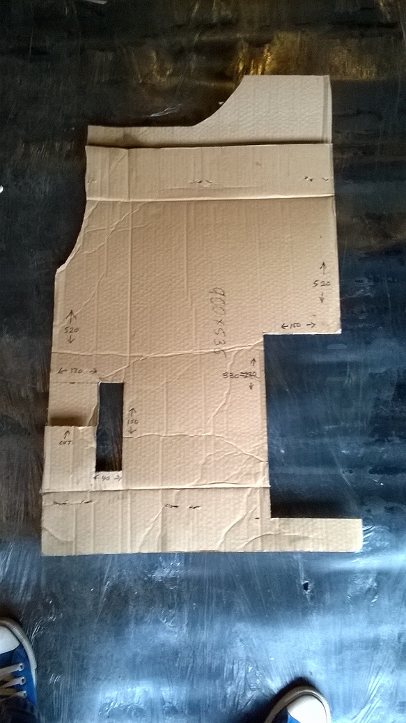

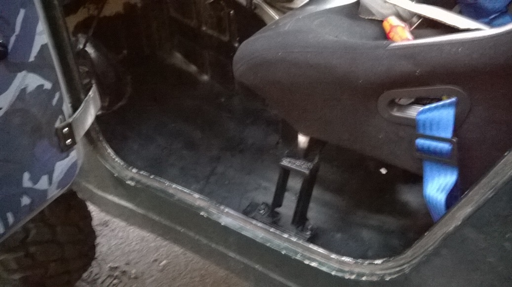

And today I made up the rubber 'carpets'. Pretty obvious how I did it if anyone else wants to make the template. And children, remember... sharp knives should be handled by an adult only...
