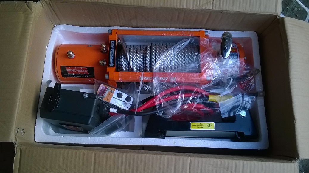

What winch did you buy? Sounds way overkil for a little Zuki at 45kg :shock:
Re: the no dosh LJ revamp
Post by donkeychomp » Tue Dec 09, 2014 11:13 pm

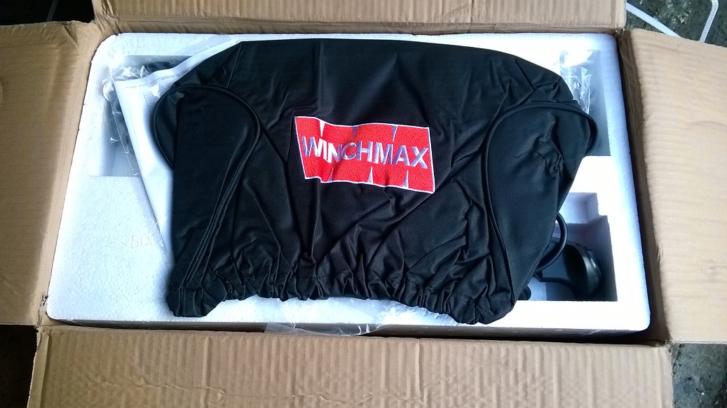

A 13,000lb Superwinch. Brand new with 2 years guarantee, cheapest and strongest one I could find. The other LJ has a Superwinch too, I forget what weight.

That's super overkill for an LJ/Sj, only need 6-9000lbs really.
I'm very weight concious with my zuki's that's why I like the warrior 9500SD, it's small and only around 20kg with a plasma rope. When I build the buggy I want a centre mounted vector winch set up so I can pull forward or backwards using the same winch. If I can afford it I would love a redwinch cobra...only 33kg without rope, think 8274s are around 50kg.
Post by donkeychomp » Wed Dec 10, 2014 10:20 pm

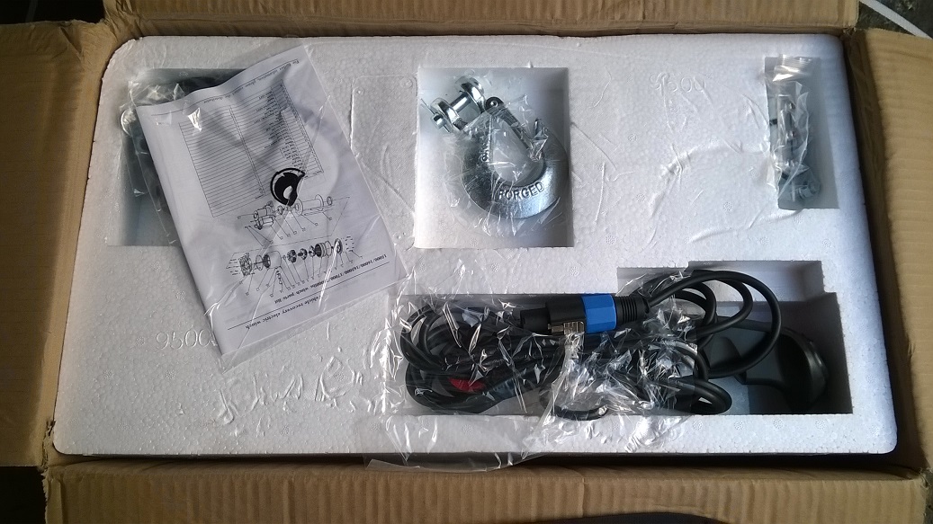

Well here's a pic anyway! Guess I can pull out 2 cars at a time lol. Think I'll run a second battery to cope with all this...

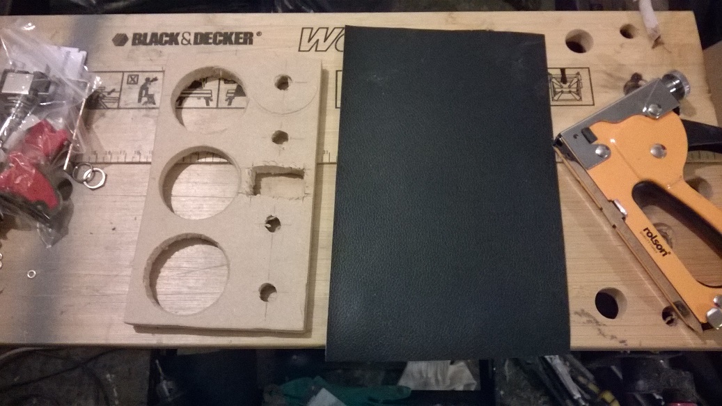

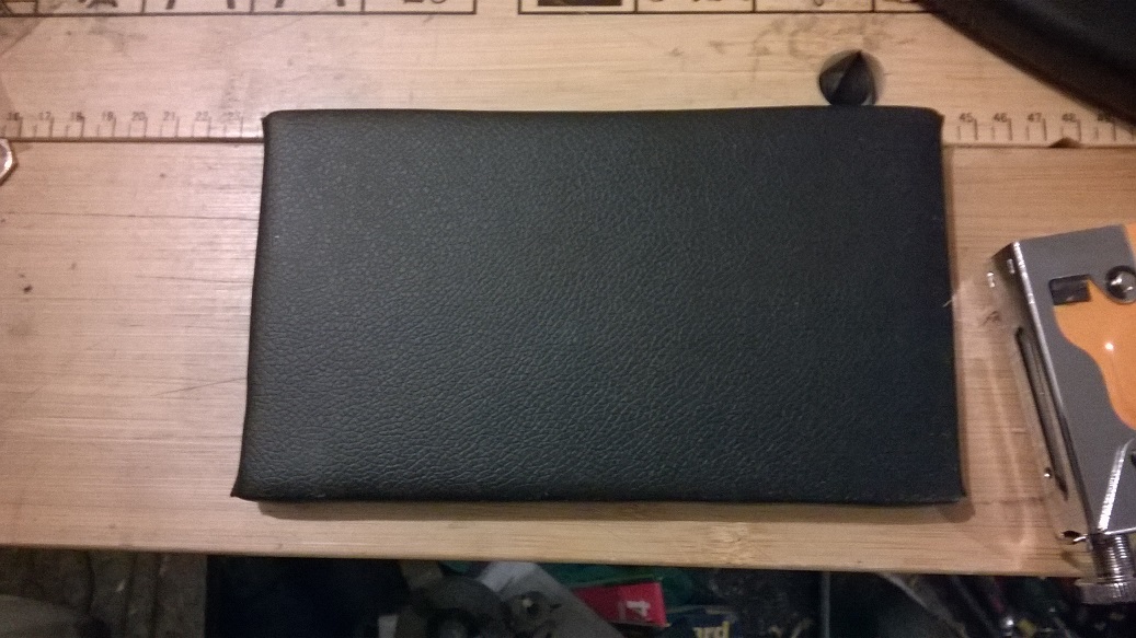

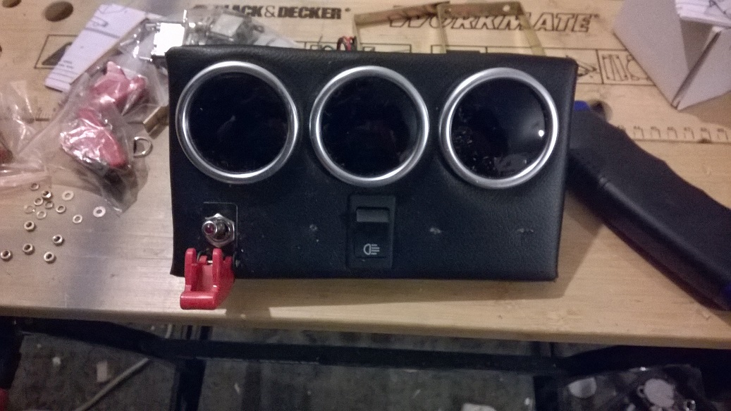

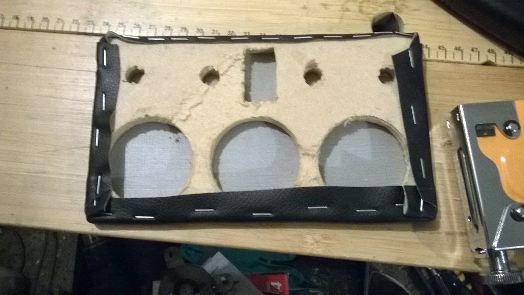

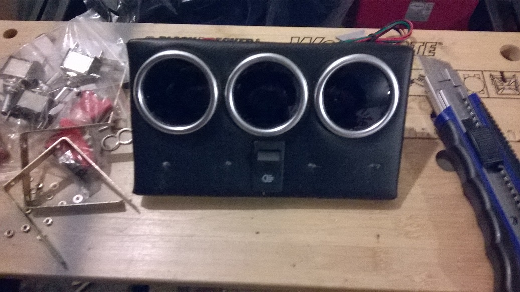

I've almost finished making the binnacle for the extra gauges and some switches. Hoping to get some more major work done tomorrow.

Ah a winchmax, my mate had one of those. It was fine until he started dunking it on a regular basis so make sure you keep on top of maintenance if it ends up under water a lot :thumbup: apart from that seemed like a good winch, just not as waterproof as some.

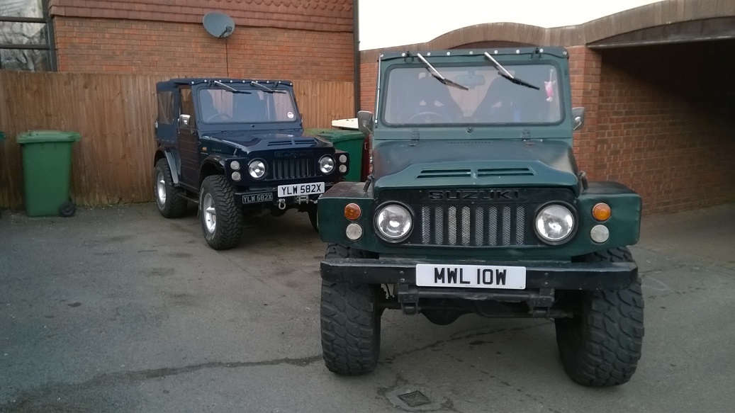

Ended up helping my mate fix his BMW today, but Piglet 5 is now at my garage awaiting some final touches.

Only minor jobs to do on the blue one, little paint touch ups here and there, make some rubber carpet like I did in P6, fit the cb and radio aerial and underseal the places we welded up. Oh, new glass for the speedo and get the cb working. Think that's it!
