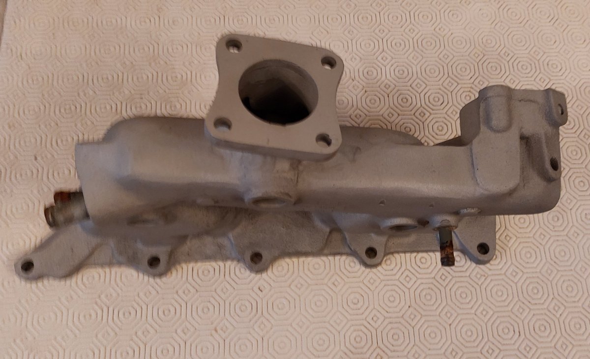

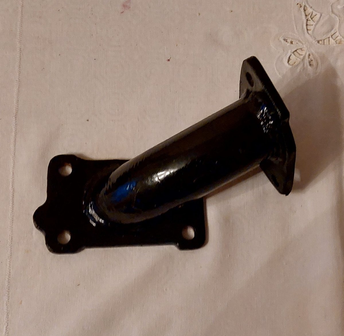

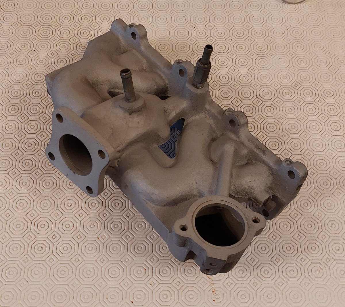

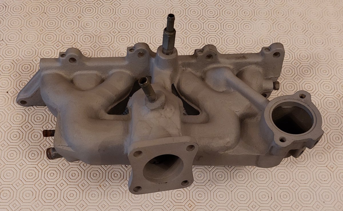

Had a manifold, off a SJ413 / Samurai, adapted to accept a SU HIF44 carb. This was done by Rockwatt Engineering.

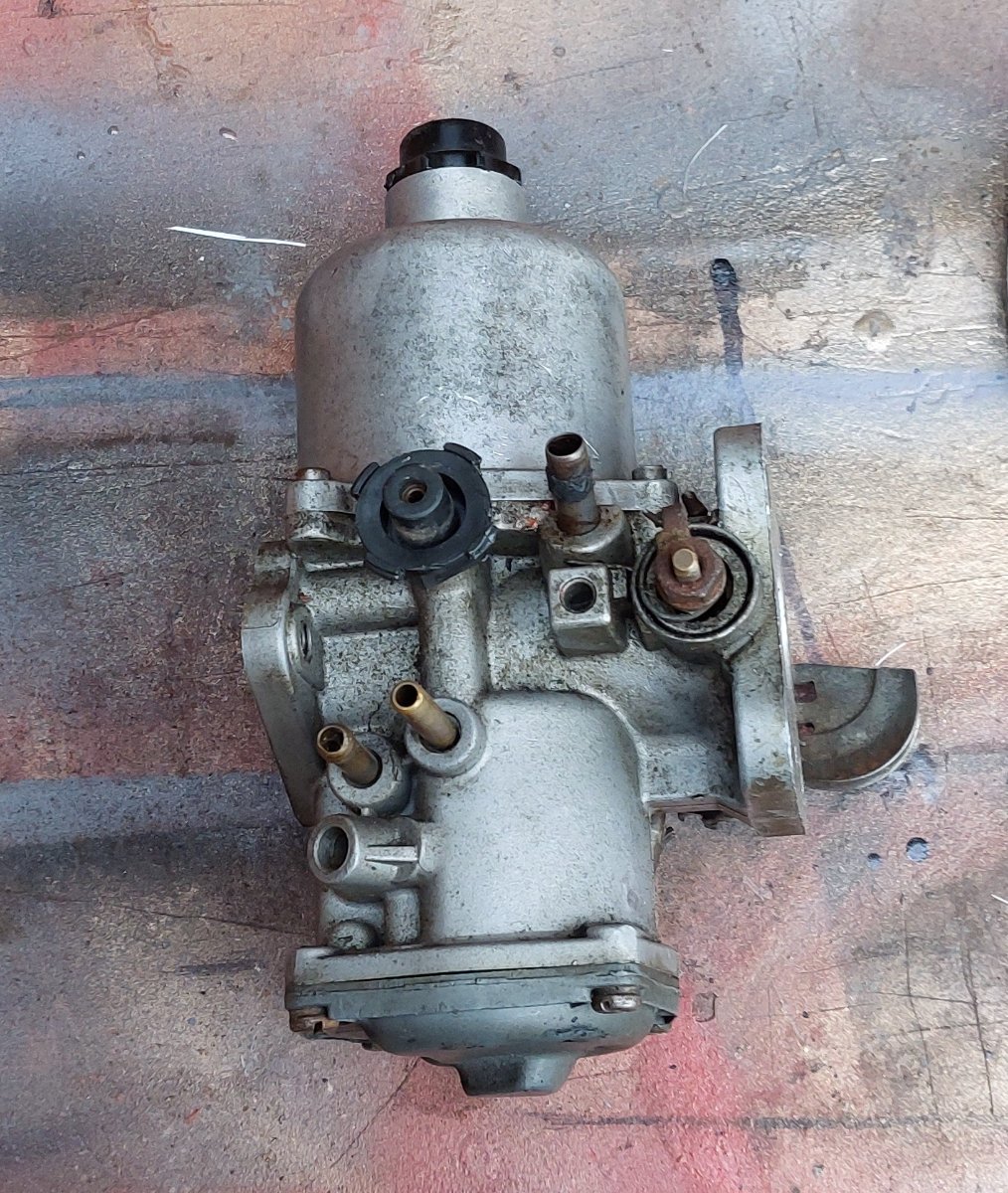

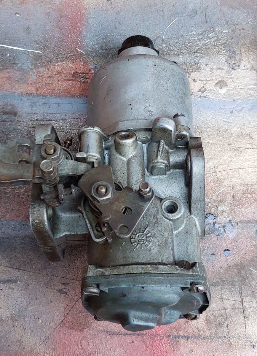

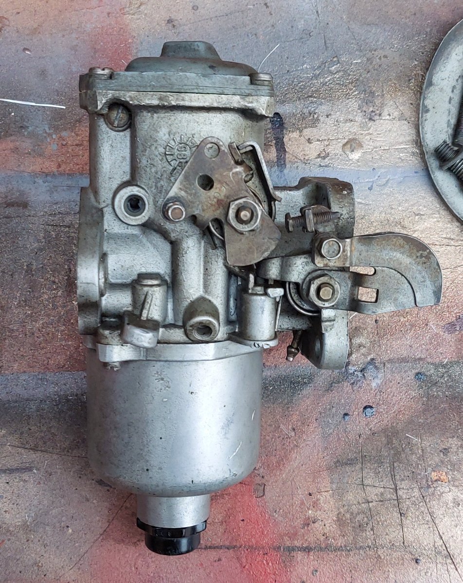

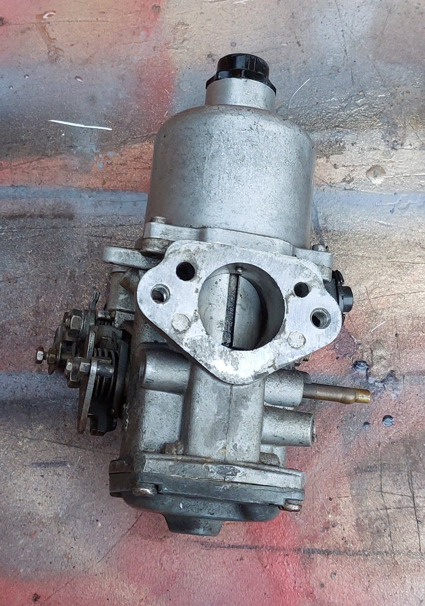

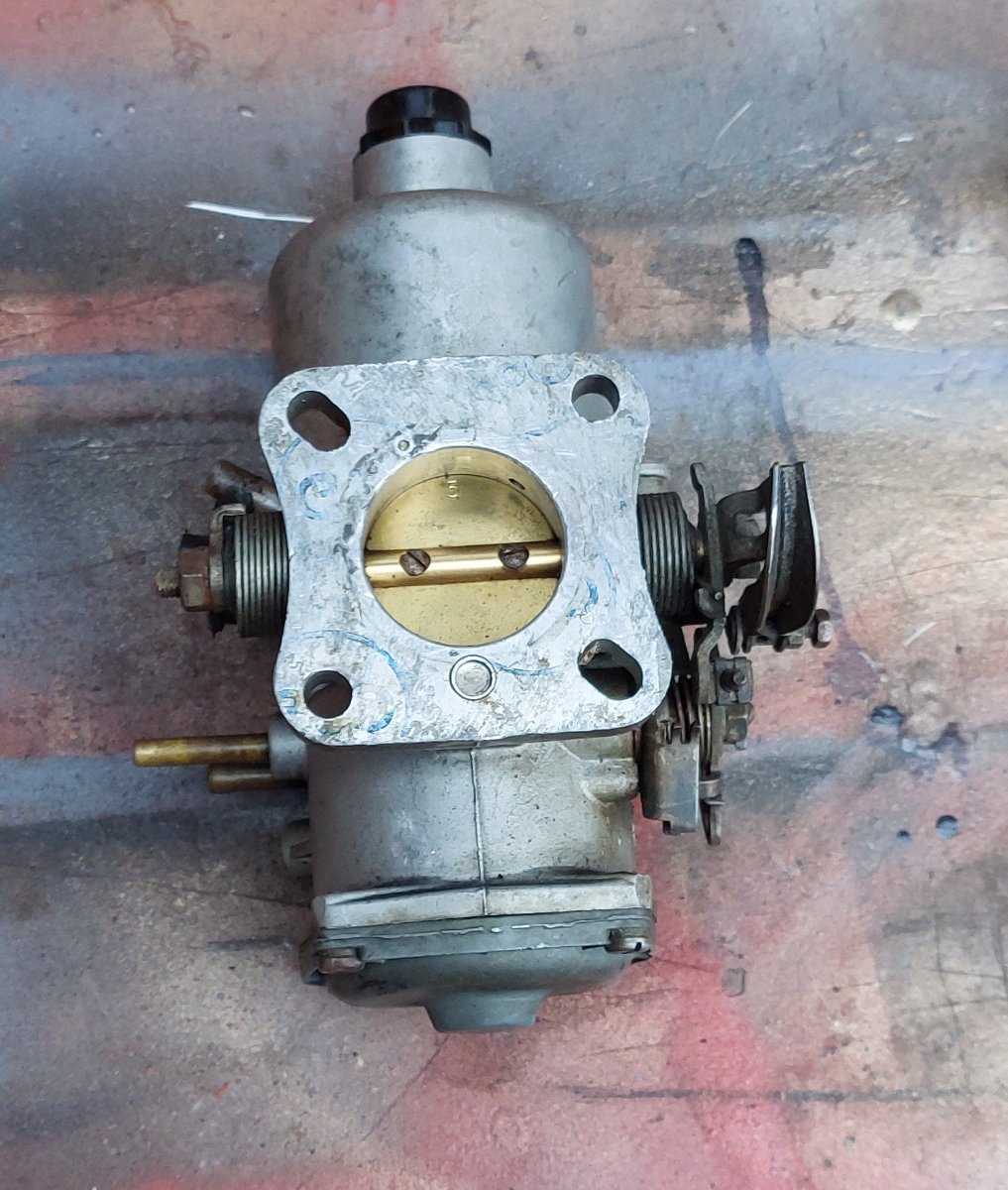

The SU carb I am planning to have reconditioned and fit.
Am using Carb Exchange at Leighton Buzzard for the reconditioning work. Have used them in the past with excellent results. Drawback is 9 week time period. They must have a long Xmas & New Year!!
Posts: 11716
Re: SU Carbs
Post by ScottieJ » Fri Dec 15, 2023 11:07 am
Is that a HIF38? You need the HIF44 for a 1.3/1.6
tomcat
Posts: 236
Re: SU Carbs
Post by tomcat » Fri Dec 15, 2023 12:46 pm
Sold to me as a 44. It is a 38 now I have checked.
Took the sellers word for it!!
Another search needed.
Posts: 11716
Re: SU Carbs
Post by ScottieJ » Fri Dec 15, 2023 12:51 pm
Shouldn’t be hard for you to sell the 38, they are good on the Sj410 F10a engine 👍
