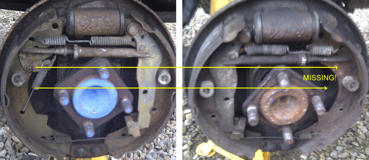

As Andy says your spare is a 410 Japanese axle without handbrake 220 mm diameter drums.
The axle you had fitted is a 410 Spanish (Santana) with handbrake 229mm diameter drums.
The samurai uses the same size drums but the listing showed 2 different cylinder types.
The listings only showed 1 cylinder type for the 410 with handbrake incorporated.
The Spanish version is nice as in you can change wheel bearings without undoing the hydraulics and the cylinders/shoes are the cheapest.
However you do seem to be missing the self adjusting mechanism from one side.

Re: i need help with brake shoes and cylinders on 410
I'm still not convinced that the 410 ever came with the handbrake on the rear drums in the UK, my dads is a 89 Spanish model 410 and that still had the tbox handbrake, I'm pretty sure 89 was the last year you could get sj410s in the UK
I could be wrong but I'm going with someone has fitted samurai rear brakes to it in the past. Even called my dad to ask and he's never seen a 410 with the handbrake in the rear drums and he's been working on Suzuki's since I was in nappies

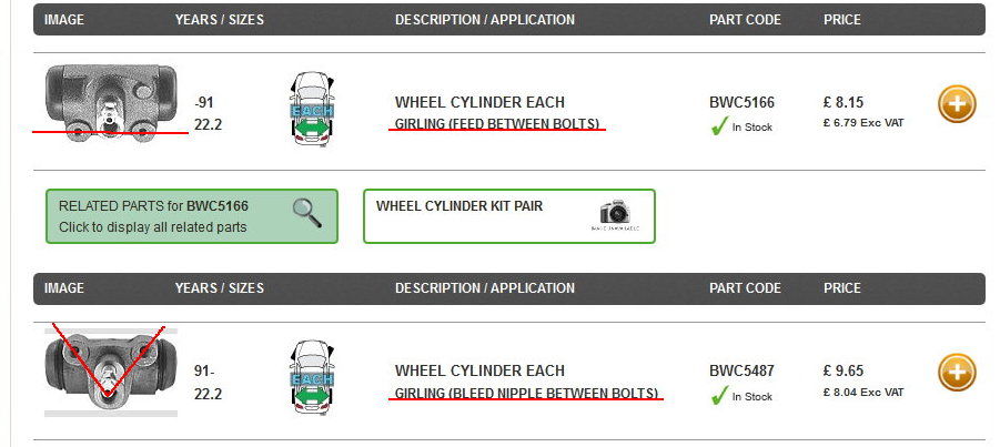

Brakesinternational site shows
The Samurai axel (if fitted) has a choice of 2 cylinders. So which of these 2 do you have.
As posted before.The Samurai axel (if fitted) has a choice of 2 cylinders. So which of these 2 do you have.
- SJ 413 samurai rear cylinder types 2.jpg (67.07 KiB) Viewed 5613 times

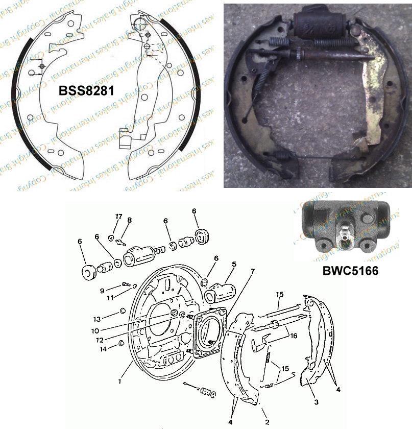

Im guessing that spanish sami shoes are an identical design to the 410 ones but just have the lever
There. So i cant see no real reason why they wont work. Thell just have an extra bit dangling on them.
