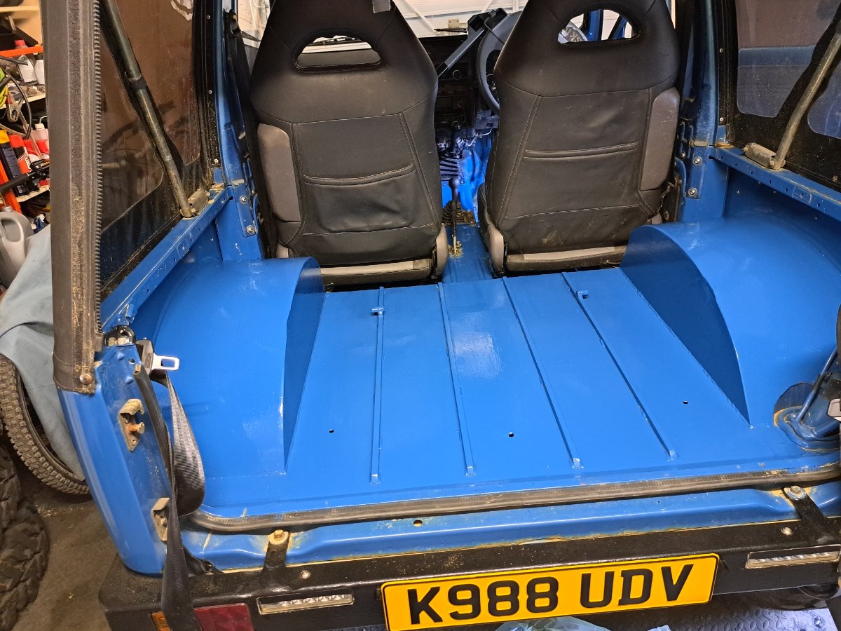

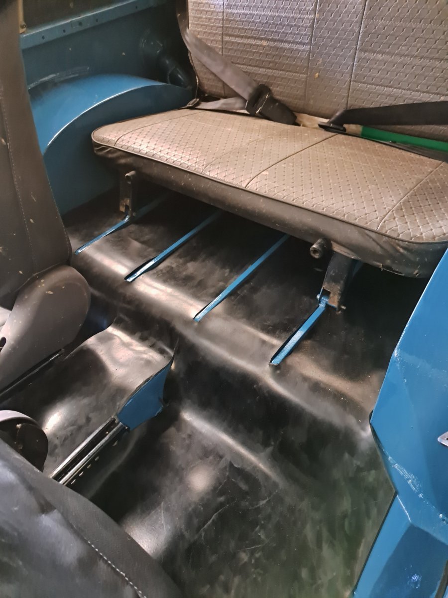

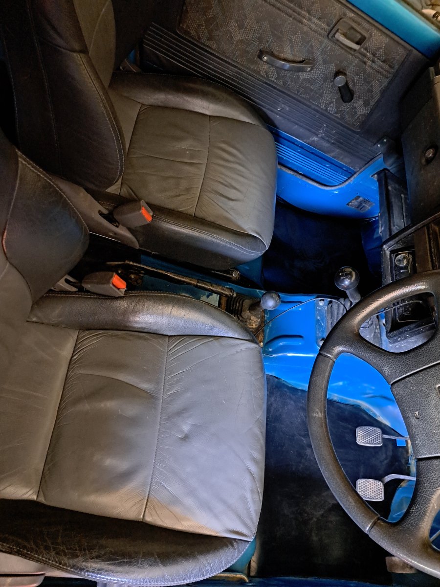

Post by d_r_1989 » Sat May 17, 2025 10:35 pm
Fresh lick of paint and cut some rubber mat to suit the floor and made some floor mats too. Try help keep noise down.
Posts: 369
Re: Coiled turqoise samurai 16v
Post by Rankine » Mon May 19, 2025 9:55 pm
Luxury motor vehicle
